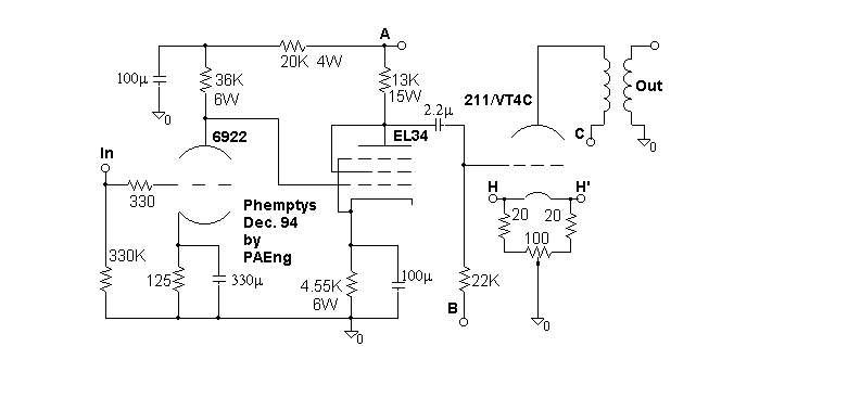

I was looking for schematic Tube 211 SE with EL34 driver but not found.
Anyone please help me

That's probably because it doesn't exist. Did you mean to say EL84 instead of EL34?
If you bias a 211 a little on the low side, a triode strapped EL84 with a CCS MIGHT have just enough gain to work.

A Pseudo-Hatarashi Single Ended Amplifier with 211I was looking for schematic Tube 211 SE with EL34 driver
do you have a good schematic?That's probably because it doesn't exist. Did you mean to say EL84 instead of EL34?
