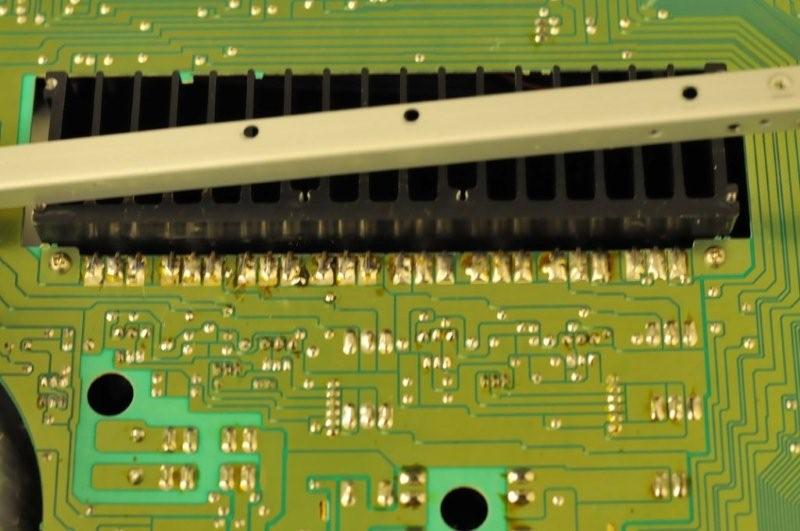

HELP! Rotel RA-1062
Another pic
One thing I would do is to disconnect the power supply, if it is possible... replace fuses and see if it can run witout anything connected... It would be a good time to measure some voltages.. a cheap multimeter will do... also google how to do a diode test on transistors...
Now for the part that will save you hours of head scratching, remove transistors one by one, do diode test, resolder if good, mark transistor as tested, do next one...
Contact Rotel Tech Support anywhere in the world by email with your model number and they will gladly send you a service manual in .PDF no charge!
They will even sell you whatever parts you can't find anywhere else!
They have excellent customer support!
Good luck!
Regards//Keith
I removed all the transistors and did a diode test and found one 2sc3902 and one 2sd1047 blown. I'm still waiting for the parts to arrive.

The parts arrive today, put the transistor and driver back in and powered it up! It turned on, everything is working and the fuse didn't blow. It's too late now, so I'll hook it back into my system tomorrow for further testing. I hope it will be ok.😉
