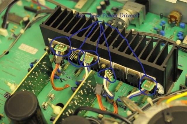

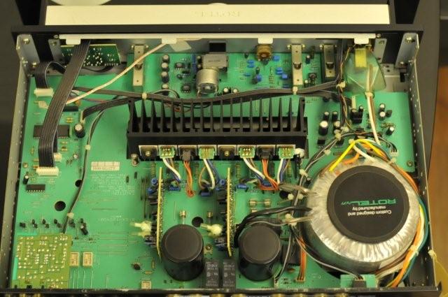

My Rotel RA-1062 stoped working and all the fuse blew. I took it in to Rotel service centre and they told me the Power Driver is the cause and they must be changed in pair. They also told me something else needs changing but I forget what it was and that had to be replaced in pairs as well. Since they wanted to charge me an arm and a leg, therefore I ended up buying a new amp.
Now as I have no used of the amp I want to rebuild it or at least getting it to work. If I get it working then I may do more mod on it. Please if anyone have this amp or know what I should replace please help me out. I circled a few parts, are those the power drivers? And where can I buy them? There are 3 pairs and have part number as follow:

Also do I need to change the 8 ic mounted on the heatsink? 4 of them are
D1047
E 3A4
and the other 4 are
B817
E 3A3
I did plenty of solding before, but I'm don't know much about amps. Please help!

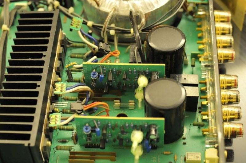

Thanks Bill,
I tried to find the service manual for a long time but all I can find is the owner's maual.
So would the two boards in the bottom picture be the Power Drivers?
As I remember the service guy told me I need to replace a pair of Matched Power Drivers and a pair of transistors.

Looking at your previous post, everything on the heatsink is just transistors. Just unsolder all of them and check them with a meter on the diode setting. If you dont know how to do that then you have some homework to do. Use Google searches for info, everything you need to know is out there.

Kchu by power driver they most probably mean final output transisistors which are the big 2sb817 and 2sd1047, it could also mean the drivers for these output transistors which are the smaller 2sa1507 and 2sc3902 but I ve never found a case where the drivers *2sa1507, 2sc3902 have blown and not the bigger transistors.
From your pic the blue transistors with the wires to heatsink you marked are called drivers and the big ones with the legs into pc board are alled output transistors.
If those drivers are blown, for sure the output transistors are blown too.
The repair shop is just using diffrent terminology to call the parts which is confusing.

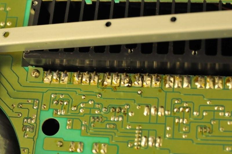

While waiting for the parts to arrive I took apart the amp and noticed the soldering of the transistors are quite bad. It might be shorted because of the solder or it might be the repair person didn't take the time to put my amp back together knowing I will not be repairing the amp.
