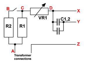

Since we're on the topic of TT motor, I'd like to request any further knowledge on the following from any guru here.
I've been experimenting and trying to understand the simple factory supplied Basik PSU to a Philips made MB10 type Linn LP12 motor(110VAC type). All the while it seems alright save a recent replacement of all the capacitors onboard for another lease of life. To describe the Basik supply, its simply Live in series with 0.22uF cap to blue and red wire direct to live for phase shift, the common grey wires are in series to another 0.22uf cap to neutral. Input is 230VAC/50Hz. AFAI recall, this is where I made voltage measurements with a DVM at the motor wire terminals. Common (grey) to Red = 100V, Common to Blue=90V
Meanwhile, I've learnt there's been different methods of wiring up this type of motor for various models of Rega or others, found different voltages at the motor terminals whatever the purpose and intent. I found the latest (or current) P3 Rega upgrade PSU have 75VAC at each phase with the same motor connected up, perhaps this accounted for the weaker spin up than Basik. Its noticed that the higher the voltage the better the starting torque naturally.
I've also found there's a voltage imbalance among the two phases when I started tweaking the Basik psu by adding a resistor in series to the live wire in attempting to obtain 85VAC at the motor terminal. When I measure the other phase there's a significant difference. Its like 85VAC on one phase and 99VAC on the other phase. Do I have to tweak the circuitry to get a near perfect phase voltage to work best? Is it vital for both phases of this type of motor to be best balanced for optimum performance?
Comments please. 🙂
Comments please. 🙂
P.S. I'm aware that a frequency driven PSU may be the ultimate or best solution for this type of motor but meanwhile I'd prefer to learn more about this simple psu type circuitry.

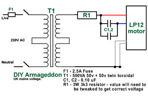

Transformer VA rating...
Hello Stew,
I am planning to use the airpax motor with an armageddon clone (Armageddon Clone). What should be the transformer rating required (Do we really need a 300/530 VA transformer ) for such a power supply ? Will a transformer with around 100VA or less work as the motor current consumption is small ?

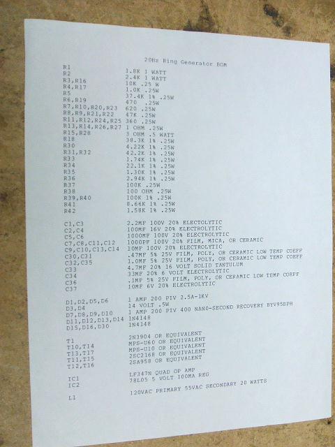

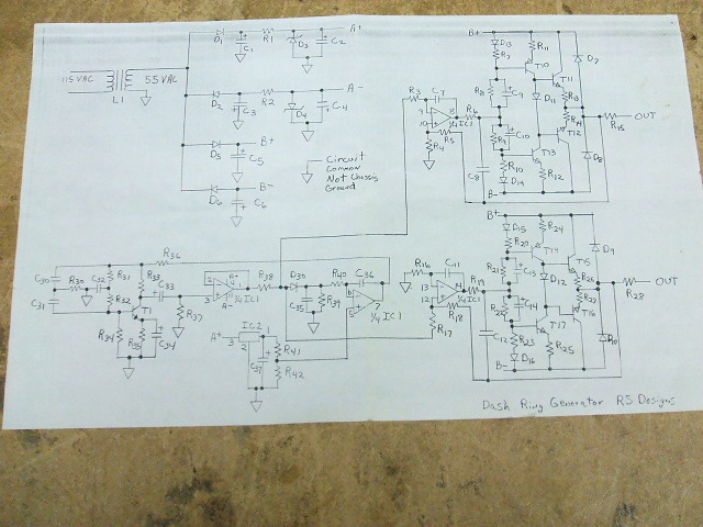

Regulated oscillator and two phase driver amplifier
T1 is the low distortion sine oscillator. Adjust C30 C31 C32 to maybe a 1/3 the value for 60Hz is what my bad memory says. This is 20Hz. Note the oscillator is regulated low distortion sine output. R4 and R17 set the gain of the linear amplifiers. Adjust these two to change the voltage output. Supplies are plus/minus 75 volts. The two outputs are 180 degrees out of phase with one another for driving a transformer or motor. This will drive a small motor just fine to 250ma. As I recall the output of each amp is 35 volts RMS so between the two amps is 70 volts RMS.
Any of these voltages and gains may be changed as you like. The amps are very stable and should work with supplies up to about ±95 volts with the parts shown.
The low voltage supply at C1 and C2 has a lot of ripple because a goal was to not make a lot of heat. Ripple there is like 40 volts peak to peak.
To make a two phase at 90 degrees output place a high pass capacitor set at 60 Hz (assuming 60Hz operation) before R3 and place a low pass set at 60Hz for C11 to R16 . R3 in the impedance there and R16 on the other channel. To start the motor use a capacitor and one amp just like normal and then move the switch to run and hook up the second phase directly. A two phase motor ( AC sync) will not start with a pair of 90 degree signals so a capacitor to start works well.
With this set up the motor cannot run at any speed except the sync speed (this is why it will not start) and will not hunt of vary speed under variable load as will happen with a capacitor used for the second phase.

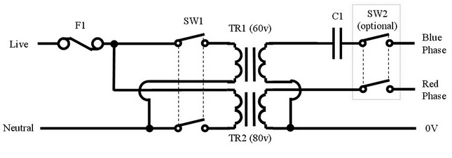

Another famous turntable power supply is available for DIY. Please check this out: http://www.norton-tech.co.uk/
The parts list is:
Best regards,
Bins.
The parts list is:
> TR1 60v transformer
> TR2 80v transformer
> C1 0.22uF capacitor
> F1 slow blow in-line fuse*
> SW1 DPST switch
> SW2 DPST switch (optional)
> 1 x 8-pin DIN chassis socket
> 1 x 9-pin DIN line plug
> 1 x enclosure
