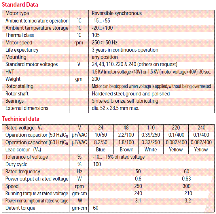

I am currently designing a belt driven turntable and the motor I am planning to use is an 24 pole AC sync motor running at 250 RPM on 50 Hz. The motor will be driving an acrylic-wood combination platter weighing around 4 Kg via a silk thread.
The motor specification sheet states that the detent torque value is 60 gm-cm and the running torque value is 240 gm-cm. It also states that the HVT value is 2.0 KV (motor voltage>40V) or 0.6 KV (motor voltage<40V) for 1 min. I would like to know whether this motor is OK or not.

I would expect very poor results with that motor, it seems to be a stepper. The very high ratio of detent torque to run torque corresponds to a torque ripple (AKA cogging) of 25% at max torque. At lower average torques the ripple will be even greater.

@ Mark: I think it is not a stepper motor. Can you explain me how you arrived at that statement ?

binspaul said:Mark: I think it is not a stepper motor. Can you explain me how you arrived at that statement ?
Detent Torque

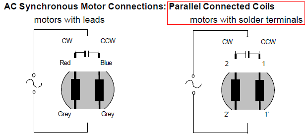

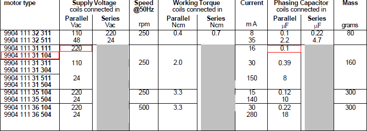

Hello,
I am having an AIRPAX AC Sync. motor (9904-111-31104) with me and I would like to use it for my custom turntable. It is stated in the first page of the manual that the motor works in the parallel mode (220 VAC using a 0.1uF phasing capacitor). The motor I am having is the one with solder terminals (totally 4).
Can someone help me in identifying the correct terminals and the right way to connect it ?

If your place have 50hz mains, use 0.22uF for phasing cap. If not mistaken 0.1uf is for 60hz mains (USA, Japan and others)
I think 0.22uF is for the 990411131813 model. Please see the attached image for the 990411131104 specification details (220V AC Supply). Also, How can we identify the correct terminals (The connections and the terminals are not clear in the 990411131104 specification sheet) ?
