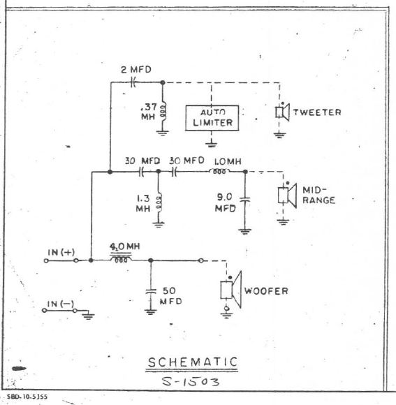

These old ladies are knocking on a bit now, and I was planning on replacing the crossovers with some new pre-built ones. It might come under "If it ain't broke..." but I think it is maybe starting to be broke, and I'd rather do it now than have em crap out when it counts. Some of the caps in here look a bit tired, and there is starting to be some cracking in the mids, which could be a sign perhaps??

In this case I would say :" If it ain't broken, don't brake it!". Sorry, but couldn't resist.
As the other response said: Change just the defective caps and check for bad soldering joints and oxidised contacts.
But don't change the x-over against another one with similar crossover frequencies that wasn't designed for exactly these drivers. Your box would still work, but the frequency response wouldn't be the same anymore.

IIRC from when I was in there upgrading the wiring, there was no value on the caps (unless it's in the glue, which it could be I suppose).
I don't really care if the frequecy response is exactly the same; it probably isn't going to sound the same anyway with a new crossover. Might sound better, might not. I'm checking these out for someone else who doesn't know what a frequency response is, and frankly he's becoming a royal pain. But, there are 4 of these boxes, so if I need to change one (which I think I do) I have to change em all.
All I'm really interested in is not blowing the mids (which are some kind of compressive cone driver is the best I can describe it; EV calls it a "vented midrange," which might have been revolutionary 35 years ago, and they just aren't around any more). In which case, would anyone second my notion that the Dayton crossover at 625 and 5K would work OK please? I realize 5K is higher than 4K, and of course there could be a hole there, but I can bump it up with the EQ if necessary. I would be surprised if a cone midrange would just drop out before 5K, wouldn't you?

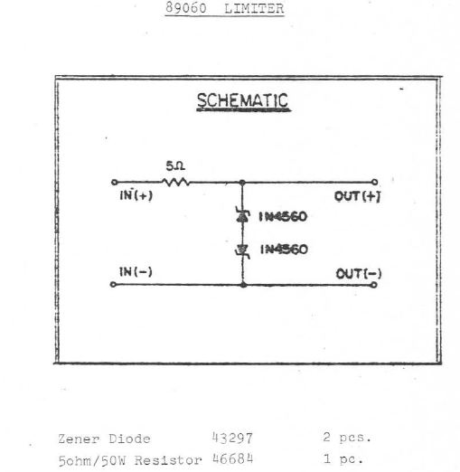

All the values are in the schematic in the EDS from EV... see attached. I agree with the previous posters, just replace the caps.
I've had plenty of these speakers and they sound pretty good - why mess it up?
