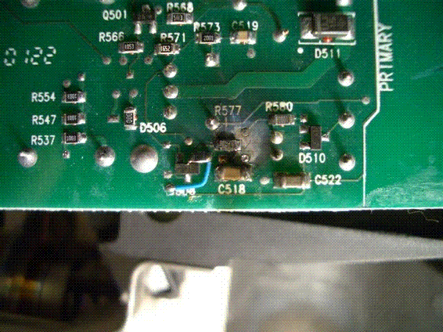

Repairing a LP530
Hi mbates14,
I have a LP530 with a failed supply. Looking over the board, it appears that C13 a 100UF 25v Capacitor is blown, and that U4 (ET1102 / 116UTK27) is also blown.
After reading over your post, you mention something about fixing failed supplies...
What is a good replacement part for the ET1102? Newark indicates that 04M9015 as a possible replacement? Any suggestions?
Fixing the power supply won't help me for an SP-LAMP-LP5F lamp if the power supply is not upgraded? How can you tell the difference between a normal and upgraded power supply? (I don't want to do the repair and see it blow again)
A further post indicates adjusting the PWR ADJ by one 8th of a turn? What's the direction? What should I meter and what power level am I looking for?
Or, is anyone selling a LP530 with a working upgraded power supply?
Your help and feedback would be much appreciated.
