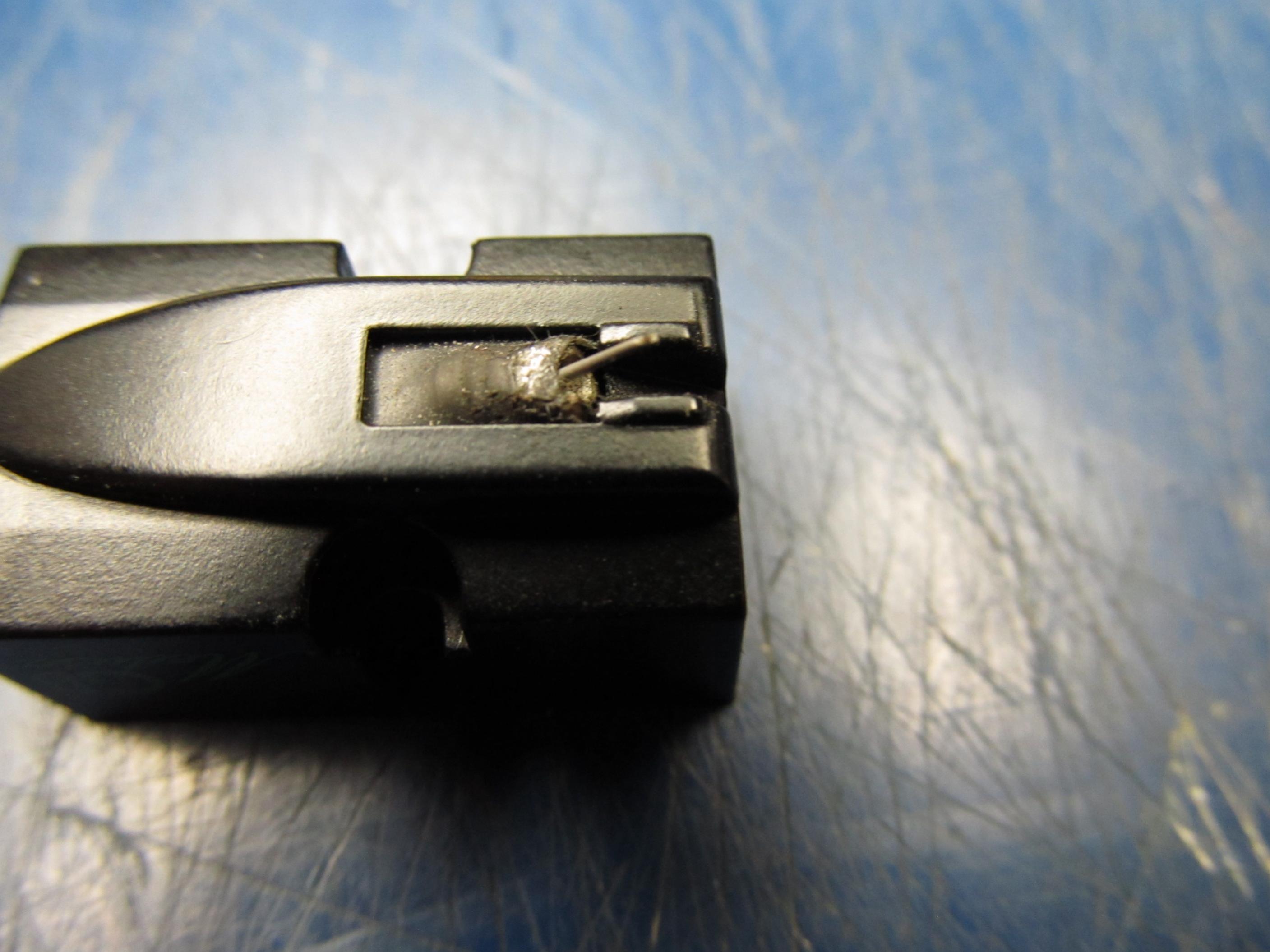

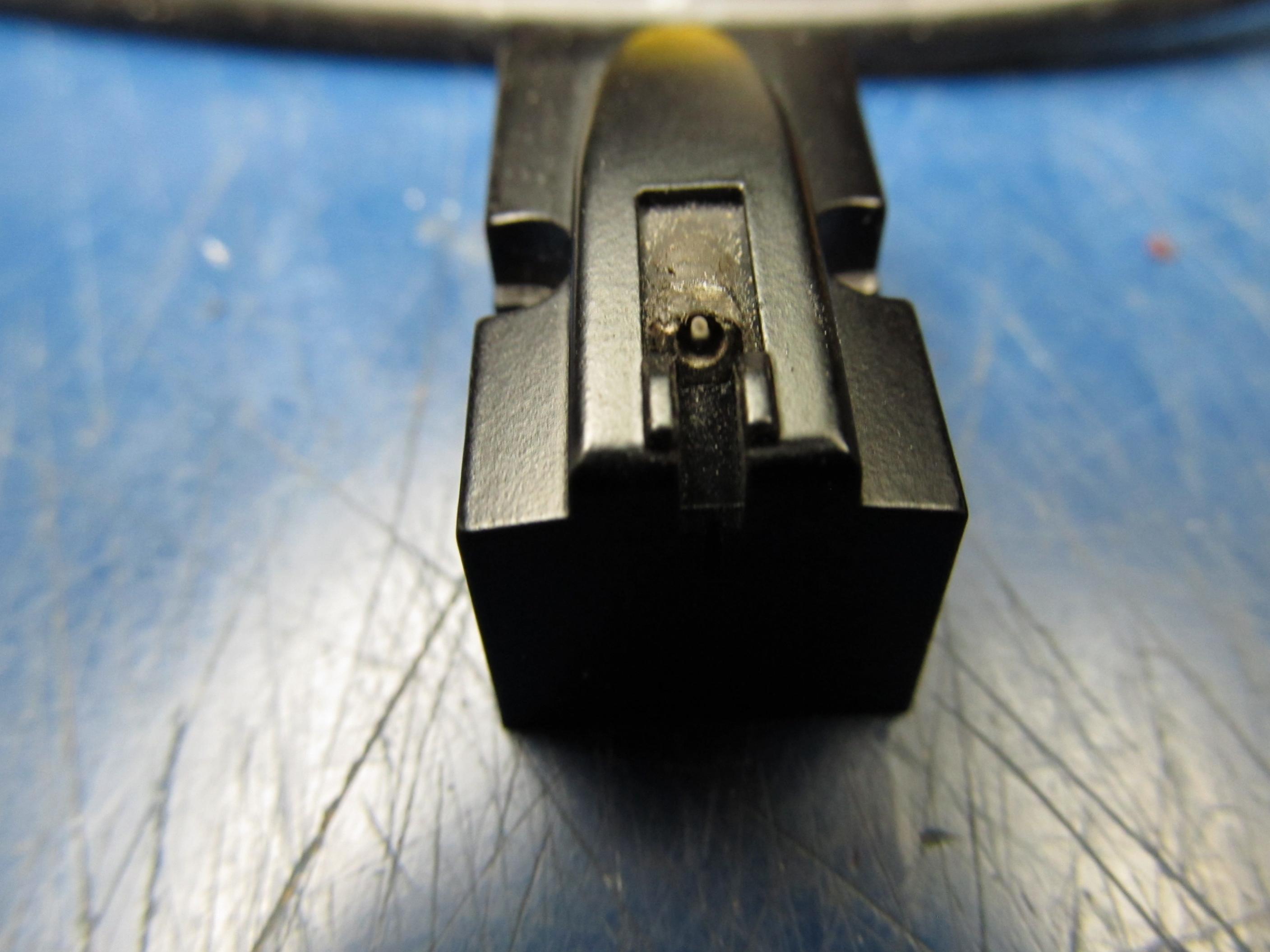

My Goldbug Medusa Cartridge needle is loose and around it is missing whatever support material was there. It was still working and I just now noticed missing material. The needle has a hole around it. I'm tempted to use glue but don't want to risk permanently damaging it if that is not the way to do it. I have a great microscope to rework it if anyone could instruct me how. I did google search & only got ads for retip services -no instructions for DIY.

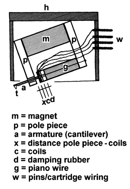

The tiny diamond needle is fixed in the cantilever tube by a process that you are unlikely able to do at home. Or perhaps the cantilever is loose? It is held in place by a pice of steel wire, and the coil assembly is supported by a piece of (usually round) rubber at its rear side. It is normal that the cantilever changes its angle vs the cartridge body when it is lifted down.

There should be a set screw near the middle of the body that forms the combined piano wire/coils , needle and shaft that is pulled back against the missing silicone donut.
How you would insert the donut is the problem without desoldering the microscopic wires is another issue.
I guess you could slice the donut and slide it in. The compliance is set by how tightly you pull the whole assembly back against the donut and tighten the set screw.
The type of silicone to use would be another issue.
A lot of factors to consider, but what do you have to loose at this point?

I asumed there was a problem because needle had moved slightly to the side & doesnt feel tight like the other needles I've seen. Is there supposed to be a gap around the needle inside the hole as opposed to something like silicone?

You mention it's slightly off center and this is quite common on many expensive MC,s as well.
The body is not important as far as alignment, only the moving cantilever since that's the business end
