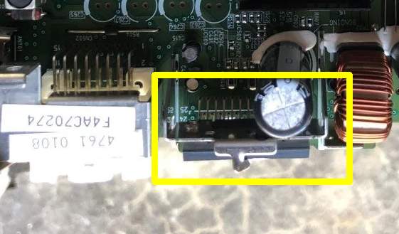

The Audio IC is likely the large one near the speaker terminals.

If you cannot read the numbers on the IC, do NOT try to pull it away from the clamp. It's likely to destroy the solder pads. IT's safer to remove the clamp.
If you can find the IC and believe it's defective, Reinstall the clamp. Then, using a razor knife, repeatedly cut/score the leads at the body of the IC until it falls off. Then remove the leads one at a time.
The laser pickup needs to be brand new in a sealed package. If it's not, dust may have gotten under the lens (where it can't be cleaned) and make the pickup useless.
Again. these were rarely drop-in replacements when I was working on head units. It could work but isn't likely to work.

Audio Chip seems to be TA8263BH but I will replace the transistors first as it is easier. Manage to find the transistors and new lens on ebay. Will order replace them and hope for the best!

Those three transistors won't fix your problem.
It will more than likely be the amp ic (TA8263BH)
Which suggests a possible short in that channels speaker or wiring.
It may be an intermittent short that you should try to find before it chews up another amp ic.
