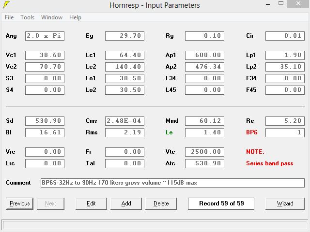

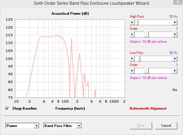

HI,
How could I minimizing out of band response as shown? I could not reducing no matter what I did. Thanks,😕

In real life the resonances will probably measure a bit less than the simulation. Shorter / smaller ports will move them up to higher frequencies, but reduce the power handling of the box. You can use XO / EQ to lower them by stopping the incoming signal from exciting them as well.
