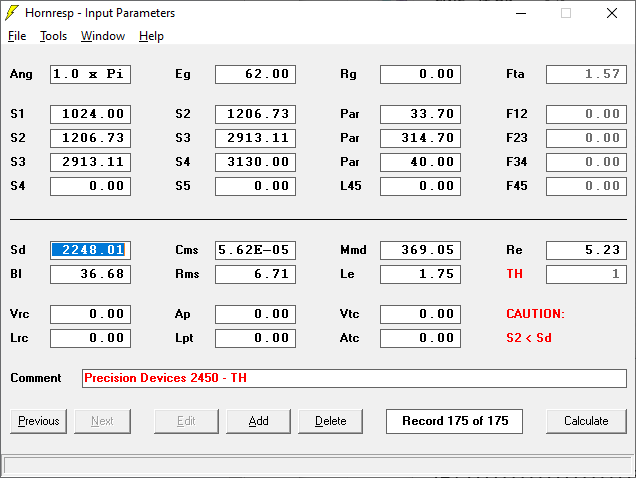

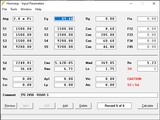

Hi!

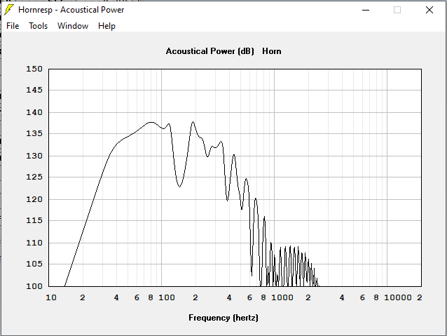

I have a pair of Precision Devices 2450, 24" speakers, which I´d like to build something else for than regular ported boxes. I have read quite a lot and experimented in hornresponse, but feel that I don't have enough experience too decide if i'm on the right track. I don't want to bulid something that doesn´t work.
On PD:s site they say that they should work in horns, but apparantly the BL isn't sufficient for example paraflex.

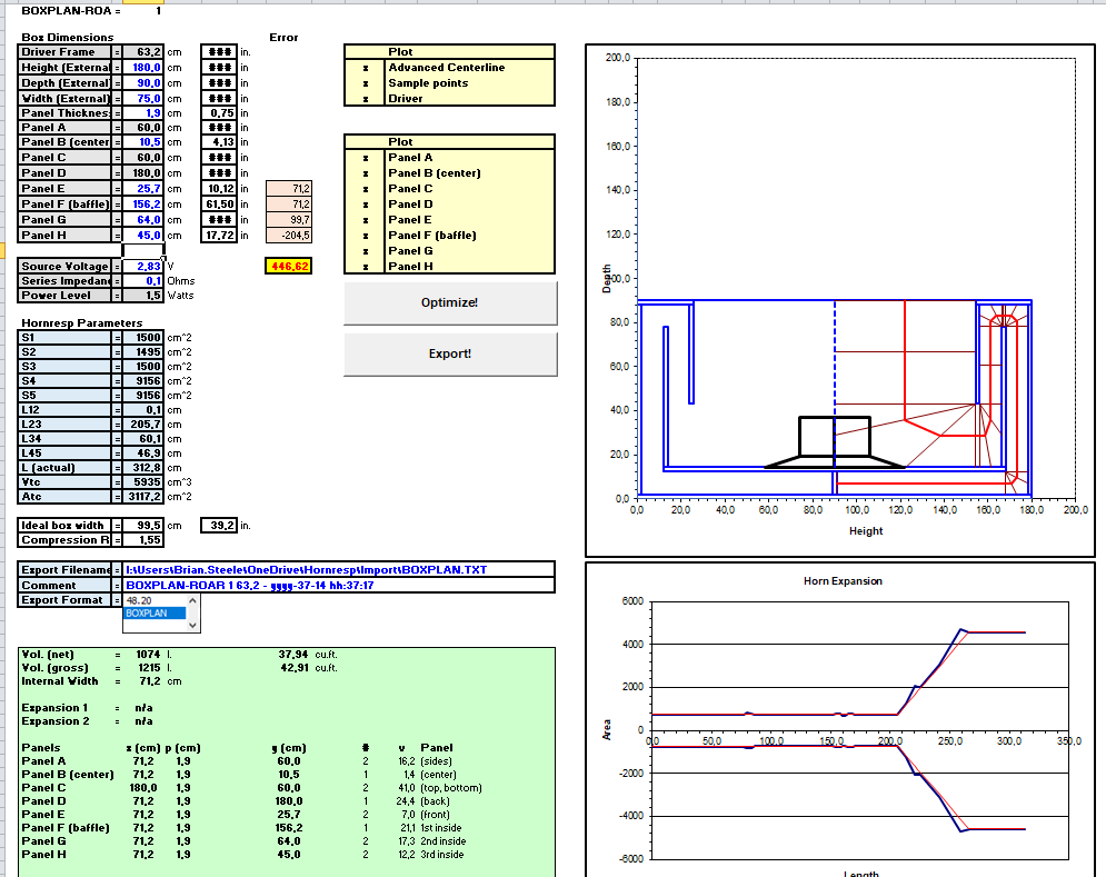

I´m curious about ROAR, Tapped Horn or 8th order bandpass solutions, but need some help to decide what would work. For ROAR and TH I have had some success getting a reasonable response curve, but 8th order bandpass is just a mess. I know there are a lot a very skilled builders here who propably could make it so much better.
Some things like phase response and group delay I don't have a clue how it works and would appreciate some info about that too.
If someone is interrested in helping me design boxes, I would like them to be no bigger than 185x80x90 Height, Widht, Depth, so I can get them through doors.

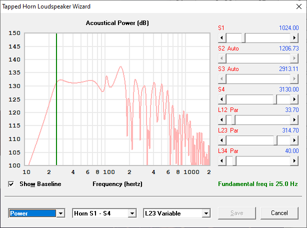

I'm attaching some pictures from boxplan and hornrespons so you can give me feedback.
The other part of the system will consist of 8 pcs 10", 4 pcs of 6,5 and a pair of horn tweeters. The PD 2450:s will have a Yamaha P7000s each, the 10":s a QSC PLX3402 and the 6,5 and tweeters a Pioneer SX1250. The equalisation and filtration is done by a Driverack PA2, except for the crossover between the 6,5:s and the tweeters.
I would appreciate any help I could get.

I would not torture that huge cone with the pressure typically seen in a ROAR, TH or TP.

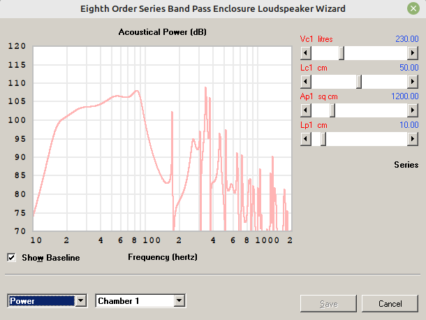

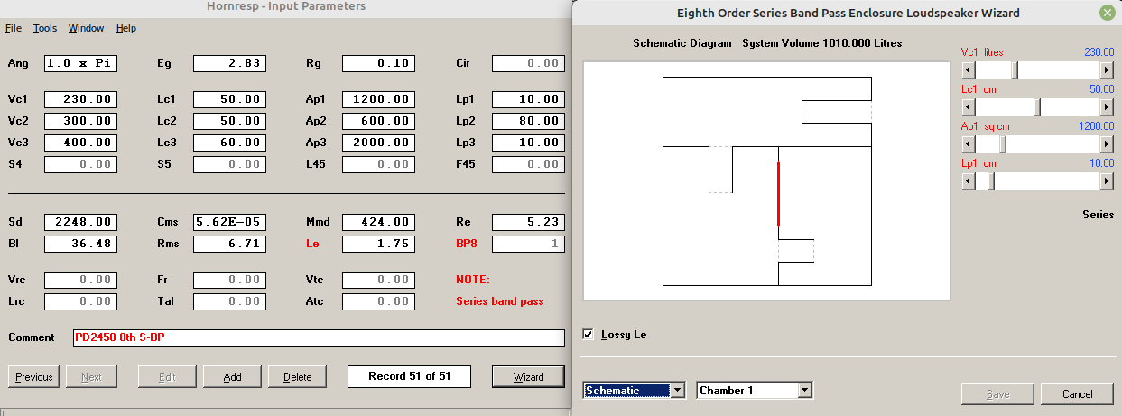

A 8th order series tuned bandpass with a sloping response to avoid the otherwise typical "slow" bottom-heavy sound character of a "flat" bandpass box. The mighty PD2450 seems to prefer a series-tuned BP alignment as this adds some much needed virtual Bl through acoustic positive feedback (more punch, attack and a smaller box).
I would probably build something like this and I would try hard to keep the ports and air volumes symmetrical around the driver to avoid any warping of the cone and/or suspensions due to uneven loading.

Interesting driver. Quoted Qts suggests that it might be a good match for a simple single-expansion TH like the BOXPLAN-MTH or BOXPLAN-MTHALT layouts given on my website, and the only question really is how low you wish to go. For example, here's a simple 25 Hz capable TH for one of those drivers that should fit well within your box size limitations. I used 1*PI space for the modeling because Circlomanen used that for his model, LOL. Usually I use 2*PI modeling to make it easier to compare with results from other modeling programs.
This should be considered only a starting point BTW, as the driver's semi-inductance parameters should be taken into consideration. Moving Fb up to 30 Hz will result in a smaller box or more output - take your pick. Don't forget to include the effect of the needed HP and LP filters on the overall response. And don't also forget that THs and BP boxes are typically limited to just over an octave of usable response, no matter what the frequency response curves tell you 🙂.

I thought ROAR was easier on the cone and needed less BL than paraflex. I also thought the cone got a more even load in a ROAR than a TH, an that would relive it a bit. But if you say it is a bad idea i guess it is.
Would there be any backsides with building a 8th order BP with chamber 1 and 2 in parallell, or at 6th order parallell BP if you could get a slope on the frequency response?

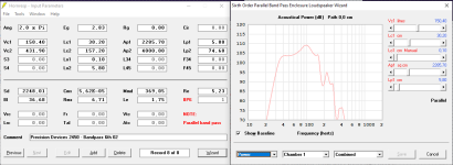

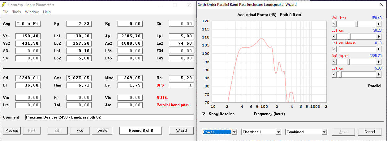

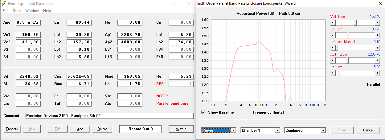

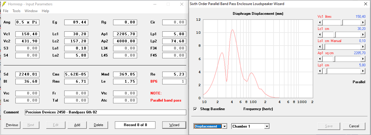

I made a simulation of a 6th order bandpass. do you think it will play ok or is it tuned to high if you look at the attached files? Is it buildable - i tried put the numbers in boxplan BOXPLAN-BP6P2 but couldn't figure out how to change to chambers. Some distances like Lc1 seemed to be in the wrong direction, but propably it is just me misunderstanding.
It would be appreciated if someone could tell me how to do.
The driver's semi-inductance parameters can be derived from its impedance curve (or better yet, using a ZMA file containing its impedance vs. frequency data). They're not usually quoted by the manufacturer.
An MTH or MTHALT layout would probably be the easiest build to do here. THs also have the advantage that at maximum power input into the coil there's maximum airflow over the driver, and the driver is not locked away inside a box where heat dissipation will happen more slowly.
No, a ROAR is a series tuned QW bandpass, and as such it has a lot of acoustic positive feedback. The pressure seen on the cone does get quite extreme at high power. It is a symmetrical design and this helps distribute the pressure much more even on the cone, which will help mitigate the potential problems with the extreme pressures to some degree. B&C 18IPAL and other extreme Bl,very low Qes,High Mms,strong cone drivers seems to work very well in the ROAR design with all the positive acoustic feedback.
A parallel 6th or 8th order BP does not behave quite the same way, since they lack much of the positive acoustic feedback (virtual increase in Bl). With the data on this driver I would prefer a series tuned alignment of some kind. But I guess it will work great in both series and parallel band pass designs.

Can someone give me feedback on the 6th order parallell BP i attached in the previous post?

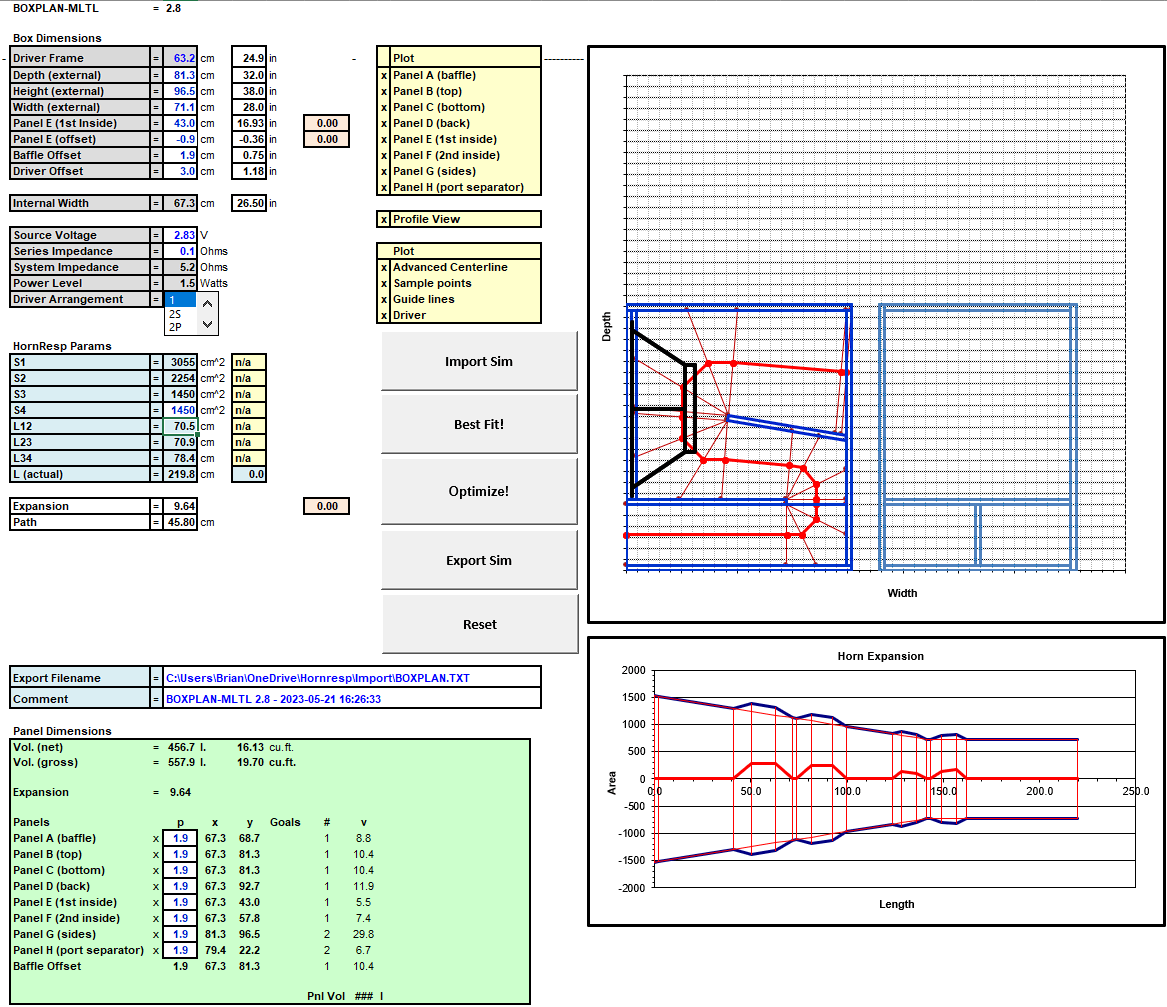

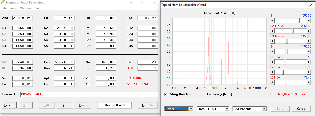

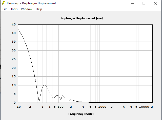

I tried to put the parameters for the MLTL in hornresp but I got at responce curve that looked very strange. Can you see, in the attached picture, what I put in wrong?

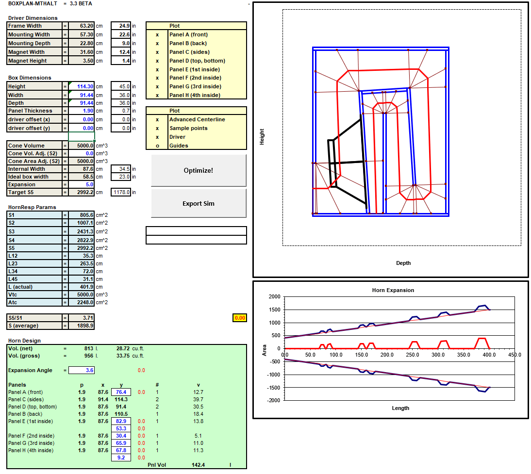

Also - the driver is kind of dull on the front side, but looks cool on the backside. You said that a MTHALT could be an alternative - do you have a suggestion for that?
I dont think that 96 cm height is a problem. I think my limit is somewhere at 180. I like the look of tall, slim speakers. The only thing I dont want is big speakers that doesn't deliver as big as they look.
I would prefer something that had the symetry of a Danley TH118XL, or slightly "longer".
Hello again!
Sorry for not responding but I've had a lot of other things going on.

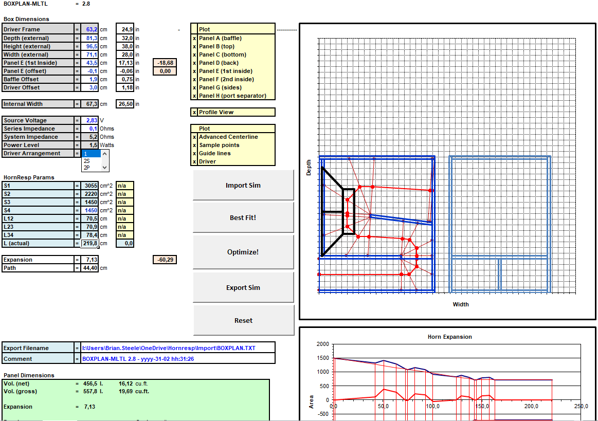

I have now tried too get the numbers right in boxplan, but with no succes.
The MLTL looks like yours Brian, but there was some sort of error when i tried to export it. So I still havent seen the frequency responce curve.
The MTHALT was a disaster. It seems like I have a different version then the one on the image so I couldn't do an exact copy.
