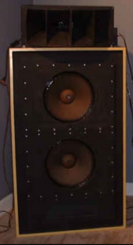

Greets!I was planning to fix the drivers to the front baffle using bolts with nylocks on, and then screw the baffle to the speaker cabinet. What is your opinion?
Also, where there are removable panels, even though they screw into the main cabinet, you still see internal battens. What is the purpose of these, is it to strengthen the cabinet, or to increase the surface area / create a seal to the front baffle.
I much prefer to make a solid cab and have removable baffles, especially when the drivers are quite heavy as mine are.
Here's one of a pair that were originally firing into the corners as wide range subwoofers, but if I needed to make them presentable I would make a Velcro attached flush fit framed cloth grill insert.
As for battens, mine are for making the cab extremely rigid, driver board framing and due to driver weight are 2x6 lumber top, bottom and 2x4 on the sides, crossbar, ditto back with basic box 3/4" no void marine grade plywood.

I'd suggest mounting the drivers with wood screws as Troels does - just follow his explanation of how he strengthens the holes. If you do that then you could simply bond your front baffle to inner battens of 25mm x 25mm strips of hardwood around the inner perimeter of your cabinets using construction adhesive. (I'll assume it's available in tubes from a building center like in N. America. It's a thick, pasty, urethane glue). You can clamp the baffle while the glue sets. Its advantage over a traditional PVA wood glue in this case is that it will seal any small gaps around the baffle. Use masking tape to protect finished surfaces though the adhesive will clean up with solvent while soft.

I think your right. I plan on using 24mm ply for the cabinet, so wood screws should be okay for the drivers. I could always glue small square blocks at the screw locations to increase the bite...
I'm now debating on the exact construction method.... I like speakers where cabinet forms a picture frame around the baffle. If I did this I would just put clear coat on the birch ply. But I also want to get away from what would still look like a massive ply box, so I'm leaning towards using an oak veneer, but I think this would be easier with the picture frame baffle arrangement.
