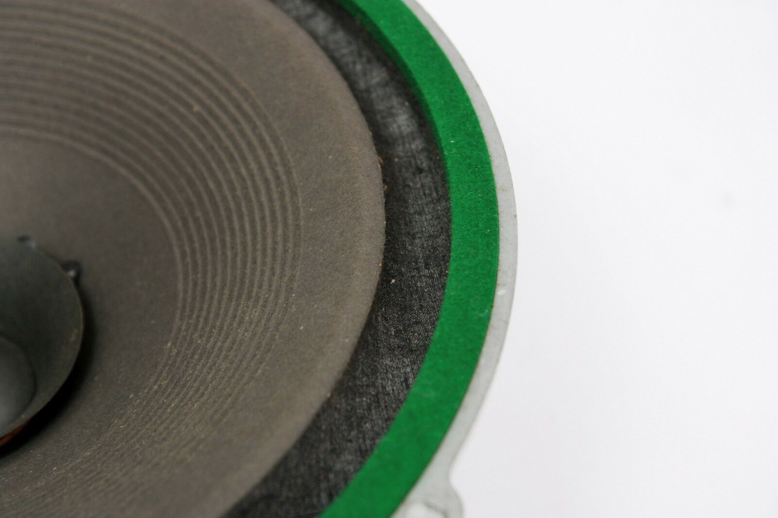

PS is anybody familiar with the open weave fabric surround? Seems like it isn’t an effective barrier between front and back, but there’s no sign that it was previously coated or doped or the like...
Yes, have you tried to blow/shoot air through them?
Regardless, I traced this product back to being Airflex's replacement for decades long toxic 5100 used on Altec, et al: Speaker Repair Adhesive, Sealer, Cloth Surrounds, Foam Surrunds, MI-1291

A wee word on Wharfedale roll surrounds:
The doped fabric roll surrounds of my RS/12/DD speakers were 'see-through' (as seen in the attachment) on the day I bought them over 50 years ago - and they look exactly the same today. I see no need to re-dope them as I don't consider them to be faulty.
