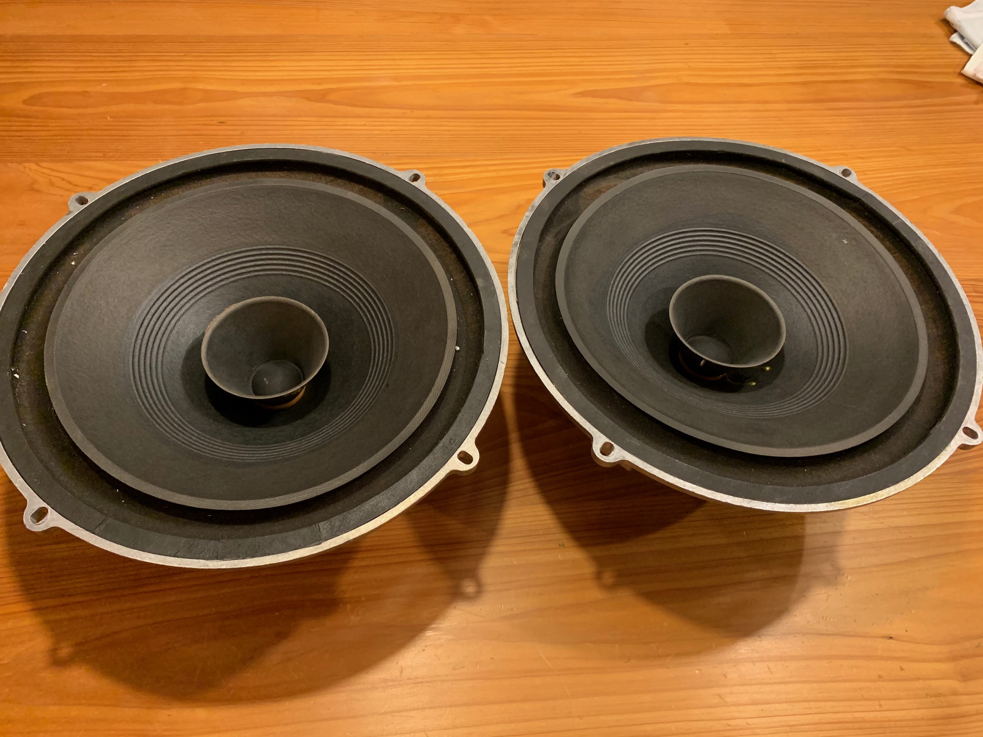

Most of the victims, I mean, fine salable guitar and hifi drivers, are easily identified, EXCEPT THESE TWO. I believe they were eBay finds at least a decade ago.

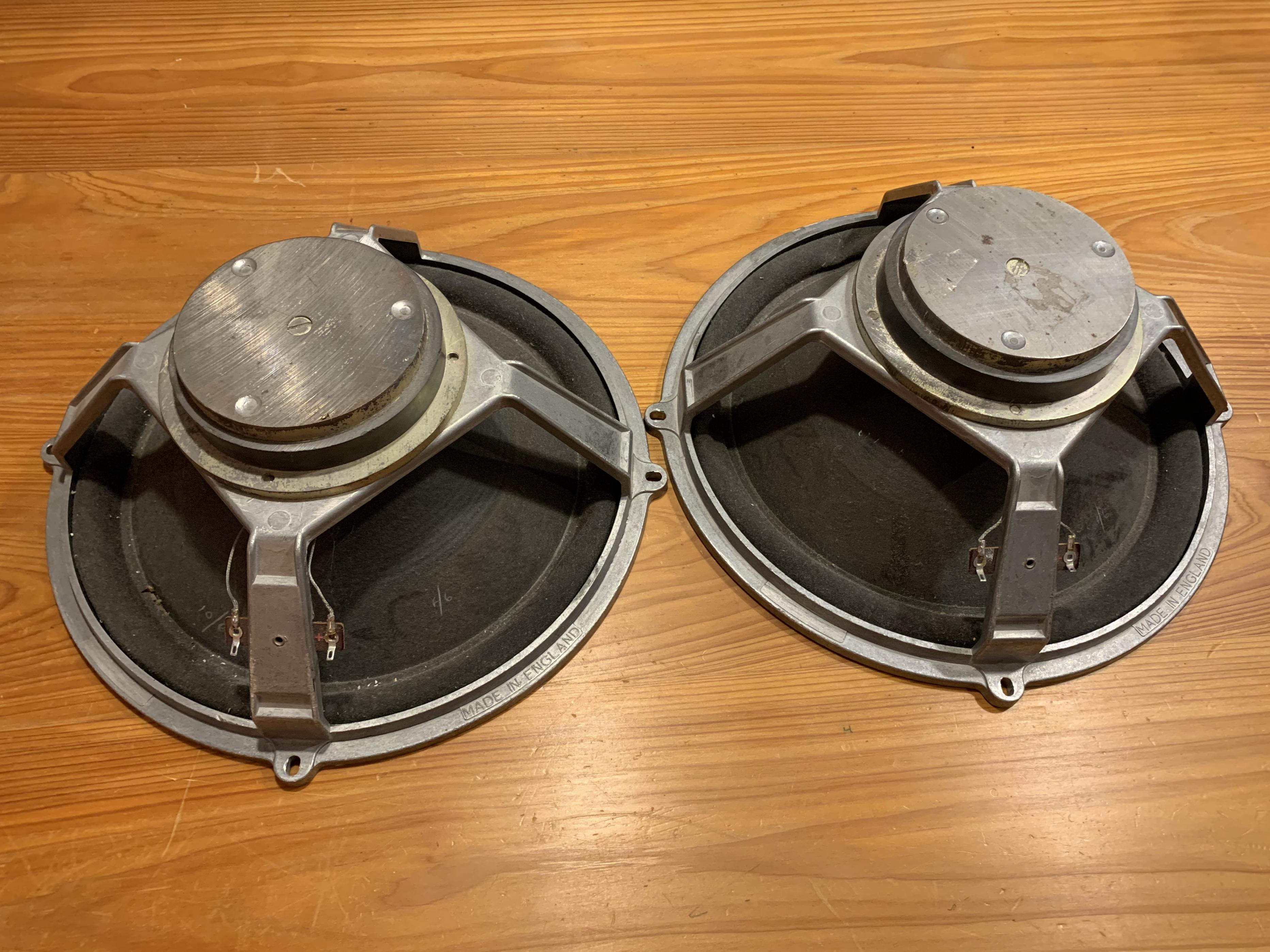

DCR is ~6.5 ohm, so likely 8 ohm. 12" nominal with semitransparent cloth surrounds. Slight voice coil rubbing, likely due to the creased surrounds canting the cones a bit. Heavy cast al-you-minium frames (I've had 7 British bosses if you could Australians; I can also say Poly-theene) marked Made in England.
No makers marks or serial numbers; those must have been on the missing magnet covers.
I BELIEVE that they are Wharfedale full range, but (a) which ones, and (b) are they worth having restored (likely a job for local speaker guy...)
In an open baffle they sound INCREDIBLY transparent and happy, so I'm leaning towards paying for restoration as the cones are unusually good.

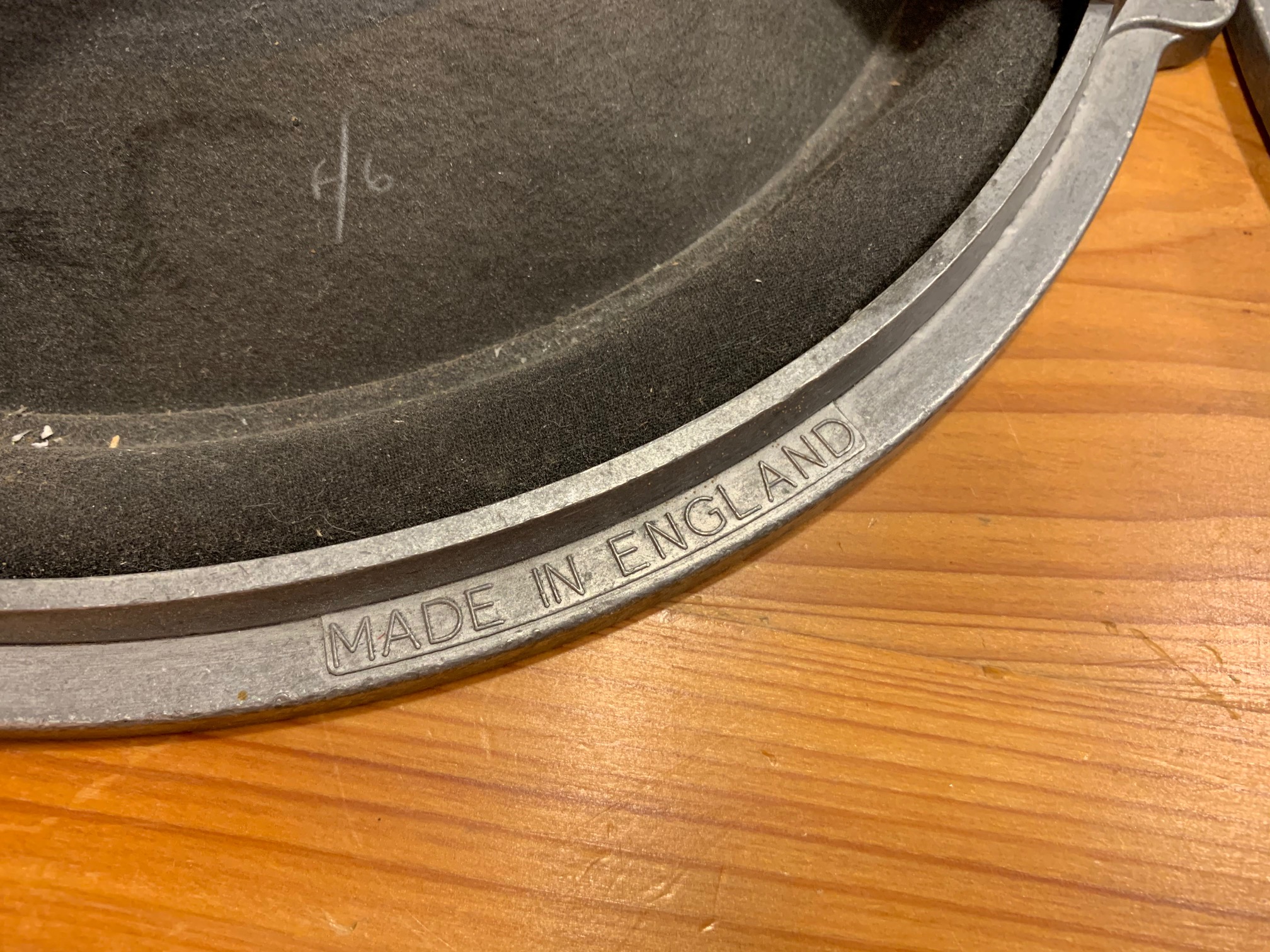

Definitely Wharfedale, as evidenced by the basket shape,' Made in England' legend and the distinctive roll surround.
I own Wharfedale RS12DD drivers which are similar, but not identical.

I see the problem, you are likely not experience any degradation in SQ unless you force the driver to extreme excursions.
From what I see from these pictures you don't need to do anything on these drivers unless you absolutely have to drive them below ~80Hz and if you don't play music very loud, you don't have to change anything anyway.

When mounted on a baffle, you may be able to rotate the driver to compensate for the cant and stop the slight voice coil rub.Slight voice coil rubbing, likely due to the creased surrounds canting the cones a bit.

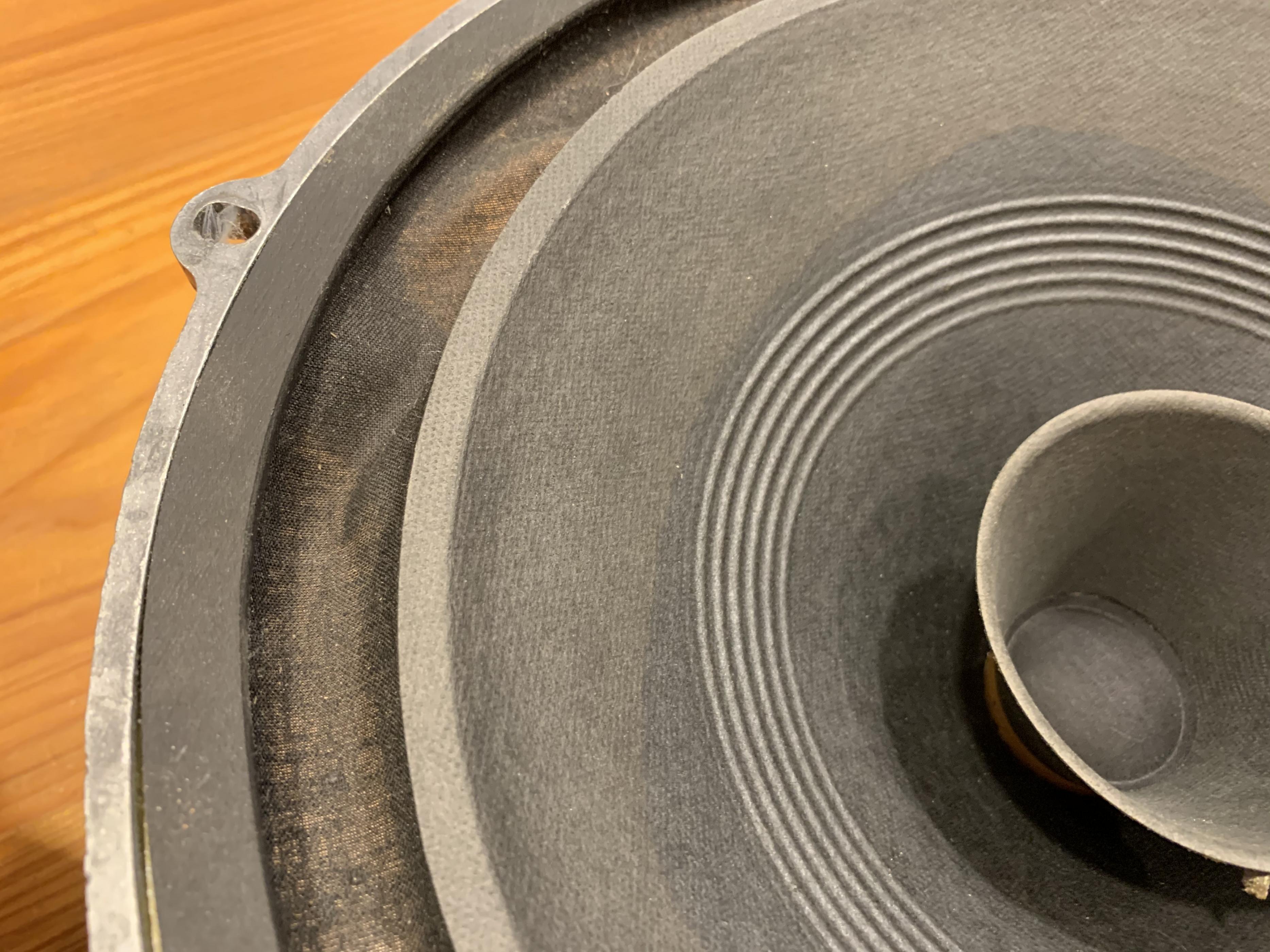

PS is anybody familiar with the open weave fabric surround? Seems like it isn’t an effective barrier between front and back, but there’s no sign that it was previously coated or doped or the like...

I looked carefully at your photo, and the similarities are greater than the (minor) differences.
The RS 12 DD has terminals mounted on a boss on one leg of the basket casting. That boss is present on my speakers, without the terminals of course. I think I have period-correct terminals from old HP equipment if I wanted to fake it...
They have different whizzer cones, but not THAT different.
The cloth surrounds are both concave channels, the major difference seems to be that mine are SHEIT. Can I say SHEIT? Too late...
The magnet size and aspect ratio is very similar, although the RS 12 DD still has a nice cover (although not the “shielding can” typical of Yank speakers.
I think these may be a US version of the RS 12 DD...
PS looked a pair of RS 12 DD on UK eBay, and the cloth surrounds ARE identical, albeit not the s-word.

The Wharfedale 12" speaker chassis or basket is a standard size so you will see that your driver has a smaller diameter ceramic magnet than the RS12DD.The magnet size and aspect ratio is very similar, although the RS 12 DD still has a nice cover (although not the “shielding can” typical of Yank speakers.
The RS12DD magnet does not have a magnet 'cover', what you see is the mild steel back plate of the magnet assembly.
No vintage UK Wharfedale Hi-Fi speakers had concealing magnet covers - what you saw is what you got! 😉

OK, so tabulating the deltas:
I know that Wharfedale made speaker "kits" once or twice in their history.
I wonder if these were "kit" speakers, USA only....
- magnet diameter is smaller
- whizzer cone appears to be marginally taller and narrower angle
- main cone has fewer "creases" (or whatever they are called); about HALF
- frame has the raised boss for terminals, but a Yank-style terminal strip instead
- "Wharfedale" NOT cast into the frame; I think this one is especially interesting & important. I should look to see if I can spot a mold insert where the name would normally be on the rim...

My RS12DD roll surrounds are 'see through' (as are the ones I've seen in photos), but that doesn't seem to affect their performance in my aperiodic enclosures which, by definition, are 'leaky' anyway!
Some owners prefer to apply sealant to these roll surrounds in order to ensure air tightness.
I would be very cautious with the process in regard to the type of sealent used.
This product has been recommended on this forum: Speaker Repair Latex Adhesive - Professional Grade for Surrounds Cones Dust Caps and more.
This latex adhesive should be thinned with water before brushing it sparingly onto the roll surround. This dries flexible and is a benign product which will not harm the structure of the roll surround unlike some volatile compounds which are often recommended.

No, NO indication of the maker anywhere. No “Wharfedale” cast into frame, no EIA numbers (I think EIA is right, it’s been a while), no nothing. I would say “speakers without a country” but that’s the ONLY thing they have.

The cones are CANTED due to the creases; in profile view, one side of the cone is proud of the front of the speaker; should have taken a photo, and I'm 200 miles away from the shop at the moment. I'm sure the voice coil is rubbing because of the canted cone.
I will try applying a little heat VERY SLOWLY to try to soften the "dope" (or whatever it is coating the fabric) and gradually reform the surround and hopefully urge the cone back into alignment. The front face of the speaker is a pretty good gauge, I think.
THe surrounds and cones are all intact, so if the outer face of the is aligned with the face of the frame, I'm hoping that the coil will be aligned properly.
What you are describing is very common. I usually turn it 180º on an open baffle and use a hair dryer to assist the process.
