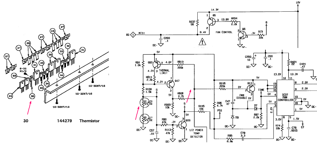

When I get a little more time I'm hopeful that I will get all the info I need from that manual which has a full schematic of the amp.

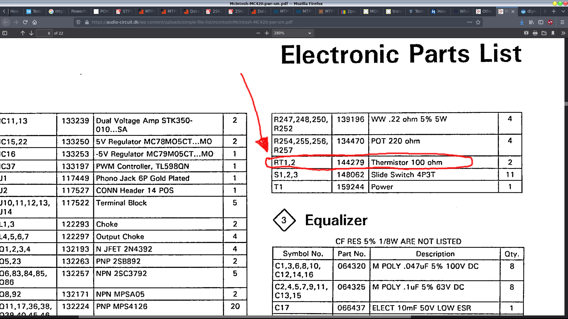

Here is the spec for that thermistor. (hoping the 4-channel uses the same part).
The part number is 144279 and the parts list from the service manual states it is a 100 ohm thermistor. parts list and specs.png

Thank you for analyzing this circuit for me. Unfortunately there are no fans in the MC425. Strange but I guess it is what it is. Like you stated, I'm sure that the logic senses hot and trips the shutdown to prevent a meltdown. At first glancing through this diagram myself I am seeing a lot of self protection circuits built into this thing. I'm kind of surprised I haven't heard of these amps before. Quality. I myself have been using Pheonix Gold for decades.
