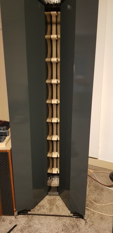

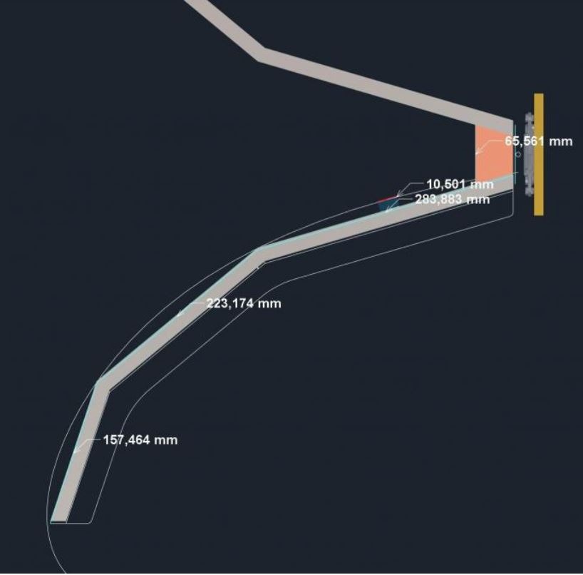

Hi Dean, Fast Prototyp is ready - using only 4 Planars. Sound is really Amazing- but needs some equalising. Let‘s See. Now I will order 8 Units and build a wood construction (Prototyp 2). My girl Friends is also very happy with the results- she is very tolerant.😊Hi Bernhard ,

For the sub I have built a H-Frame Sub with Goldwood GW-1858. Very low Performance - but not fast. Need a Slot Open baffle up to 350 Hz! The endless Story …
Sesame is the name of my speakers. The origin comes from a tale of One Thousand and One Nights in which "Open Sesame" is the magic formula to open the door to a cavern filled with treasure. That's the feeling you get when listening to your speakers. The orchestra plays in the room behind the speakers with a very high level of realism. The definition of these speakers is very high, it can be compared to the best current Hifi equipment. The people who gave an opinion on the French Forum use high-end equipment such as Quad 989 speakers. One person compares with these speakers, he writes I have a tractor and sesame, it's a Formula 1. of "Wilson Audio Sophia 1".

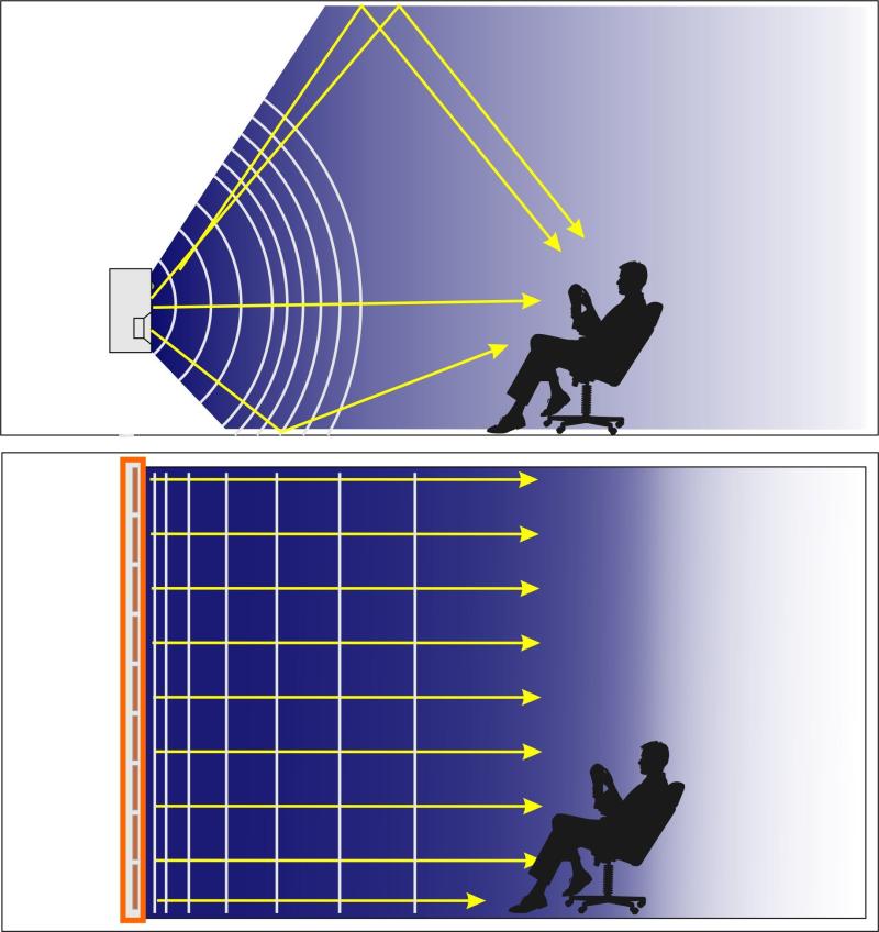

Sesame is not magic. The "Line Array" helps to suppress reflections from the listening room.
With a conventional loudspeaker, the acoustic radiation is spherical. Part of the waves are reflected by the floor and the ceiling. The listener hears the sound of the speaker added to the reflections. The red curve is the original signal, emitted by the loudspeaker. The blue curve is a reflection by the ground, it arrives with a slight delay. The green curve is the signal heard by the listener. It is the addition of the two curves. The phase and amplitude of the original signal are not respected.
With the "Line Array" the waves are parallel to the floor and the ceiling. There are no reflections. The signal is not polluted by the room. When listening, the music is more detailed and the dynamics are better, as with headphones. The ear and the brain keep only the first sound received. On live recordings, we hear the acoustics of the concert hall, not the acoustics of the listening room.
To have the "Line Array" effect, the enclosure must measure at least 70% of the ceiling height. At home the ceiling is 2.5 m and Sesame is 1.8 m and for that I use eight Neo8s.

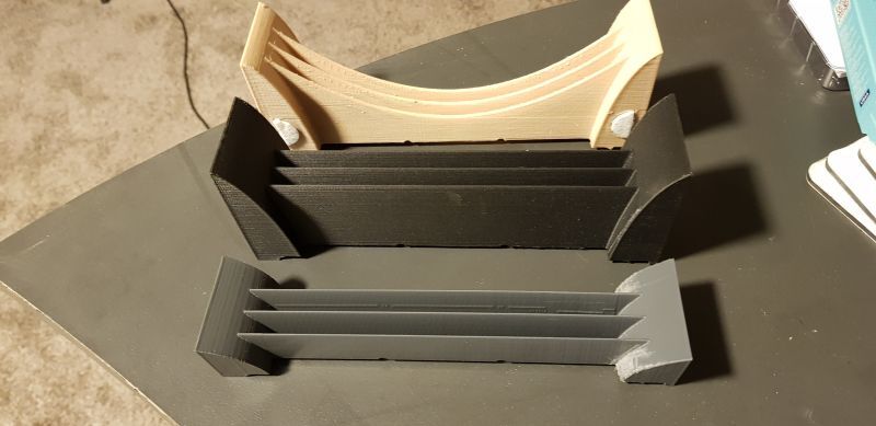

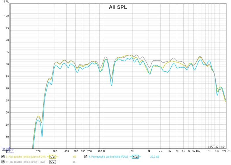

For the use of acoustic lenses, I still have tests to do with a new shape. These lenses were created to fill the gap between two Neo8s and more smoothly adapt the Neo8's planar radiation to the horn. With Sesame there are no comb filtering problems found with "Line Array" composed of multiple small speakers. The small cones have a spherical radiation and the high frequencies are localized in the center of the cone. This causes interference between them. The Neo8 has an elongated shape suitable for in-line mounting, the wave is flat and all frequencies are reproduced by the entire surface.
The lenses give a gain of 1 or 2 dB, but the high cutoff frequency is a little worse. Listening, I find that there is a little more precision. The lenses are made with a Creality Ender-3 3D printer at €180. I will put the plans (STL) online if anyone is interested.
Gray gray lenses. Yellow yellow lentils. Blue without lenses.

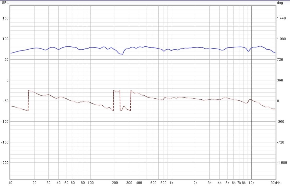

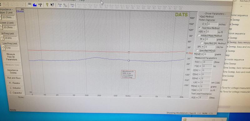

The impedance of these speakers is flat, the phase too, the resonance is very well damped. The impedance of each panel is 13 ohms. A turbulent impedance curve hurts many amps. Here no problem for the 2A3 on 8 ohm, but with a loss of power. But I use 3K output transformers for 300B. It's easier to find than good transformers for 2A3. and the possibility of using output transformers for 300B on 16 ohm. The impedance seen by the amplifier is 2.4 K.

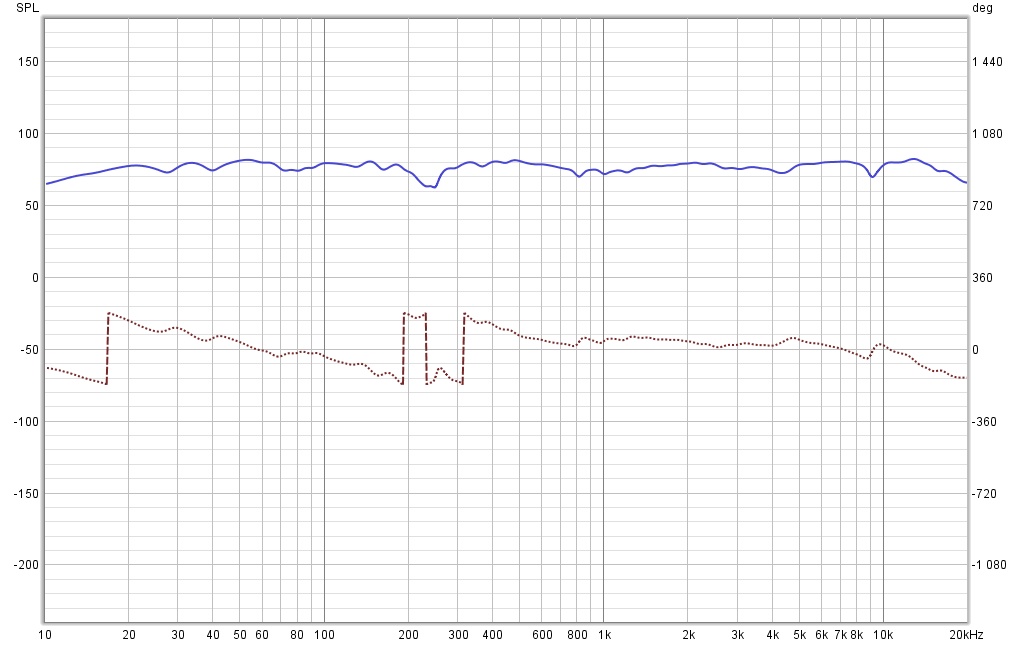

Hi Sap2212,
Thank you for your reply.
Yes, the vénérable 2AE. I have a Chinese single ended 829B amplifier and am building a 6V6 from scratch. One day maybe I will build a 2AE amplifier.

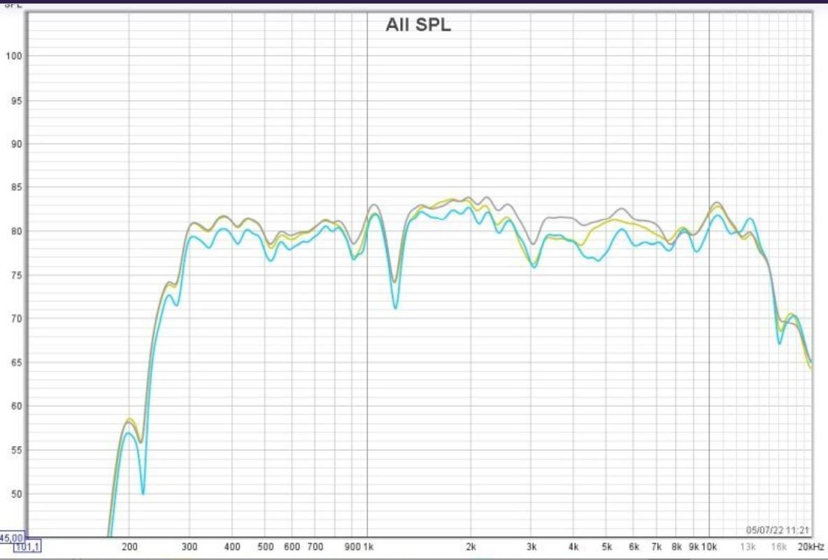

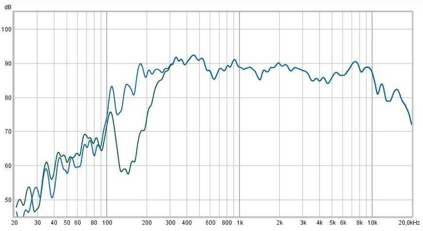

May I ask if the horn that yielded the response curve seen in post #2 had the same width of mouth as the horn that yielded the response curves seen in posts #27 and #30?
I ask because the response curve in post #2 is down 3dB at about 10.5KHz, while, in contrast, the response curve in post #27 extends to about 14KHz (-3dB) and in post #30 to about 16.5KHz (-3dB).
From POst #2
From Post #27
From Post #30
If the horn mouth/overall shape did not change, then are we to conclude that the differences in recorded treble extension are due to the acoustic lenses in #27 and digital filtering as well as the lenses in #30?

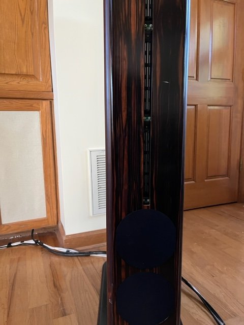

This is a little off subject but I have old VMPS speakers using similar neo8 drivers (3) and a Constant Directivity Wave Guide that I have heard is a disaster - I am thinking of improving them with a better wave guide and DSP.
Any suggestions?

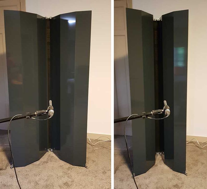

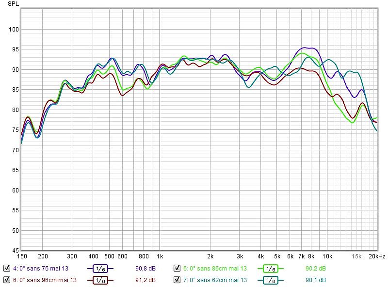

@ Ben
We cannot make a comparison on the curves.
Curve #2 is that of the prototype. It has an opening of 80 cm and the material is Wedi® #10. This material is absorbent at high frequencies.
The walls of the final horn are adjustable in opening.
They are made of Dibond® (aluminum / polyethylene / aluminum) which is more favorable to high frequencies.
A comparison measurement 75 cm, 85 cm, 96 cm and 62 cm in blue.
Acoustic lenses are useless. I was afraid of creating a problem by leaving the gaps between the Neo8s empty. On measurements and listening, there is no significant difference. I left the parts in place, as they give rigidity.
I am very satisfied with listening to this Horned Array. I had beautiful horn or electrostatic speakers, but I realize with hindsight that it is often the amplifier that limited the quality of the speakers, but also of the source. Every time I upgrade my 2A3, I find that the DAC is better.
Here a link to a French forum, with opinions from people who have listened. http://forum-hifi.fr/thread-23663.html On page 7 someone says his speakers are a tractor compared to a Formula 1. He has Wilson Audio Sophia 1 speakers.
The most characteristic of the sound of the Horned Array is the sound image.
I am attaching a REW measurement file. The measurement is made with 2A3 amps, this is why the H2 distortion is a bit high. I lowered the Dirac corrections to limit this, but the H2 is not perceived as unpleasant.
There is a mirror effect which enlarges the length of the Line Array. https://audioroundtable.com/misc/nflawp.pdf
The plane wave and spherical wave mix cannot work correctly, the attenuations are not the same. The speakers are good individually, but not together.

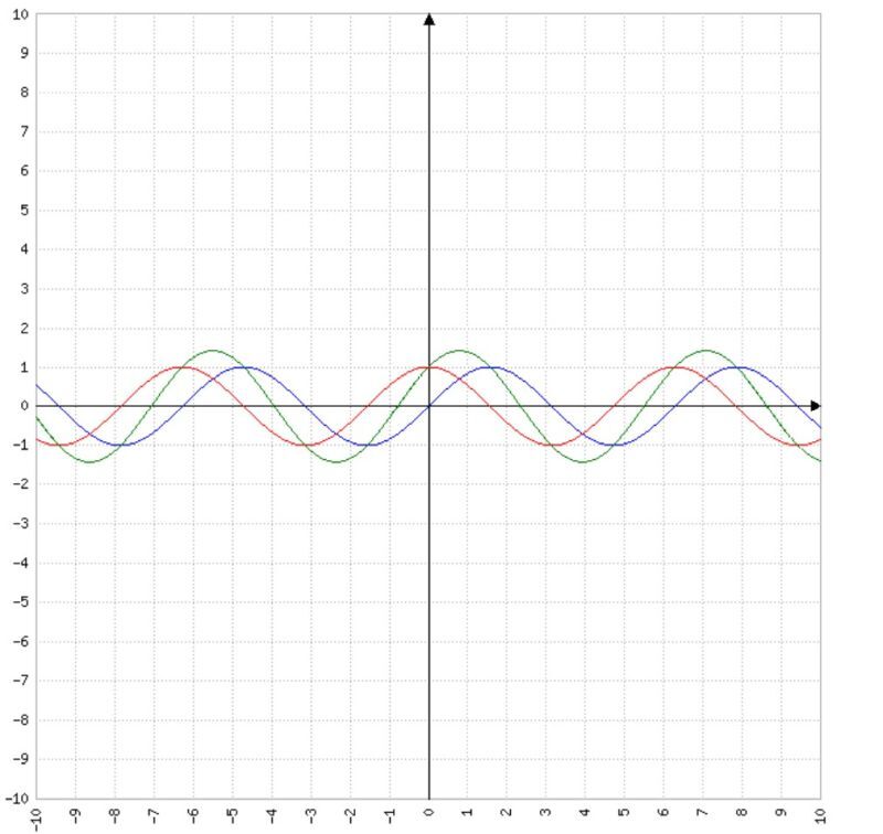

With Regard to he shape of the horn in post 18, is that the final shape you used with the 63 cm mouth? Is that horn shape a known curve such as Oblate Spheroid, Exponential, or Tractrix e.t.c.?
Also, may I ask how close you were able to get the horn to the outside holes in the PT6825? It seems there are little ridges that would prevent getting right up to the edge of said holes.

The curve is not a mathematical curve. I created it by testing and measuring with panels glued with adhesive tape. The mouth is 63 cm. We could certainly improve the horn with a more regular profile. The broken curves seem to cause disturbances as can be seen on this forum.
https://www.diy-hifi-forum.eu/forum...oder-Constant-Directivity-wie-geht-das/page37
It has notches on the lenses so it won't touch the Neo8s. The horn and the support panel of the Neo8 are two separate parts. They don't touch each other. It is very important not to transmit the vibrations. The space between the two is about 3 mm.
At the bottom each rests on the ground with an axis to fix the spacing and the opening of the horn. At the top, a hinge is the only contact.
