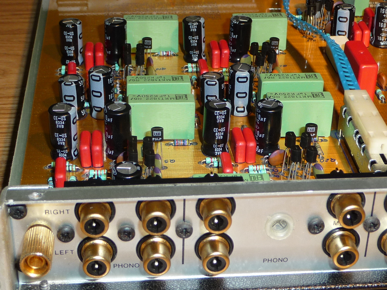

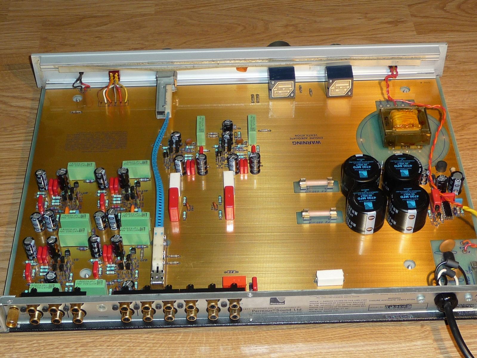

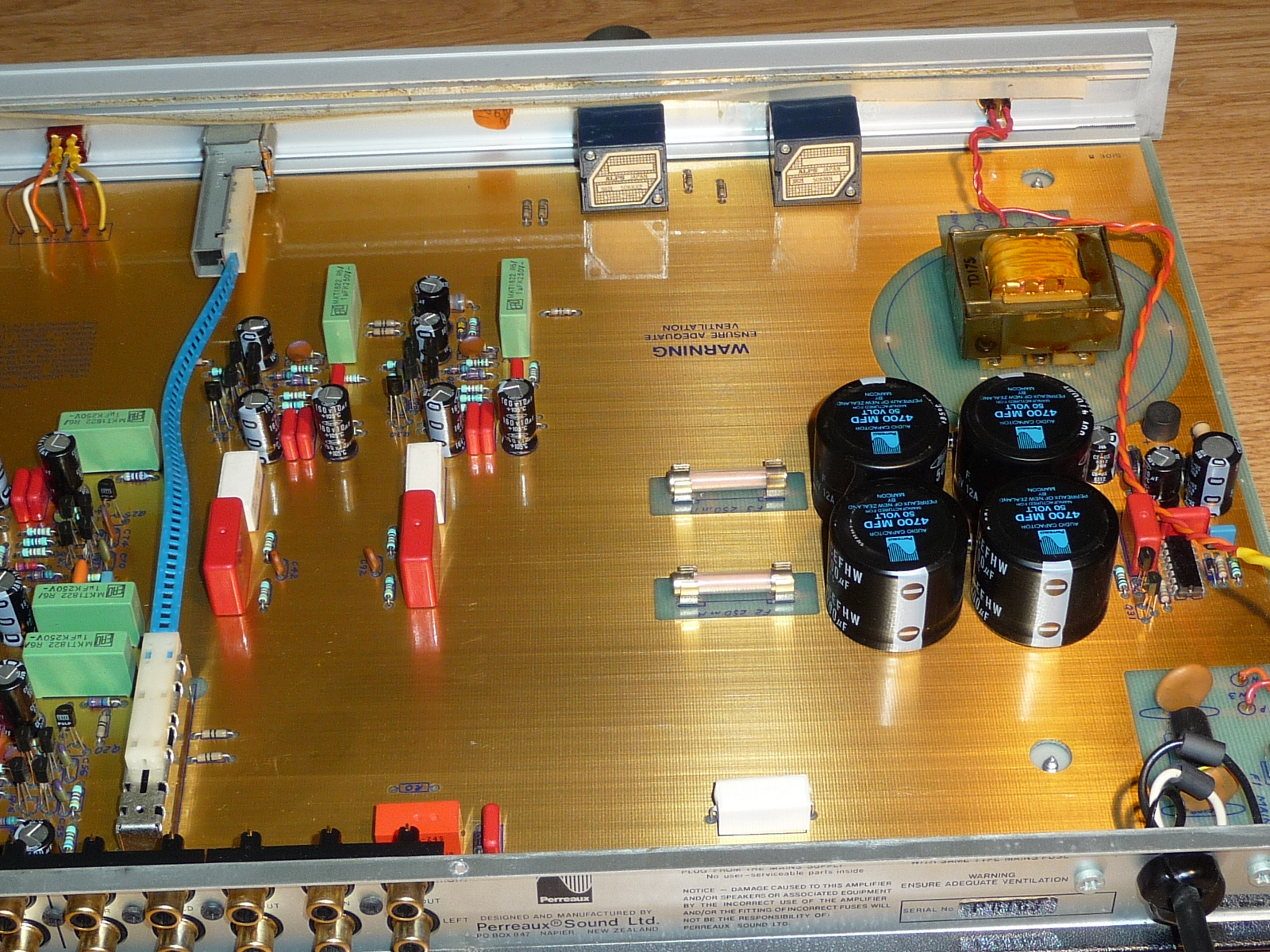

Photo of inside. Should I replace the Marcon electrolytic caps shown (14) on left side (7) in center (3) on right side? Any transistors, resistors, ect. need replacing?

I wouldn't replace anything. I'd swap semiconductors between
channels in the phono stage to see if the right channel problem
moves to the left, a schematic would be a great help.
Changing passive parts won't fix the intrinsic noise issue.
