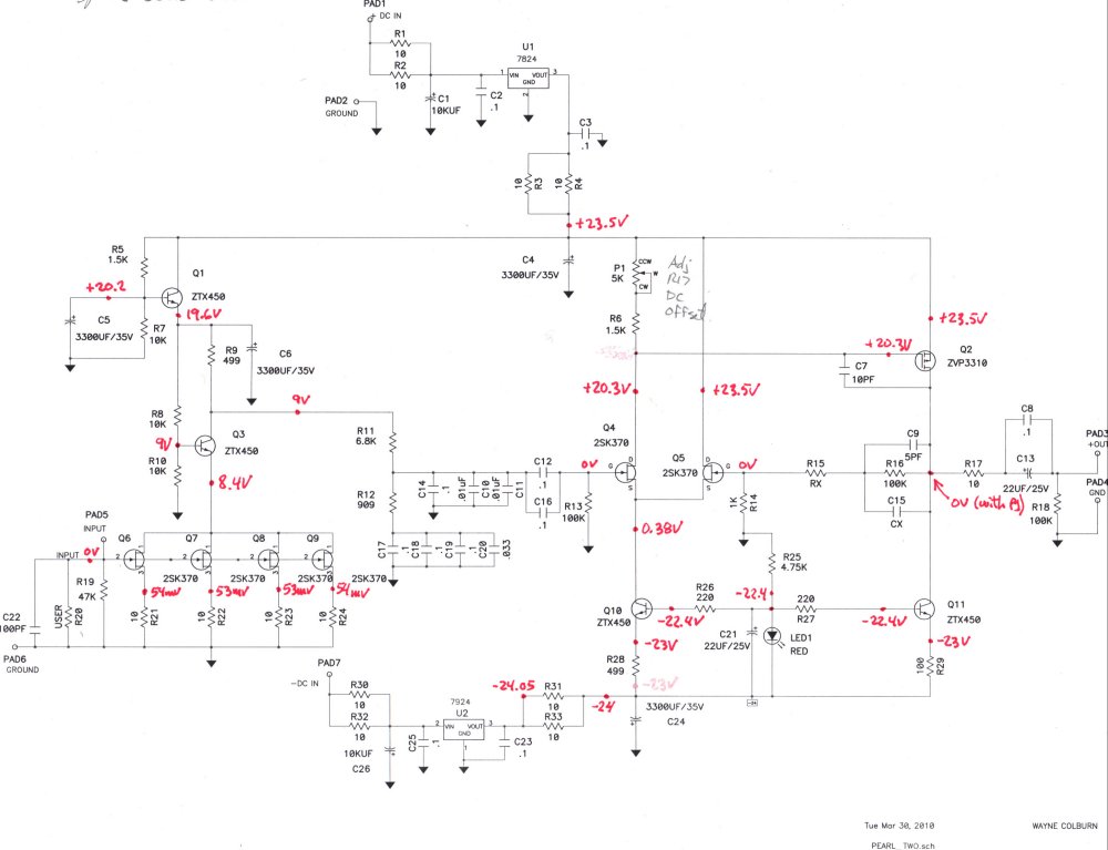

I received the Pearl and have started the diagnosis. I found a problem, but not the cause, yet. Measuring the voltage at Q4 I get 0.8 V on both channels. Much lower than the expected 13.8 V.
The voltages elsewhere aren't perfect, but are closer to correct. Both channels measure almost exactly the same, so I'm reporting only one:
1) The 30V transformer is putting out 37 V AC, which is high. This may be because Plitron specs 115V input, but I'm a little surprised.
2) The power supply is consequently putting out 48 V DC. This is also high, but expected given the higher than expected AC.
3) The drop across R2 is 0.3 V (should be 0.25 V)
4) Voltage at R8 is 28.5 V (should be 29V)
5) Voltage at Q3 is 24 V (should be 24.6)
6) Voltage at Q5 is 10.9 V (should be 11.7)
A few more relevant details. I build the Pearl about 15 years ago and used it extensively for 10 years in my main system with a Rega Super Elys high output cartridge. I'm enough of a perfectionist that I wouldn't have let it leave the bench if it didn't measure correctly. I never had a problem until I replaced my amp with an NAD d3020. Immediately the volume on the turntable was too low, which I assumed was due to the amp. It now appears something went wrong with the Pearl concurrent with the amp switch. It's mysterious to me how both channels failed in the same way at the same time.
But because it used to work I'm assuming a component failure. I don't see any obvious scorching, blown resistors, smoke, leaking caps, etc. And it still plays, just super low volume. I'll keep investigating and posting.

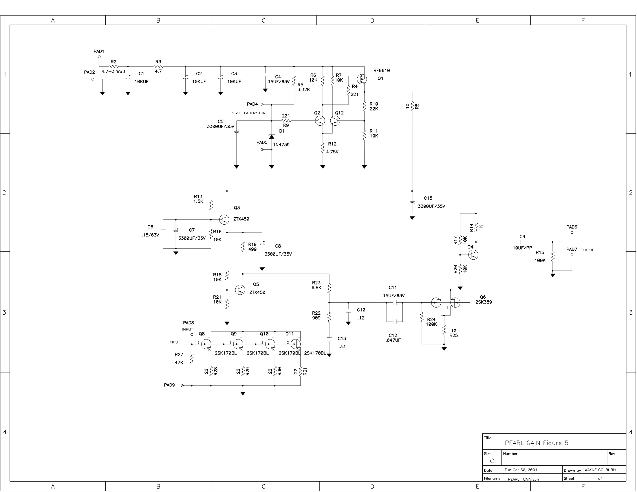

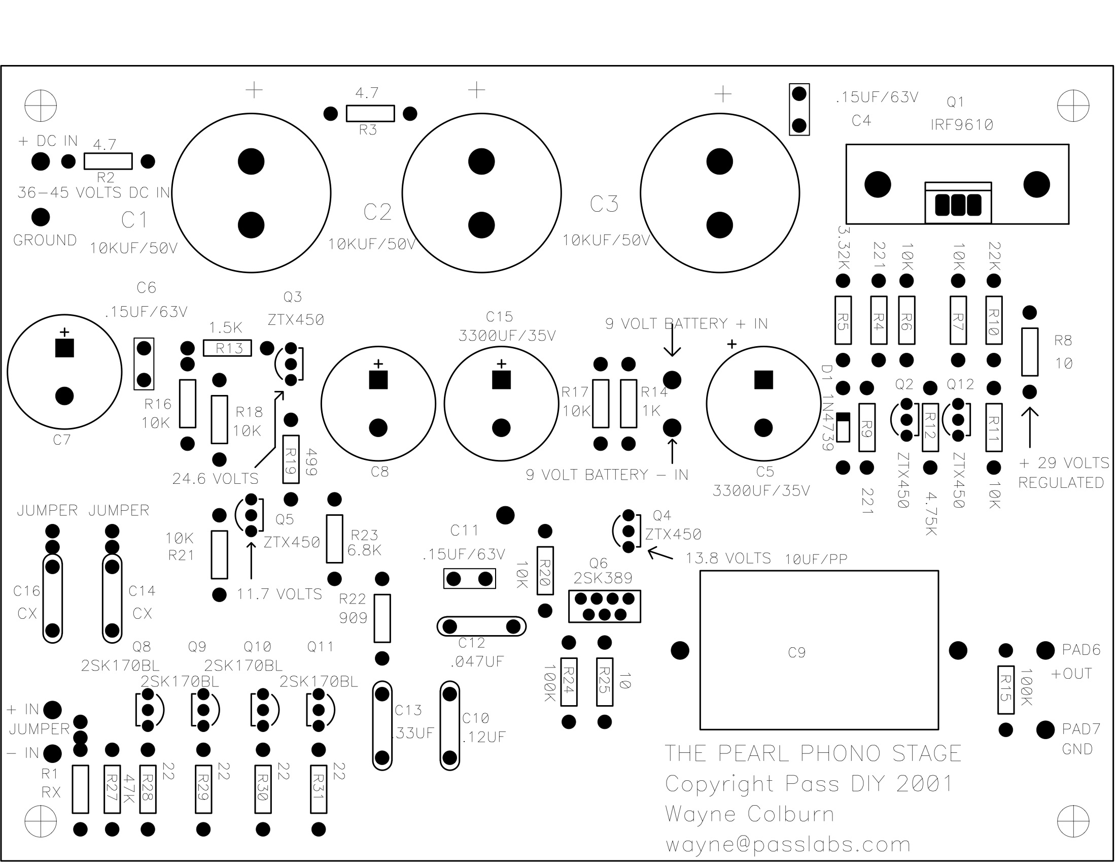

Full schematic and silk for reference (thank you Wayne for digging this up from the dusty shelves) :D

Ok , Wayne already did all the job needed
pic pulled from pdf (one you can find linked few posts above) and I did mark with red all voltages
compare with yours , if something is different - mark on pic with different color and post here
+/-10% differences are normal and OK , everything higher than that can be suspicious
