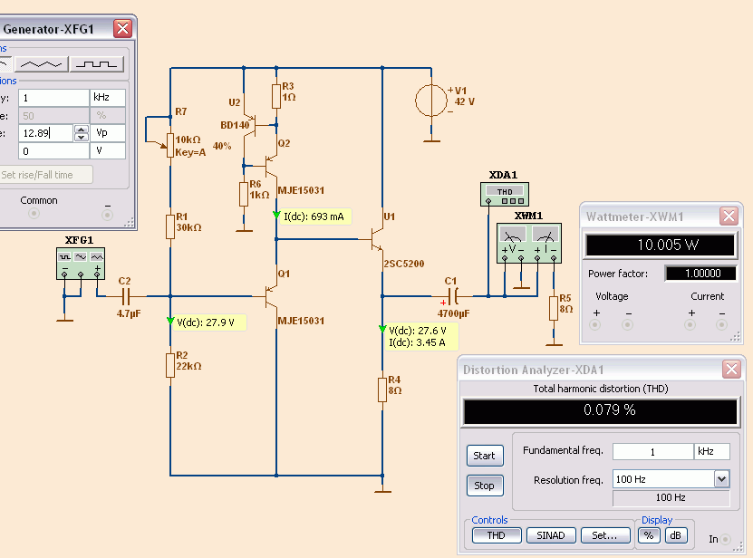

It takes a lot. For 10 Watt.
10 Watt is SQR(10*16) = 12.65 Volt peak
Most effective would one 8 Ohm power resistor.
Supply need to be more than 3x12.65V. Probably 42VDC.
Current needs to be more than 3.16A Say 3.40A.
Across power resistor would be ~27-28 Volt
27V x 3.40A = 91.8 Watt 8 Ohm resistor.
You could use 4 resistors 8.2 Ohm
Each should be rated more than 25 WAtt

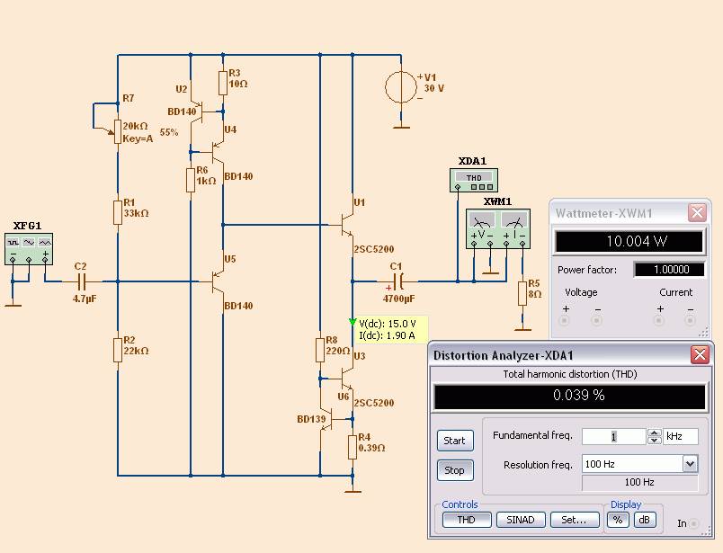

You can see in my simulation how one could do.

i did some sim and i came up with
45vdc supply. 8 ohm resistor for load. 3.75A bias
using IRF240
can get about 14v peak into 8 ohm load at clipping.
12v peak into 4 ohm load at clipping.
can u confirm this?
ends up being like 35v bias for the 30v drop across the 8ohm resistor load.
hope that makes sense. lol.

Yes.
All the figures make sense.
But it must a h**l of a power resistor.
30v x 3.75 = xxxx Watt !!!!!
But if you have 4 power resistors rated 50 Watt each
then you can use those four 8 Ohm resistors together.
Difference by using MOSFET or BJT.
Both can be used.
But we get more dropout voltage with MOSFET
0.7Volt and 4v is a difference 3.3v in favour of BJT
So teoretically MOSFET need at least 3.3v higher power supply.
