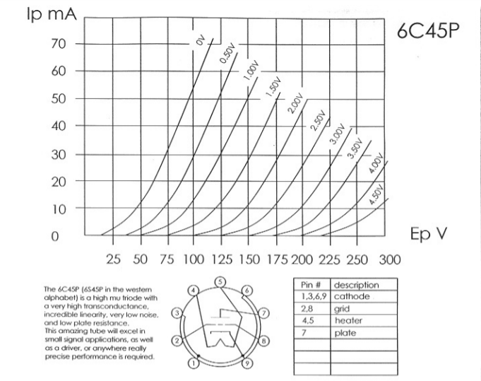

I have a 211 single ended amplifier with a very simple transformer coupled signal circuit as attached that I am rebuilding with replacement capacitors, as it's 30 years old etc.
I also have a small valve output DAC and I have just found a fabulous sounding valve: Sylvania GB5670 that I am using in the DAC output stage.
The thought occurred to me that I might replace the 6c45 driver valve with a 5670 running both triodes in parallel instead (1 per channel). I can easily change the Plate voltage as it comes from a 500V supply taken down with a 10K series resistor.
Is this a crazy silly idea for a 211 driver valve or is it something to genuinely think about?

The 211 tube isn't difficult to drive. To my understanding, the 5670 has plate resistance of approx 6.4K per section. I believe this is just good to match with the LL1660 interstage transformer. Mis-match of the source impedance would cause much narrow bandwidth or high oscillation at high frequency end. I think it is worth to try the 5670 tube and monitor the frequency response.

What confuses me about the 6c45 is the multiple cathodes , however it is a single triode at 52 gain.
The 5670 is 35 gain in class A, and I would run both sides of the triode in parallel for 1 channel so I assume that the gain then increases somewhat.
