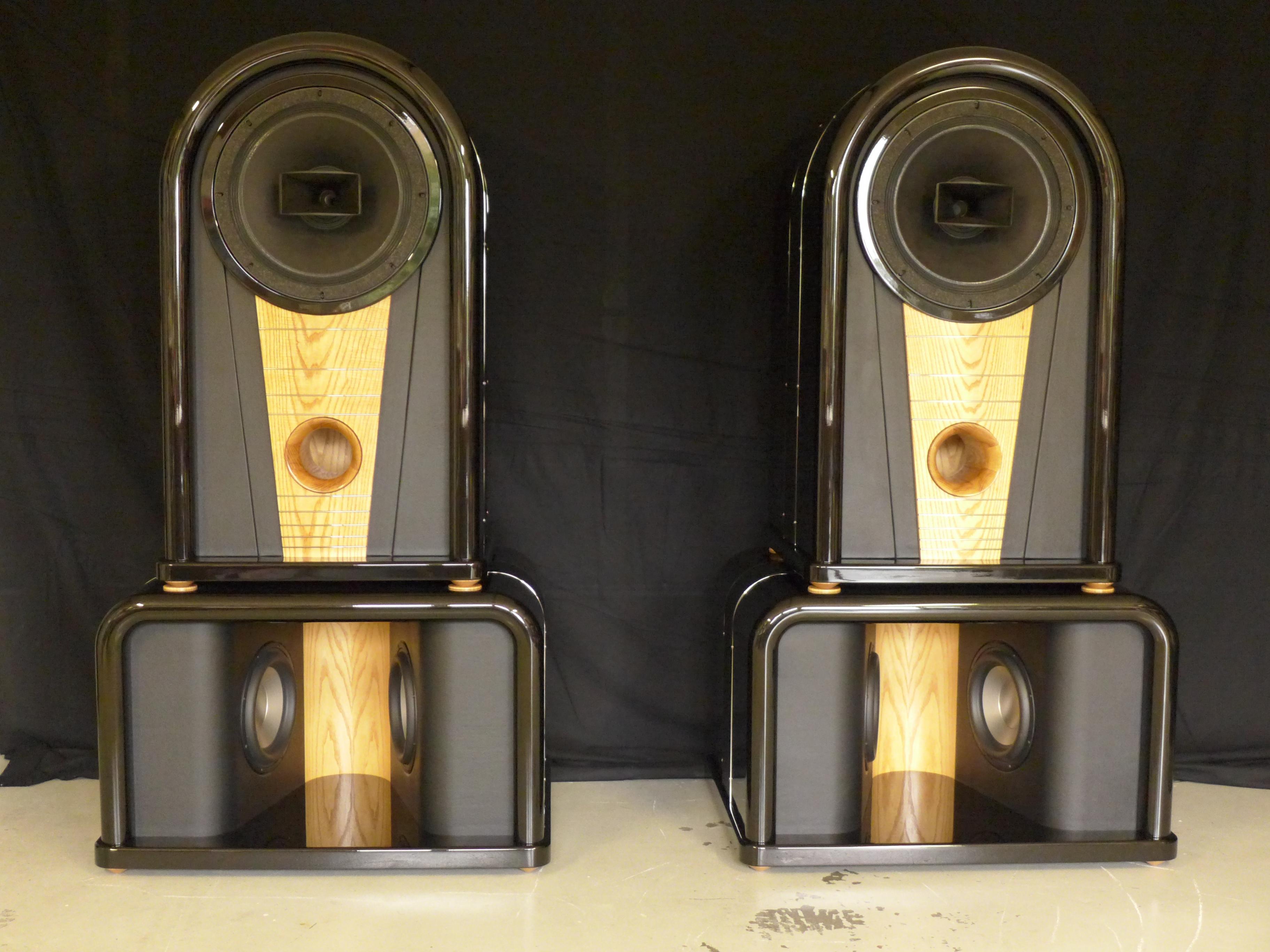

I'm new to this forum and therefore this is my first Post. I've recently finished building some rather special and rather large high fidelity loudspeakers. Each stereo side is in two parts; the top cabinet contains one GPA 16' full-range driver and will be passively driven by external amplifier, whilst the bottom cabinet contains twin SEAS 10' subwoofers and will be driven by it's own Hypex FA502 D-Class power amplifier configured in bridge mode to drive both subwoofers in mono at 1000 watts (per stereo side).

I've added an image of the speakers for your interest. At present the main speakers (full-range drivers) are working bautifully, but no luck with the bass units... Yet!
I'm obviously missing something, but I've triple-checked very setting in the software, without finding the culprit.
Any more advice, and be nice;-)

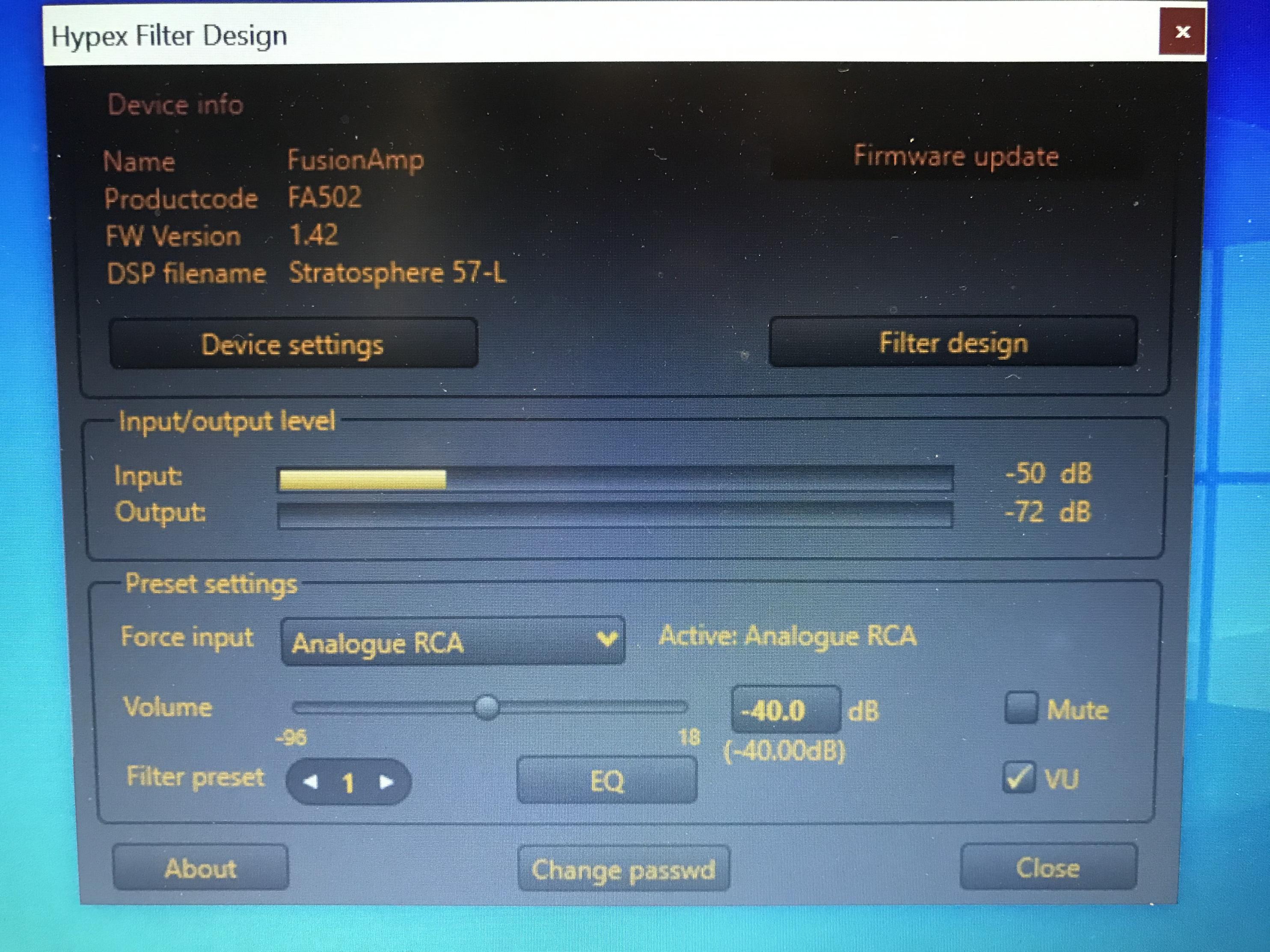

On the main screen, make sure the Force Input is set to "analogue RCA".
Make sure the volume is set no lower than -40 db, and make sure the mute setting is not checked.
Make sure you are on preset 1.
You can use the "VU" checkbox to make sure that your fusion amp is getting a signal through the RCA cables. see page 11 of the "HFD_4.95_Help.pdf" document.
Are you certain you have uploaded the filter to DSP? If the amp does not have a filter loaded for a given preset, it will be muted until it gets a filter.
That is all I can think of right now.
Analogue RCA is set for both sides. I've just set volume to -40 db and both are set to Preset 1.
Unfortunately, in 'VU' Input/Output Level, only Input has a signal. The output has no signal. See diagram. The Mute box is unticked. I've double-checked and loaded up the filter to DSP and checked all cables are in they're correct places. Still no output signal to the bass units.

The reason why there was no output signal was that the Hypex volume control needed to be closer to 0.00 dB rather than at it's minimum -96 dB.
Now I should be able to tweak these amps/bass speakers to suit the sound outputs from the main drivers...
If you use analogue input on FA from a pre-out, there is no need to reduce the output to -40 dB other than level matching to the other speakers.
At the picture there is -52 dB input, which means -92 dB output because you reduced the output by 40 dB, assuming you uploaded a unity filter with 0 dB gain (are you sure you uploaded?). I don't say that is your problem but maybe.

Your speakers look great. Very high level of craftsmanship.
I fired them up this morning (not to early) and was blown away by the shear size and depth of the soundstage and musicality. I could waffle on and insert big words to describe my experience from these new 'Stratosphere 57's' but the easiest and most straight forward explanation is 'brilliant.'
Set at 0.00 dB volume on the FA502's, it's more or less on the mark. Of course, I do need to do quite a bit more listening and the drivers need breaking in too.
I designed the S57's with influences from the world-famous and very collectable 1957 Stratocaster guitar, hence Stratosphere 57's...

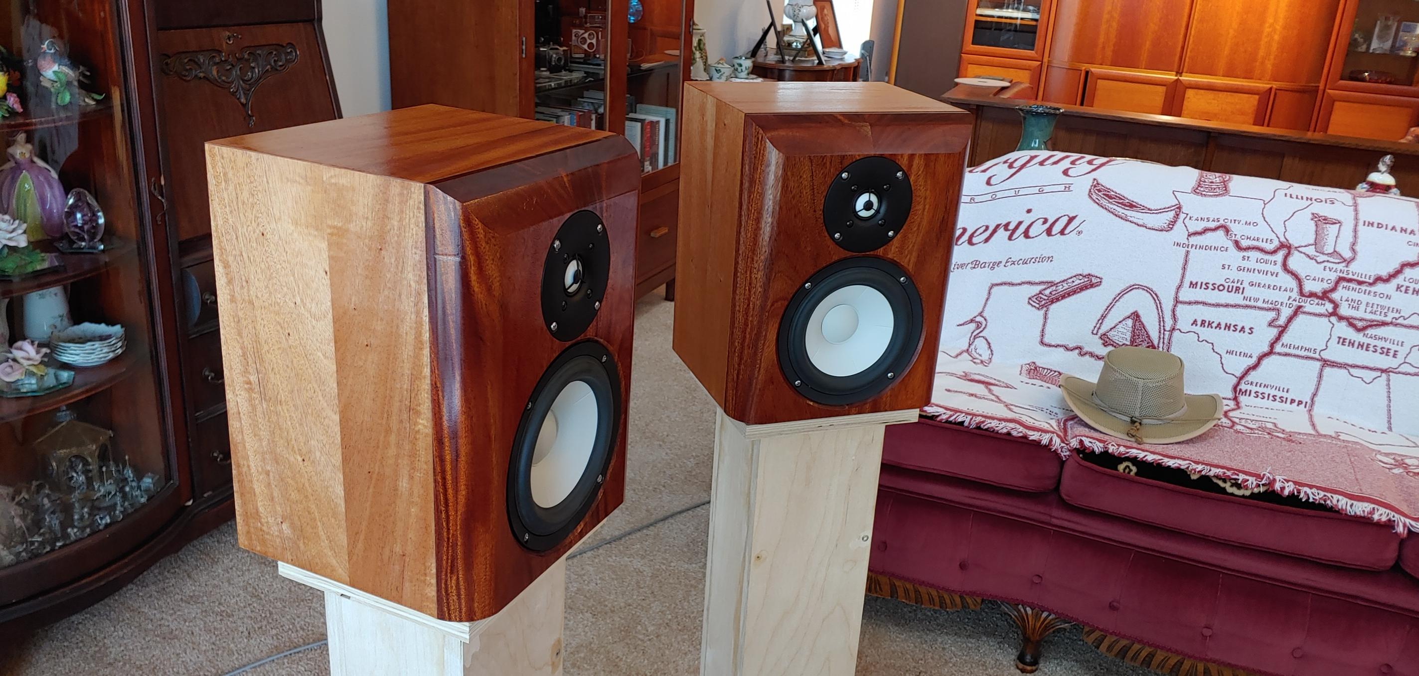

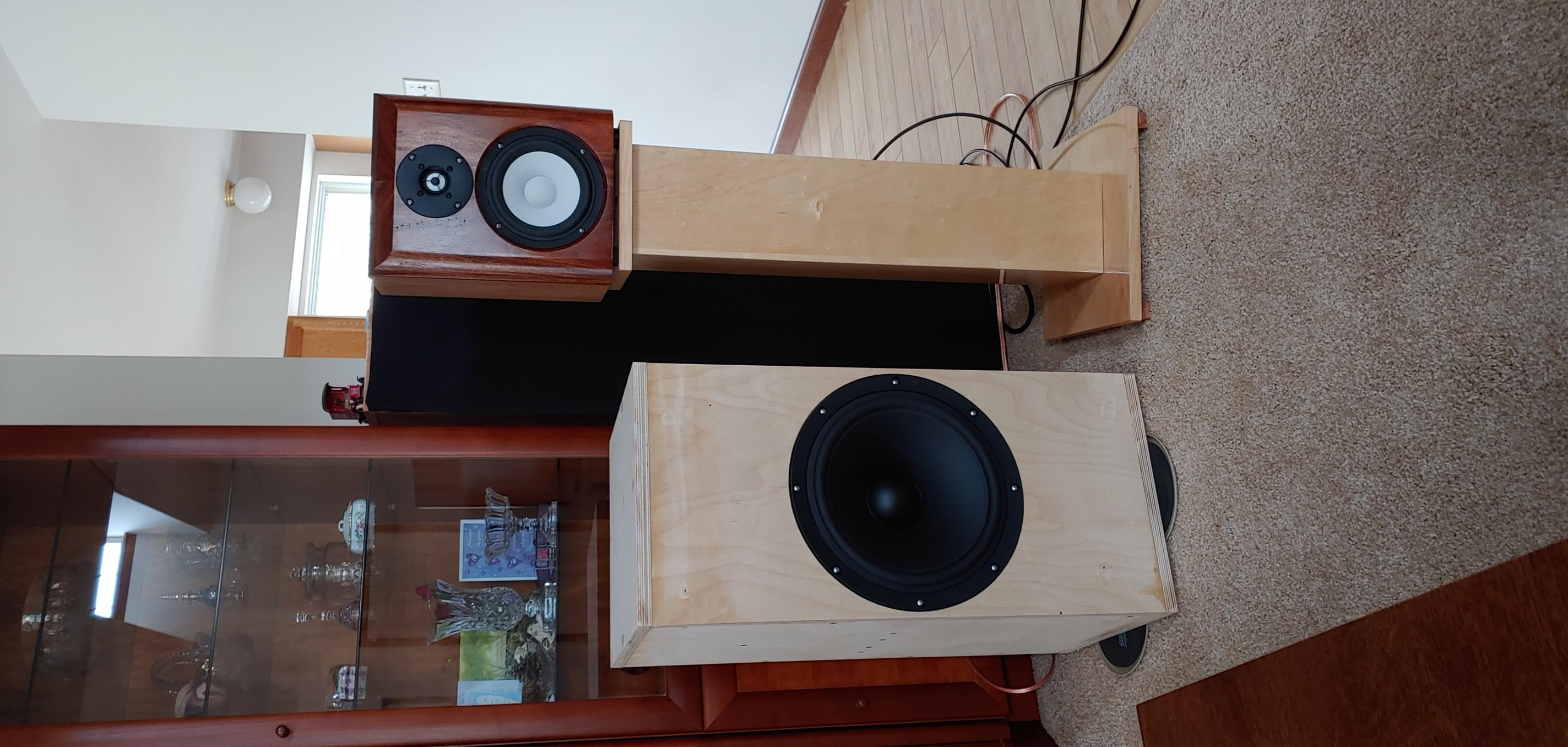

My project is a 3 way system with separate woofer cabinets. Not really subwoofers, since I intend to cross them over at 150 Hz to 200 Hz.
I went with separate cabinets because (1) I want the flexibility to place the woofer cabinets in the optimum location for each, and (2) I want to be able to experiment with different satellite drivers in the future, and this configuration is modular and easily upgraded.
In the first pic, the satellites are finished but the speaker stands are still in a state of construction. The fusion amps are located in the speaker stands.
In the second pic, I am giving the system the first serious listen with music. The woofer cabinets still need to be veneered in walnut (which is this mornings project). The speaker stands are veneered in maple. The satellites are two-toned mahogany, with the cabinet in a lighter Brazilian mahogany and the baffle in a darker African mahogany.
