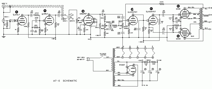

I'm restoring an old Heathkit A-7 and I think the phono stage needs help. The amp as a whole has lots of promise. The line input sounds great, even with the load of existing paper caps. I've replaced the electolytics, and a few resistors. I've linked a schematic below.
I think the phono stage sounds good for the most part, but is bass light. I've replaced the cathode bypass with 100uf, and the input resistor w/100k. I've also replaced the screen cap w/0.47uf. I'm wondering if anyone can help with a review of the RIAA values, and/or give me some help on figuring them myself. The other issue is that the gain of this stage is a bit low when used with my Shure M91ED cartridge.

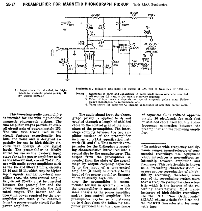

As you are undoubtedly aware, the A7 came in many "flavors". I'm attaching the A7E schematic, which uses a 12SL7 in a RCA circuit for the phono section. Changing over to that circuitry rates to solve many of your problems.
Eli raises an important point about the phono input in your amplifier. IIRC Even the A7-E phono input version possibly predates the current RIAA equalization standard, but the earliest versions with phono pre-amplifiers certainly did. (I've seen more than a few that did not have the phono stage.) What this means at the minimum is that the LF turnover frequency is probably in the wrong place for RIAA. The A7-E design should provide a lot more gain and can be tweaked to get the proper response if not spot on.

Thanks for the feedback. I was concerned that the eq was off compared to modern RIAA standards - so that's likely why it doesn't sound right. I guess the best solution is to swap it to a 12SL7, but that is going to require a whole new set of parts. The other issue I've found with this is that the output tubes seem to be run far too hot. The max plate voltage is about 250 for the 12A6, but these are running about 380 and 27ma. I'm sure stuff like that, the lack of a line fuse, and leaky PS caps all contribute to the failure rate of the power transfomers. So far I'm not finding that it sounds all that "tuby" however, sounds pretty clean and open to me, despite the use of feedback and the dated signal caps. I wonder if the different sound from what Kevin has heard is because this one has the outputs run in pentode, vs. UL for the E models?
In terms of sound it might just be my frame of reference, they aren't the last word in transparency, but compared to many comparably priced units they are very good...
Mine were the A version and they were also operated in UL. The voltages as you observed are way over the top, and I suspect this was deliberate in order to get a reasonable amount of power out of the 12A6 - Even taking into account today's line voltage increases they were operated very hot. 12A6 were common war surplus at the time these amplifiers were designed, and given the relatively low price of these amplifiers I don't think tube life was a major design consideration..
I think Eli's suggestion for replacing the phono stage is just the right way to go, EQ apparently isn't a concern as the RCA reference design it is based on is RIAA, and in addition to providing the right RIAA, and additional gain, it will probably be a lot quieter (snr wise) than the pentode based design.
Thanks Kevin, a 12SL7 it shall be! Maybe an octal based Cornet, would work well in there. That takes 1/2 of a 6SN7 for the output of the phono section, but that would not be a problem if I eliminated the tone control function - I'd have a spare socket. As for the output, I'm wondering if a 12V6 is close enough to sub and if so, maybe wire them in triode and get rid of the feedback. Heck, this will be a TOTALLY different beast, but could be a sweet little amp, especially if I can find it a sister for a reasonable cost.
