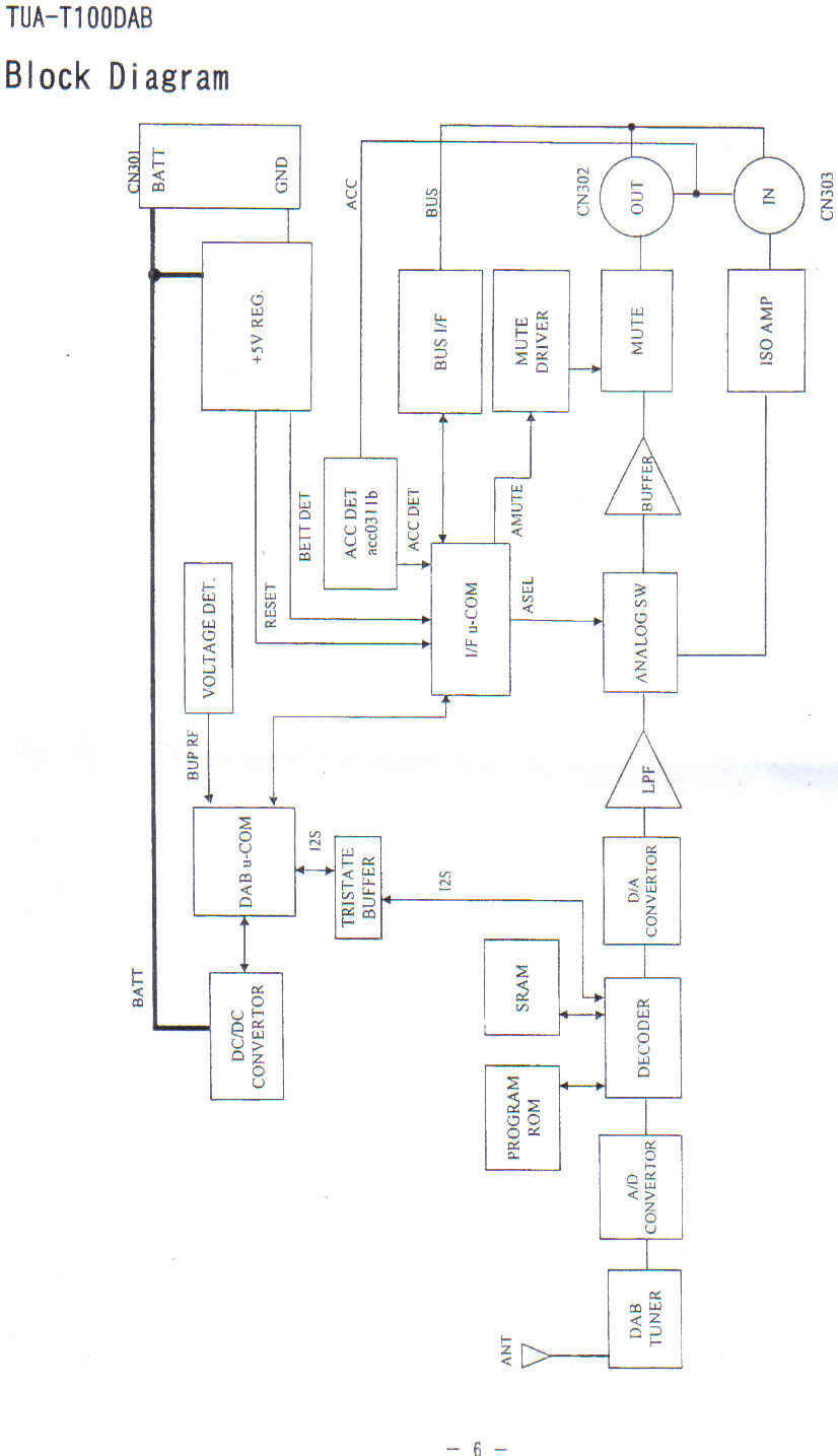

I am trying to improve the sound quality from the Alpine TUA-T100DAB tuner as this is the only non-digital source into my H900 processor and started trying out different op amp to substitute the NJM4580s seen. With AD8599 replacing all the NJM4580s, I get good bass but sound quality became aggressive and harsh especially for the vocal ... not sure if op amp needs burn-in period but it is not oscillating as scoped.

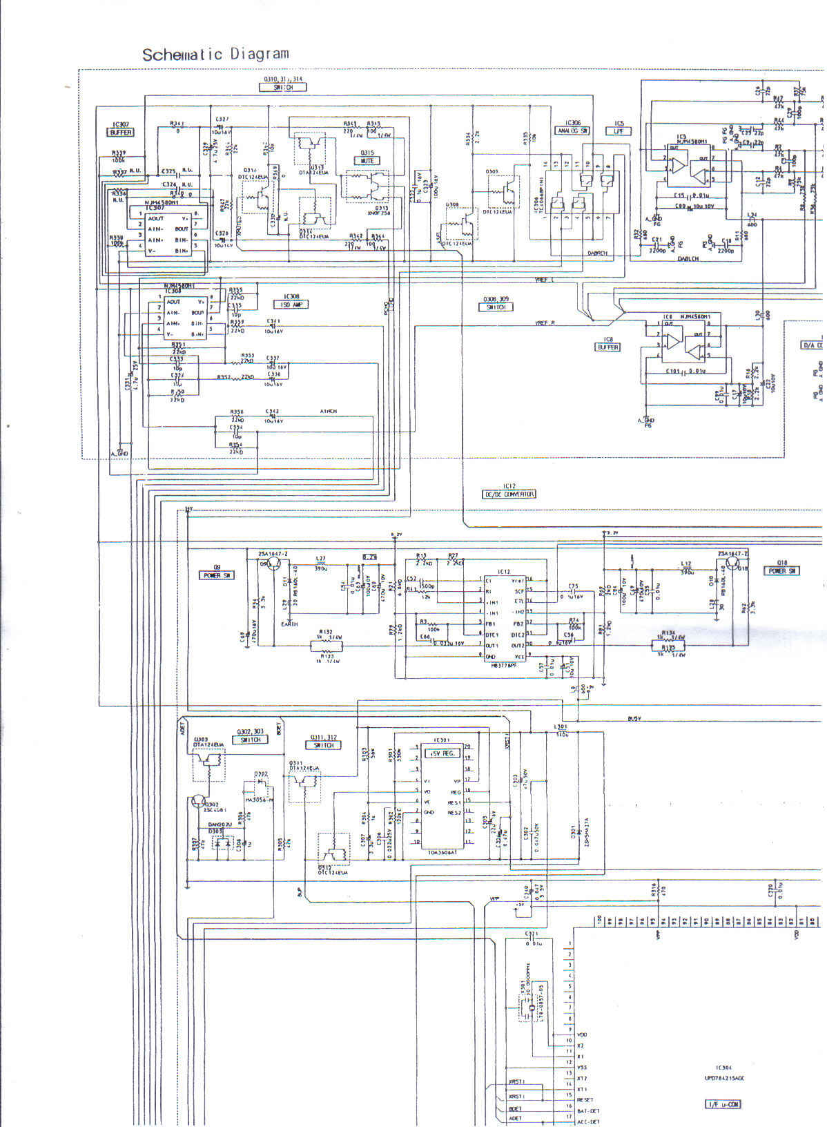

I checked the service manual again per enclosed and note that there are LPF stage, 2 buffer stages and this ISO amp which I am still trying to find out learnt about them.
Can anyone help to advise on the following:
- why is there 2 buffer stages as I did not see 2 buffer stage in the block diagram ?
- ISO amp would not affect sound quality and hence can be left alone ?
- any recommendation for the Op Amp replaced for the LPF stage IC5, Buffer Stage IC8 and Buffer Stage IC307 (or even ISO amp IC308) ??
Please also advise what are the consideration for choosing "better" op amps for the mentioned LPF stage, 2 buffer stages and ISO amp, if at all possible.
Thanks in advance.

From what I can see on the schematic, there are 2 op-amps, both configured as followers (unity gain buffers). Both are fed from the same source and feed two separate "nodes" which seem to feed multiple circuitry. The buffer configuration is typically used to provide a low impedance source to feed multiple loads.

Hi Phaselag, thanks for the information. Alpine technical person came back with this: "As you say IC5 is the filter IC307 and 308 are buffer/iso one for each Ainet bus socket as you can plug the cd changer in and switch between the dab and the cd changer" and I am quite sure now that IC307 and IC308 are not SQ related. Nevertheless, any recommendation for good LPF + buffer Op amp (instead of the twin NJM4580) with the WM8716 DAC installed is what I hope for. BTW, the voltage supply to these Op amps is 8.2V from the complete service manual. Regards,
