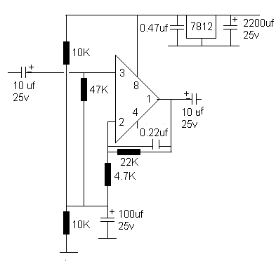

With the help of sr. members I have developed preamp (attached file) but I could not make 100% noise free or clean sounding. Sometimes I see the speaker's cone movement is not matching to music strock. Overall some correction is required to my attached circuit. Please help me.
Thank you.

Could the cone movements be very low frequent music signals that the speaker reproduces below the listening threshold? http://en.wikipedia.org/wiki/Equal-loudness_contour
The noise you have is hum, right? Use the search function. There are many threads dealing with that, because there are many possible sources for hum, e. g. inductive coupling from the transformer, ground loops, bad solder joints, to name just a few.http://sound.westhost.com/troubleshooting.htm#earth

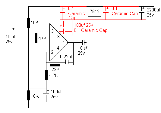

Your approval is needed. Pl find my altered schematic. Alteration is in RED colour.
Prior to addition of Cap 0.22uf on Pin 1-2, there was SSSSSSSS type of sound. for this type of sound I have to open mouth & SSSSSSS. Cap 0.22uf on Pin 1-2 is removed this SSSSSS.
Now if I shut the mouth & sound by my nose like HAMMMMMMM yes, this type of sound is present now. I thought this HAMMM is comming from my source(DVD Player) but not I tried with remove all connection with DVD Player. One more thing if I touch the Subsoofer with no sound I can feel the vibration/hammm.

There is a joint between the supply midpoint generator (2x10K) and the top of Ci (100uF near the inverting input). Since you have not labelled the parts I find it exceedingly difficult to point it out to you.
The connection needs to be broken, as it is feeding half the supply voltage to the inverting input through the feedback resistor network and may be a source of hum. I've made this remark on your earlier thread but it is still not corrected.
Unless, of course, it's a mistake in the drawing.
Why do you need a preamp with a gain of ~4 between a DVD player and amplifier??
It sounds to me as if you have too much gain hence hum and hiss.
The capacitor 0.22uF is acting as a top cut and will result in muffled sound.

1) The 7812 regulator should be replaced by an LM317 adjustable regulator. Decouple the "Adjust" pin with a good quality 1uF film capacitor (or a 10uF electrolytic). This will dramatically reduce the noise at the artificial ground node on the non-inverting input. Bob Pease at National Semi wrote an entire white paper on the bypass for these regulators.
2) Consider reducing the values of the gain and feedback resistors. If your CD player can stomach it, use 22K.

The 100 µF capacitor must only be connected to the 4.7 k resistor, not to anything else. In your schematic there is a connection also to the two 10 k and the 47 k resistors, which you have to interrupt.
As per my experiment, 100 µF capacitor should not disconnect from 10K+10K+47K joint. I removed the joint 4.7 K and add 2.2 µF 25V capacitor to 4.7K to Ground. Now subwoofer's sound is stable & Cone movement matching to sound.

That is exactly what you should have done, the circuit is fine now. The 100uF will stabilise the half-bias point and the 2.2uF (I would use a little higher - 22uF is fine) will keep the DC gain at 1.
The fan problem is a ground loop or EMI. I suspect (as I have all along) that you have some layout issues. Unfortunately can't help as I've not seen the layout. Try putting a small (~100pF) capacitor between pin 2 and 3 of the NE5532, it may help. Also try runnin the amp from a different wall socket.

0.22uF is in there to sub-woofitize the opamp, problem is that above a few hundred hertz it looks like a short across the feedback resistor and you just have a buffer, so the gain is 0dB out to infinity. 220pF will start to roll off at 15kHz and will be down 3dB at 33kHz.
You can easily make a 2 pole Sallen-Key low pass filter for a sub -- get the FilterPro software from Texas Instruments (it's free), select Sallen-Key, 200Hz, and gain of 5.6 (15dB).

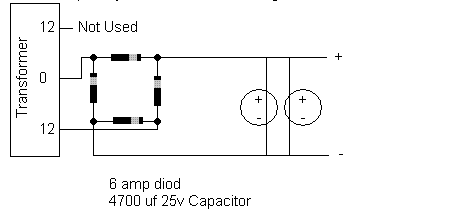

1) Please find my power supply as attached picture file
2) Amplifier is TDA1554q (It is as per Philips datasheet accept input caps are 10 uf 25v)
3) Preamp NE5532 for sub. (You know the Circuit)
