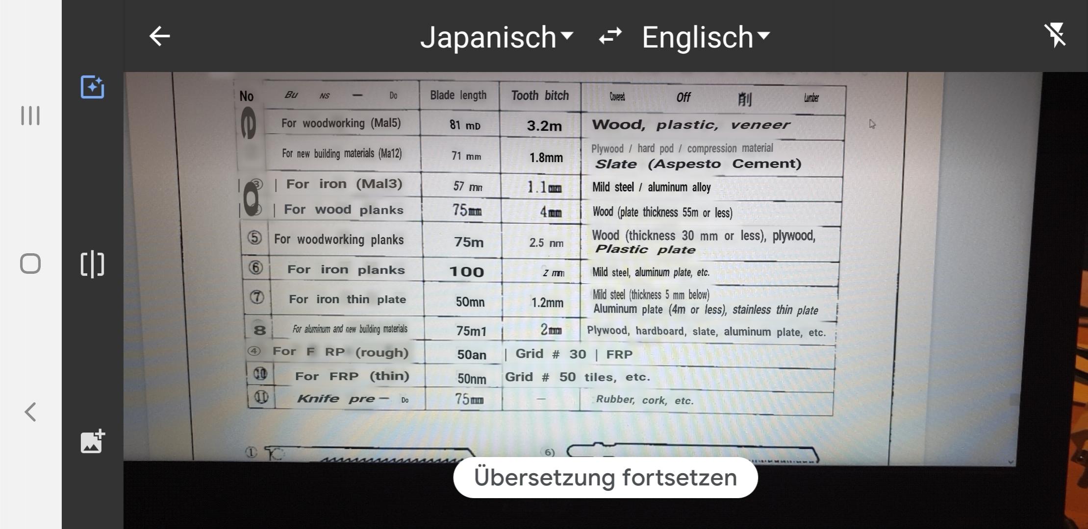

With help from Google translate on mobile phone.
THANKS Fonebones, didn't thought about that... and I have google translate app in my phone but never used the camera translation: new to me, hehehe. It works very well indeed.
Also big Thanks JMFahey (and son)! About the type of jigsaw, that is the attachment tip end: it can have U dent form or a T bayonet form.
I think I have what I was looking for and I can manage with the camera translate app.

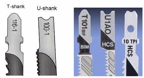

....please define what is a "T or U blade".
This question bedeviled jigsaw users for years.
In 1965 the blade top was square with a hole, you drove a cone-screw to set the blade.
This may have picked-up a centering U-dent; I don't remember some years too clear.
BOSCH had a clever trick of you put the blade in rotated and let it self-center? Ah: you loosen the 'top handle', insert blade, then tighten handle to the click. I have that type now and it is wonderful.
Apparently they can punch all the types of shapes on one blade now.
The Ryobi JSE-60A sure looks like an Asian-market re-imagined Bosch. (Not a copy but a do-alike.) It appears to take all 3 types of shanks. That image just shows the blades Ryobi was pitching back in 1986. It is usually pretty clear if your saw won't take a blade: it won't stay in. Rarely there is a tolerance issue: it goes in but hard cuts work it loose.
