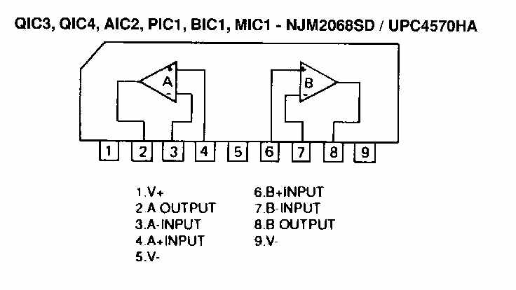

Hi everyone just wandering if anyone has or knows where to get a datasheet for an NJM2068SD, The original part im repalcing is an NJM2068LD made by JRC.I have searched for a few days now and can not seem to find a datasheet. I ordered this part thinking it would be the same but instead of 8 pins its got 9 pins, I was hoping to find the datasheet and see if there is any way i can use this part instead of the original as i cant get hold of them and i need 8.. Please help.

We can blame the Grundig engineers here.
Pinout:
