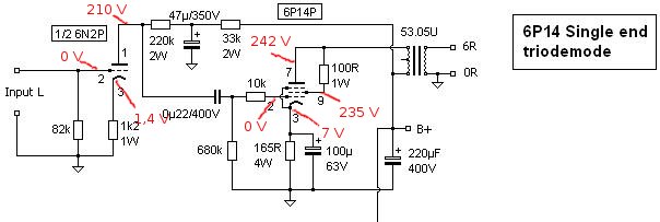

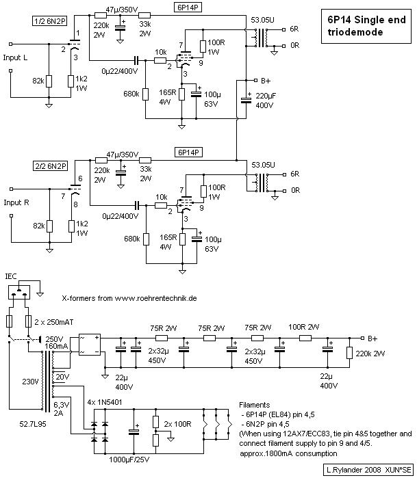

Help on EL84 / ecc83 SE project -very low volume
Success! 🙂 No buzz or hum anymore. Problem was the ground connecting from the input. I made a single ground connection for both left and right input channels and that is what i changed. Now both channels have a separated connection to the star ground.
Thanks for the advise. Learned a lot building this amp.
And now i am going to enjoy some music!
Here's a pic
