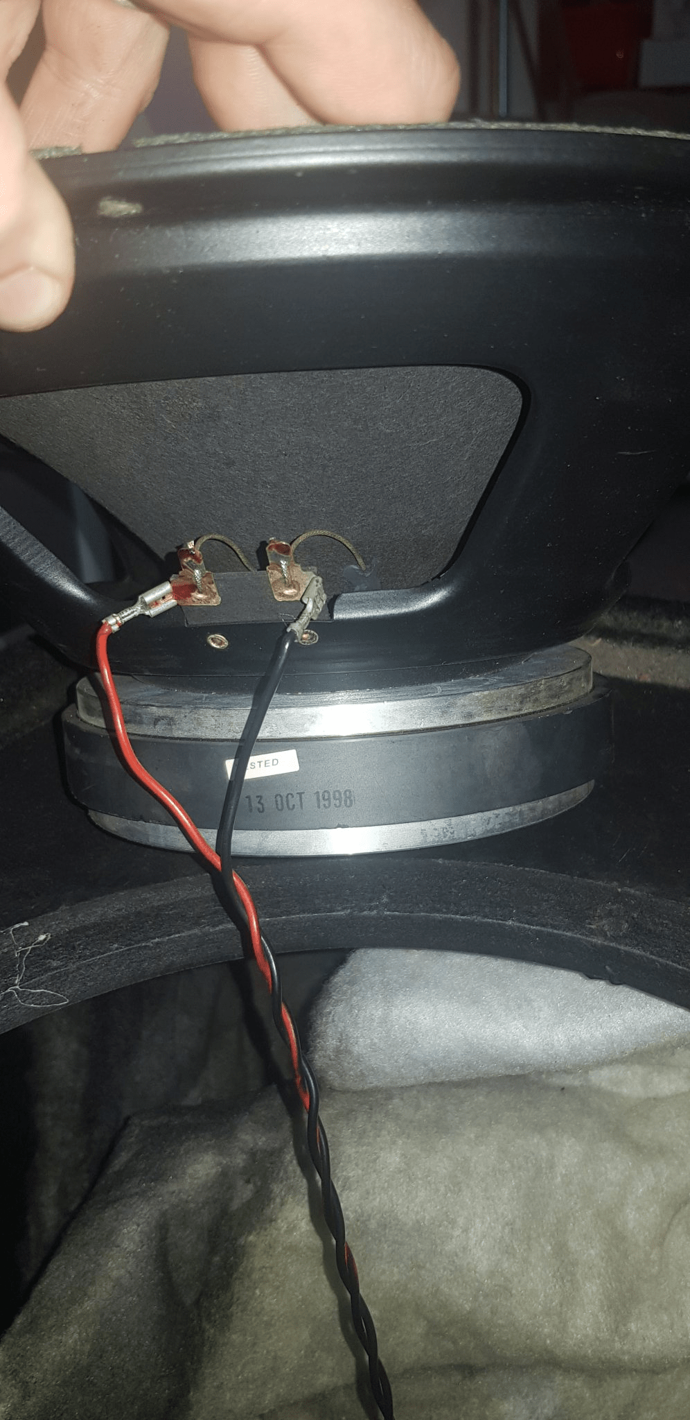

You dont get a steady reading using a regular ohm meter to measure voice coil resistance (unless the driver is in an ultra quiet environment)
Remember, any slight movement of the cone (especially a large one) caused by sound, wind etc.. moves the voice coil and generates a voltage that will effect the reading.
i could be wrong but with the described fault i would investigate the connection point between the tinsel lead and coil.
that would require removing the dust cap and scraping away the usual glue glob anchor on the surface of the cone to fix the connection, it may save you the cost of replacing the driver...
Hi, yes measuring the correct woofer.
Message from peavey its not a peavey speaker or cab, just a system made to look like it is.

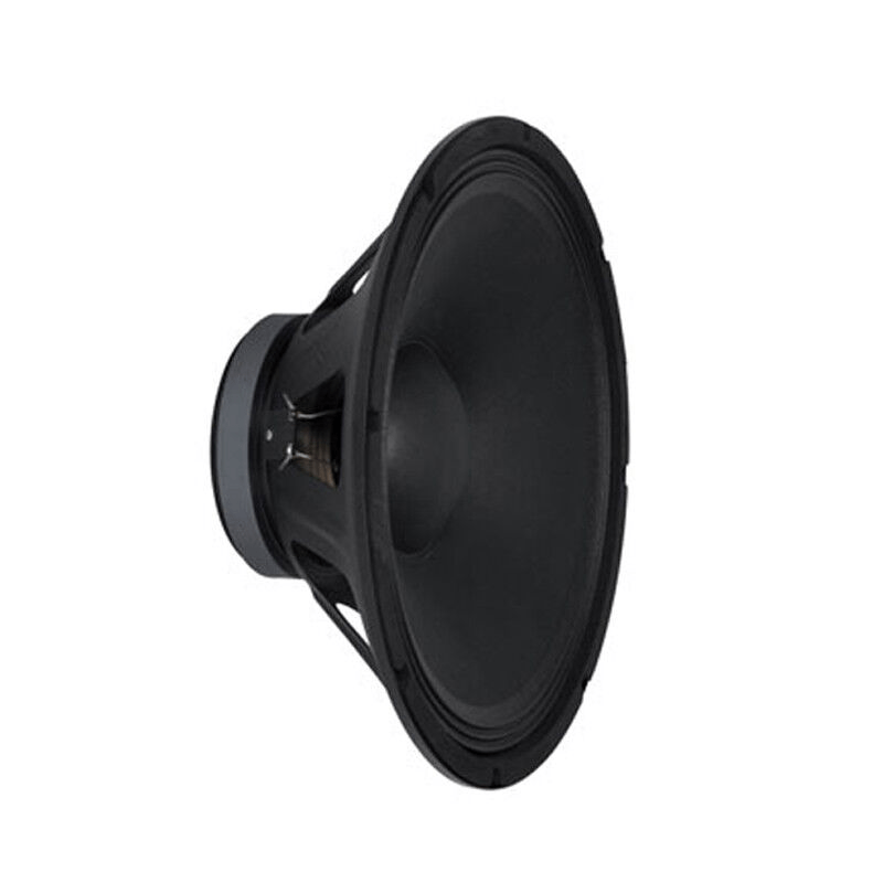

So back to looking for an 12" 8ohm speaker ???watts. (as high as possible) not braking his finances.
The Peavey woofer to which I linked earlier may be as good a bet as any in the circumstnces, and is not too costly.
As a superior choice, look at the FANE Sovereign PRO 12-500.
The woofer power rating should exceed the rms power rating of your amplifier by 1.5 to 2 times, preferably the latter.
