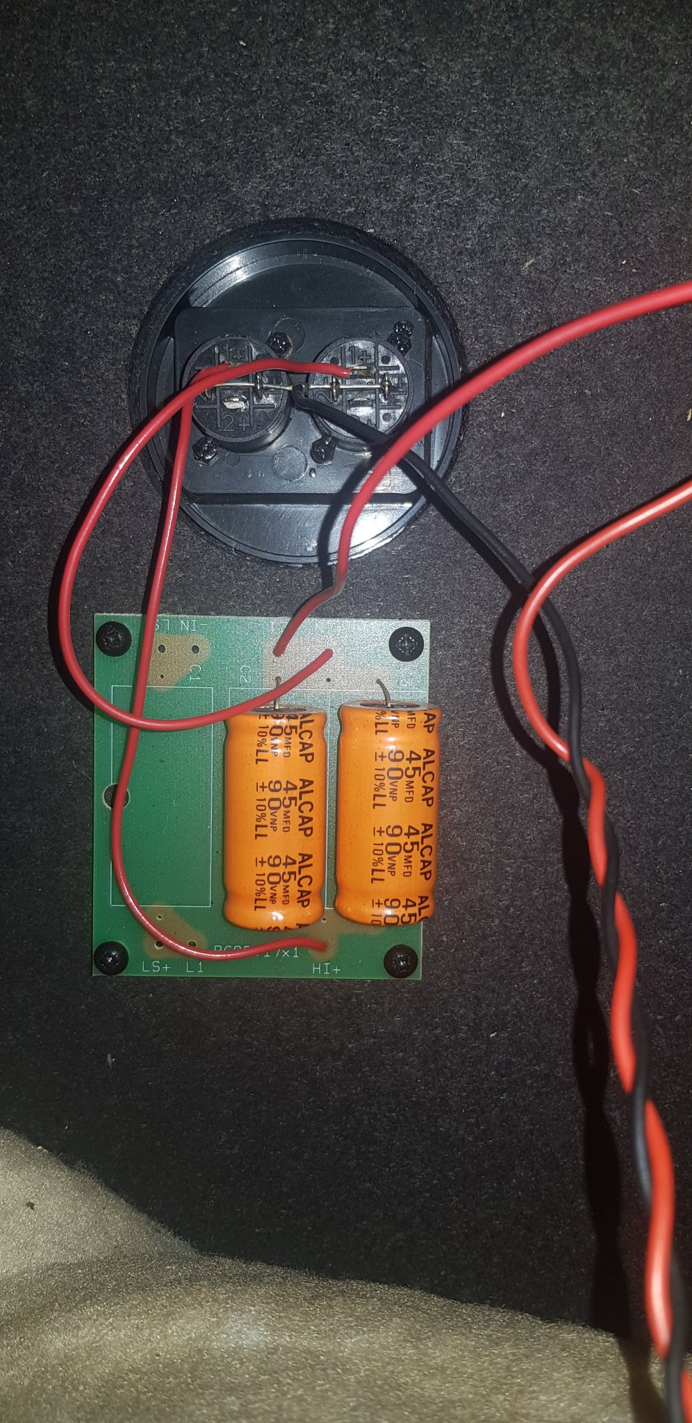

How old are those Alcaps, Keith?
They are very reliable and the ones I've measured have remained in spec over tens of years.
Those are axial bipolar types used in a crossover network, two capacitors each 45uF at 90V in parallel.
You may be able to find just one 100V bipolar capacitor at 100uF, which should be ok for replacement of both.
But they may not need replacement at all.
Falcon Acoustics stocks 100 V Alcaps, but not 45 uF ones.
https://www.falconacoustics.co.uk/l...tycap-solen-audio-capacitors.html?cat=231&p=2
If the two 45 uF capacitors are in parallel then you could replace them with an 80 uF in parallel with a 10 uF.
However, I doubt if this is necessary.

But if the sub has more than 20 yo, l wouldn't swap it.
Be aware than LL at Alcaps means low loss. It is for caps that has low "resistivity" , and being in parrallel increase twice this performance.
A cheap MKT or MKP of 45 uF /100V or more will do also.
Edit : maybe the voice coil is veilled ? Is it moving freely when pushing the cone with hands?

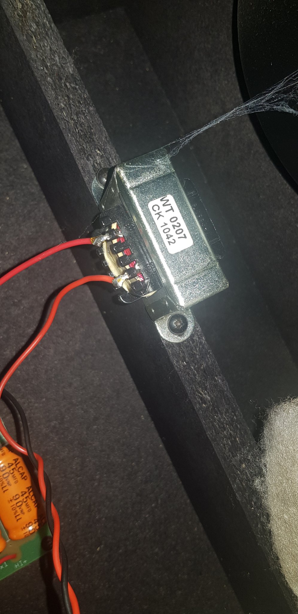

That "transformer' is an 'inductor', part of the low pass filter in conjunction with the capacitors.

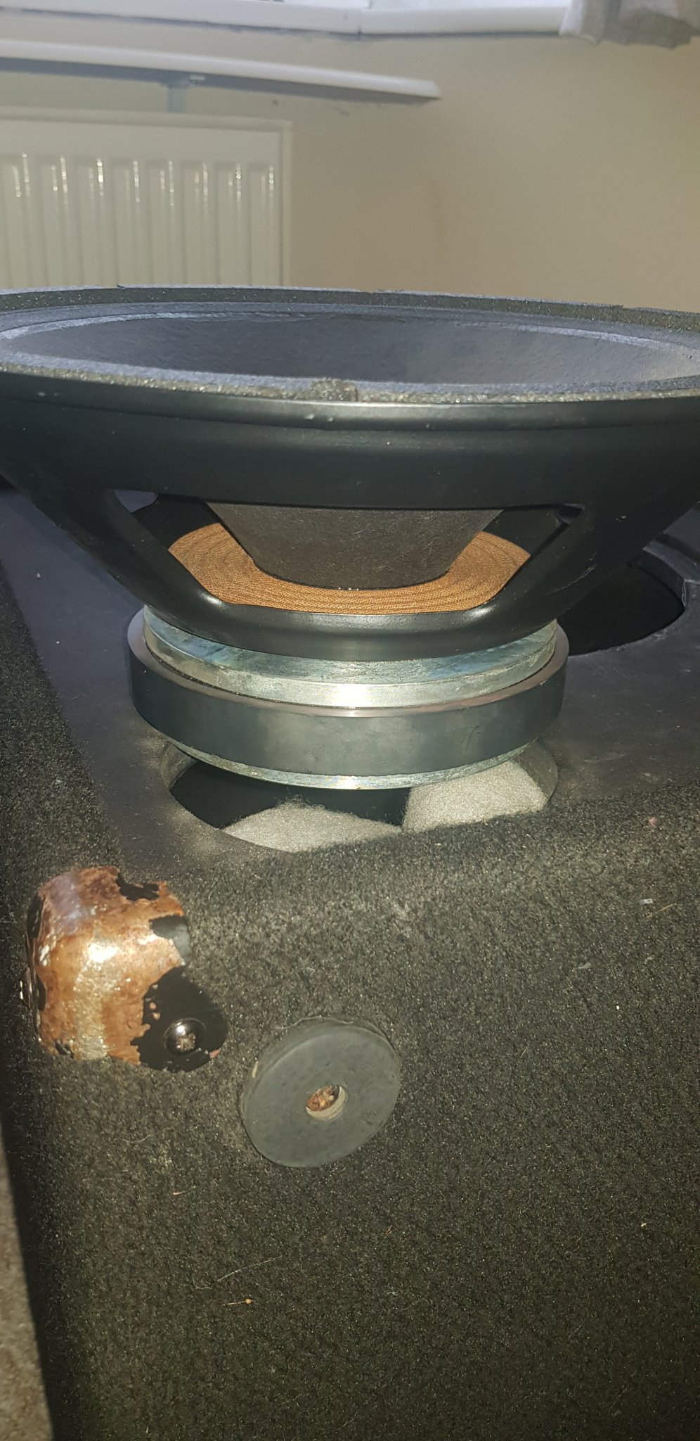

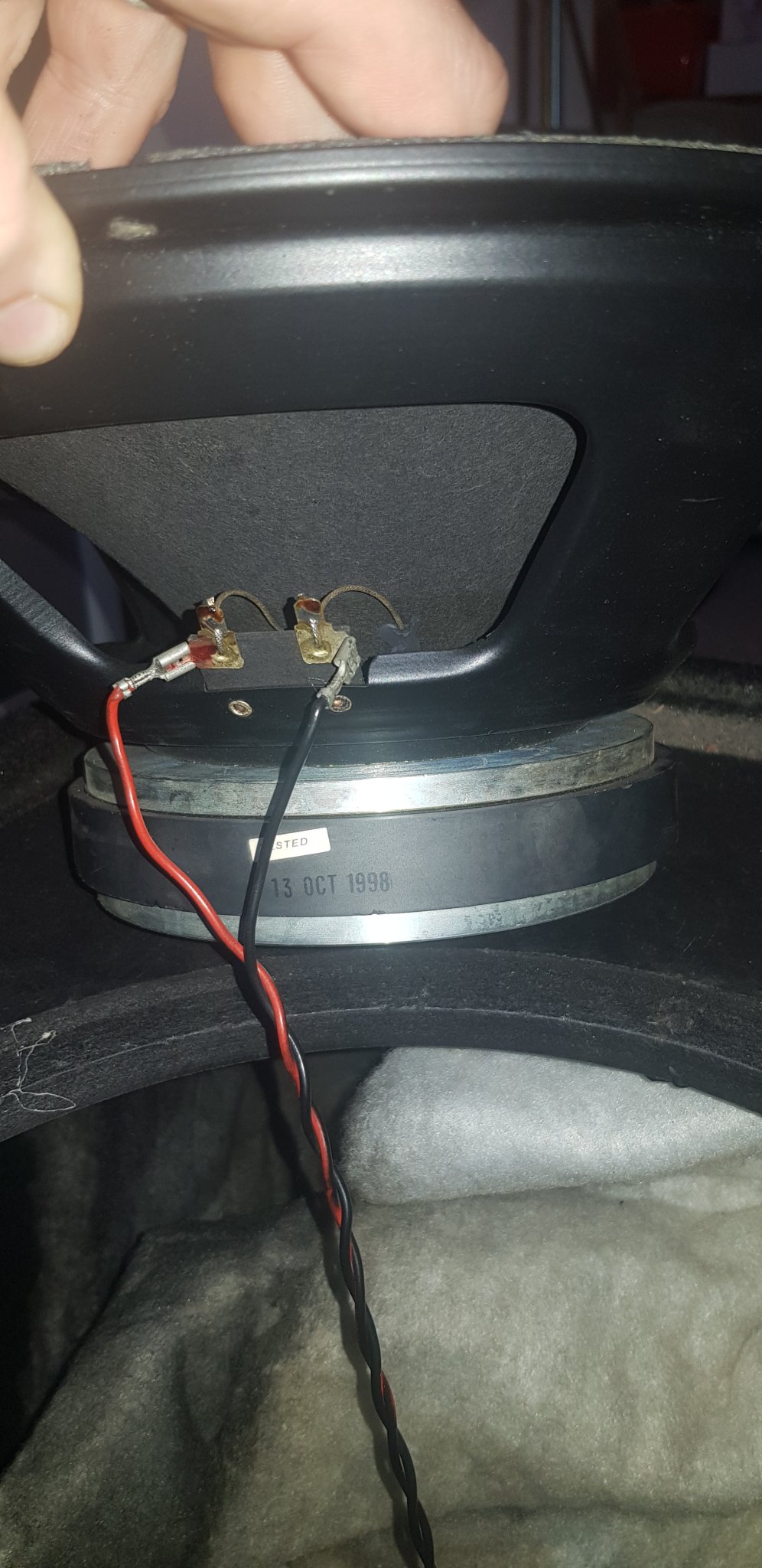

Ok, I can conclusively say its the speaker that U/S, turning it round no impact. The spider is all intact.
Now the speaker has very little in the way of markings, so have no idea of ohms, watts as no plate on either driver.
The pictures don't give much away. the only # I can find is UK M23 or UK N23
As I'm seeing it, from the back, the left is the input speakon. The right speakon is the output for the tops. If this is the case, the caps are not even in the woofer circuit, and the transformer style coil is the only thing in series with the woofer and not shunt components. Being this...
I would try the driver in operation outside of the box at low levels and see if it makes the noises you are hearing by itself. If it does not make those noises, you have isolated the problem to the cabinet. Make sure there are no air leaks, that all structures are affixed solidly.
If all this is good, and low levels in the box yield no noise, then it is possible you are bottoming the driver and the voice coil is smacking the backplate of the magnet inside. How far is is moving when the noise occurs? If a half inch or more, then you could be bottoming the driver. This means it is being used too loudly and will lead to premature failure.

I would hold off on purchasing a woofer that simply "looks the part".
The enclosure has been tuned by those twin reflex ports to match the exact characteristics of the original driver.
Not knowing these characteristics means that any substitution would be a hit or a miss affair with regards to the bass performance.
Good to no that the crossover is nothing to do with the driver circuit.
To be clear, the crossover has a lot to do with the driver circuit.
The inductor in series with the woofer passes the bass frequencies while blocking the higher frequencies.
The capacitor in series with with the satellite speaker passes the higher frequencies while blocking the bass frequencies.

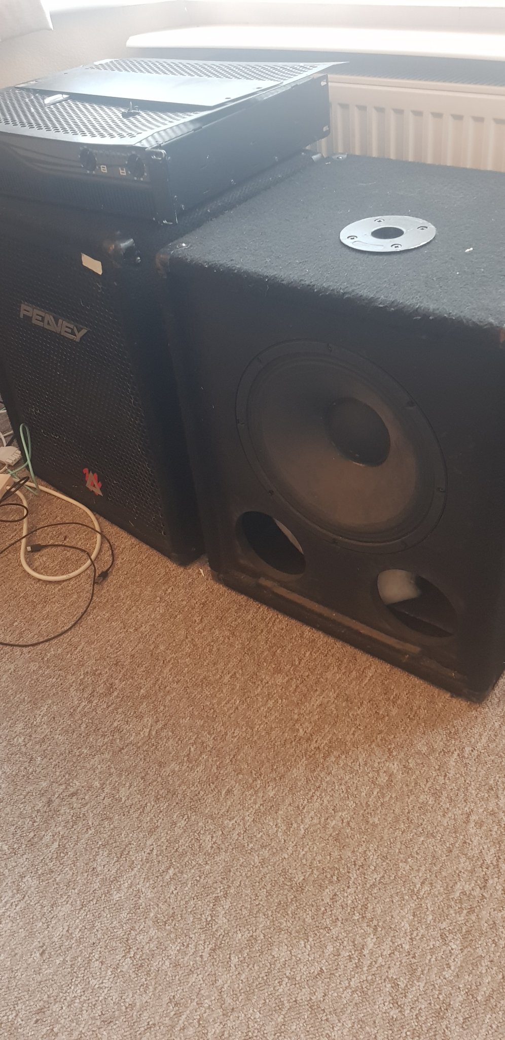

Yes that's the problem, no markings on the cab inside or out, so at a complete loss.
Looking at vintage peavey cabs they made 18" not able to find 12 ".
plenty OF new CABS FOR SALE LOOKING THE SAME WITH OUT ANY drivers, so could have been a home made, that said it does not help with "what was in the cab"?
Perhaps the enclosure is not so finely tuned to the woofer after all!
However, it would be best to be sure of the woofer's nominal impedance so that you can at least match that when buying a replacement. I'd guess 8 ohms for a pro cabinet.
If you have access to a multimeter, measure the resistance in ohms across the terminals of the good woofer - after disconnecting one of its connecting wires.
That would allow us to deduce its nominal impedance.
