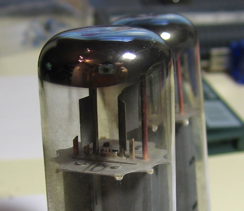

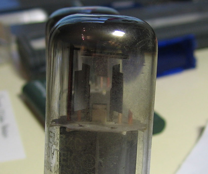

no discolourations, pot is ok, cap measures 5uF.
The only thing I see is that on one valve there´s a small metal cap between the plates. The other valve shows two wires instead of the metal cap. The cap is about 4mm x 5mm x 2mm and forms a sort of box over those wires.

Hi William,
Try to remove the entire module. Look at the tube with the missing box. Rotate the assembly and see if any metal bits show up, you may need to shake it a little. Look around the lead wires inside the envelope near the base.
Those tubes are an extreme pain to replace. I hope you don't have to do this. Can you post or PM a picture?

Hi William,
Are you sure the other part isn't hiding up in the silvered portion??? I hope!
That's how they flash the tube. The compound is on the metal piece (the getter) and it's heated to form the silver coating (flashed). The getter is no longer useful, however we can't have it running around free inside the tube.
If it's found loose, you must replace both tubes (to get a pair). Install only good tubes due the the problem of removal. JJ or Electroharmonix would be my choices. Try them in another amp before soldering them in.

Hi William,
The getter is still attached then. Good.
The only way to test a tube is either in circuit and under power (measuring the voltages on the pins) or pulling it and substituting another tube. The latter is very difficult because the tubes are soldered in. I break them into pieces and remove the pins one at a time. Much faster, and the tube is guaranteed bad after that.
