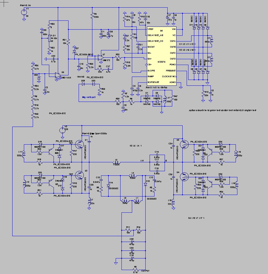

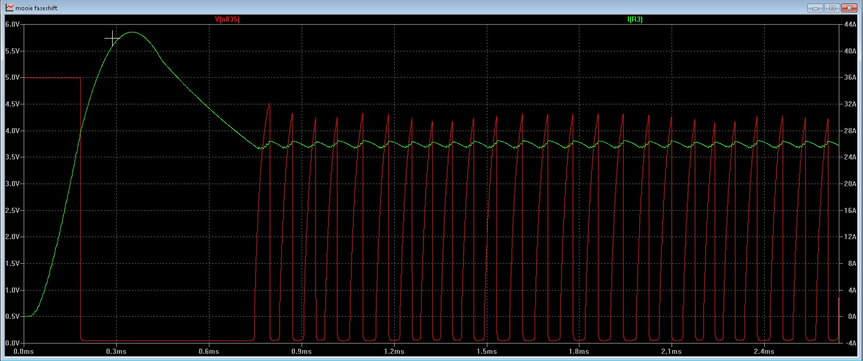

I did see this
I am busy with a fase shift welding inverter for MIG, this needs to be a voltage feedbacked one, a constant voltage source.

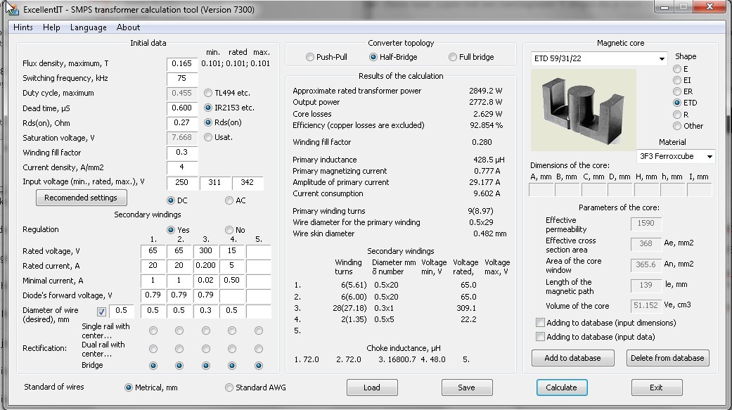

I ask myself there are different topologies and I did see that for welding she use the quasi resonant types with a UC1865 controller who do have a VCO and not a normal pcm as in the fase shift version. I read however that fase shift get used more, these do work better? or maybe someone on this thread do now what is the best way.
For the supply who I want to use for the hybrid amplifiers what do put put 65 + 65 v 20 amps 300 volts 300 mA, and 15 volts 5 amps, resonant type with the UC3865 because the transformer sees then a sinusoidal signal who is more friendly for capacitors, and I have soft switching, for welding this is also used.
Thanks for advise,
PS can I use a toiroidal transformer like this one?. keeps radiation small.
