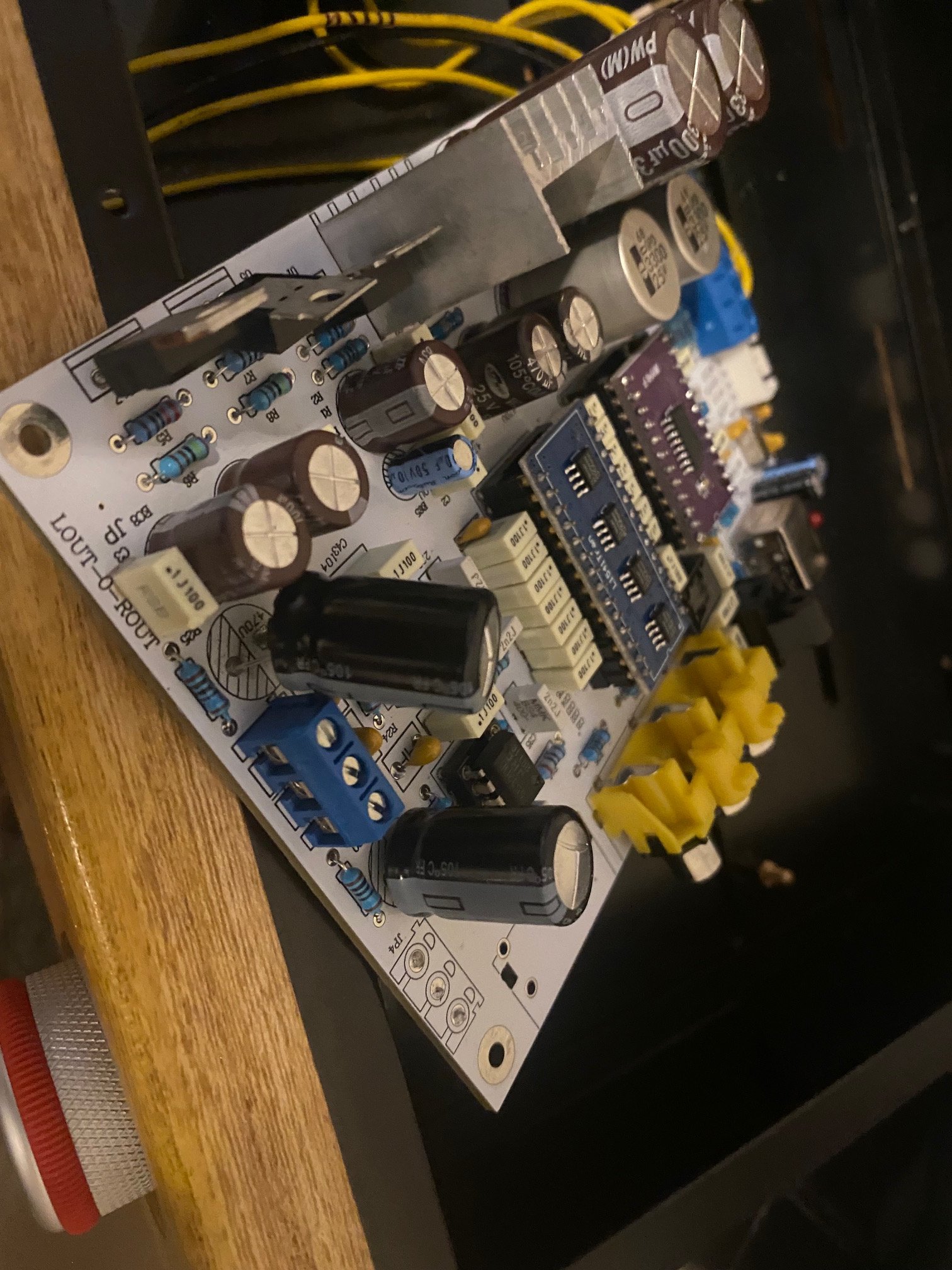

One assumes the rectifier diodes on the left hand side of the board are correctly oriented. Also what use does rhe empty space for another blue connector block at top right of pcb serve. The middle screw on the block that is present where does this and the other two connect.

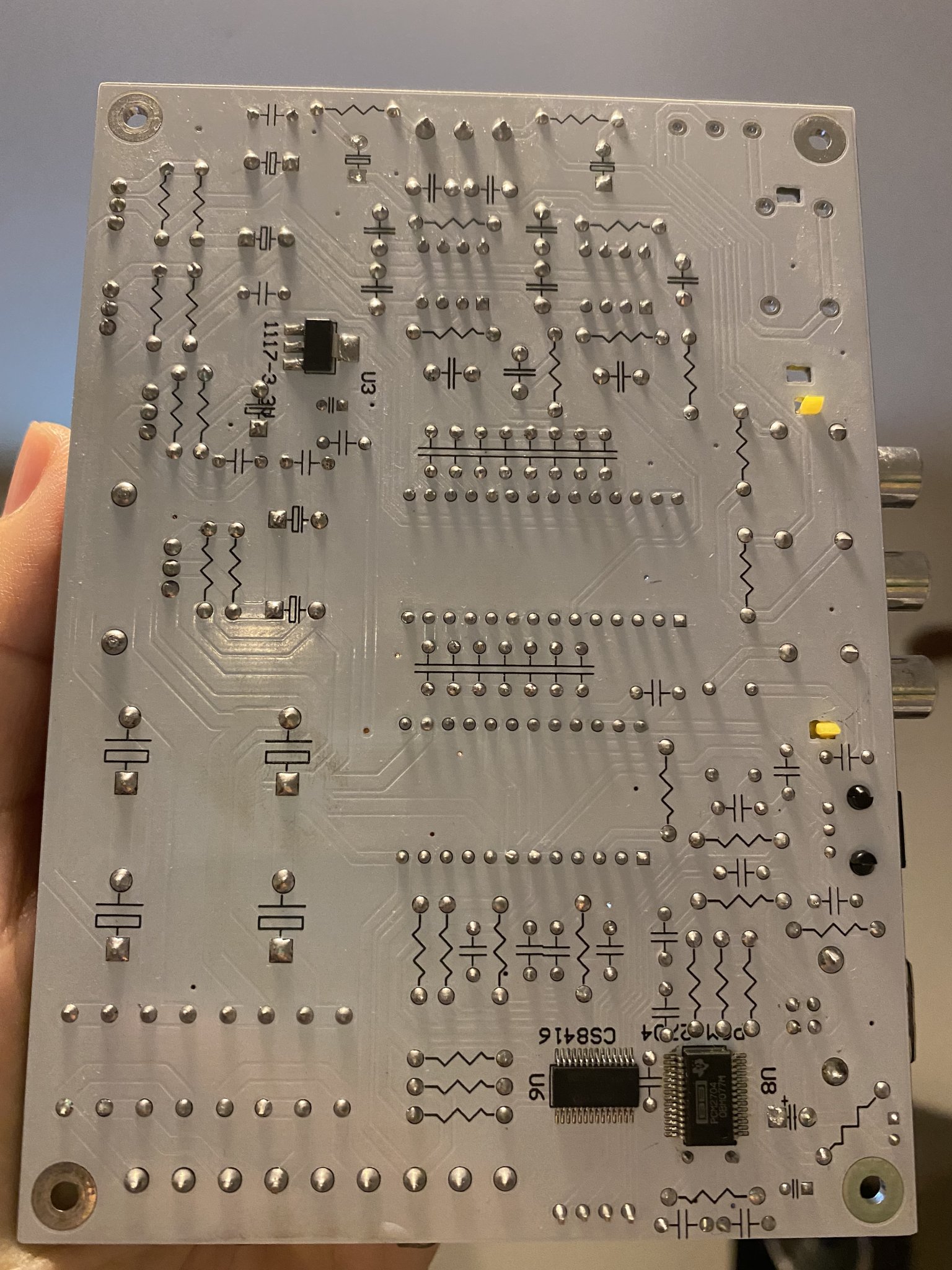

It would be useful if you would post a photo of the underside of the pcb with the same orientation as the component side.

May I ask; why is the middle of the board obscured with a black blob? No problems if you don't want to say.

This was my bad - I was trying to draw circles around the capacitors, and as I was struggling to do this, I made those dark spots by mistake and saved the pic without realizing...May I ask; why is the middle of the board obscured with a black blob? No problems if you don't want to say.

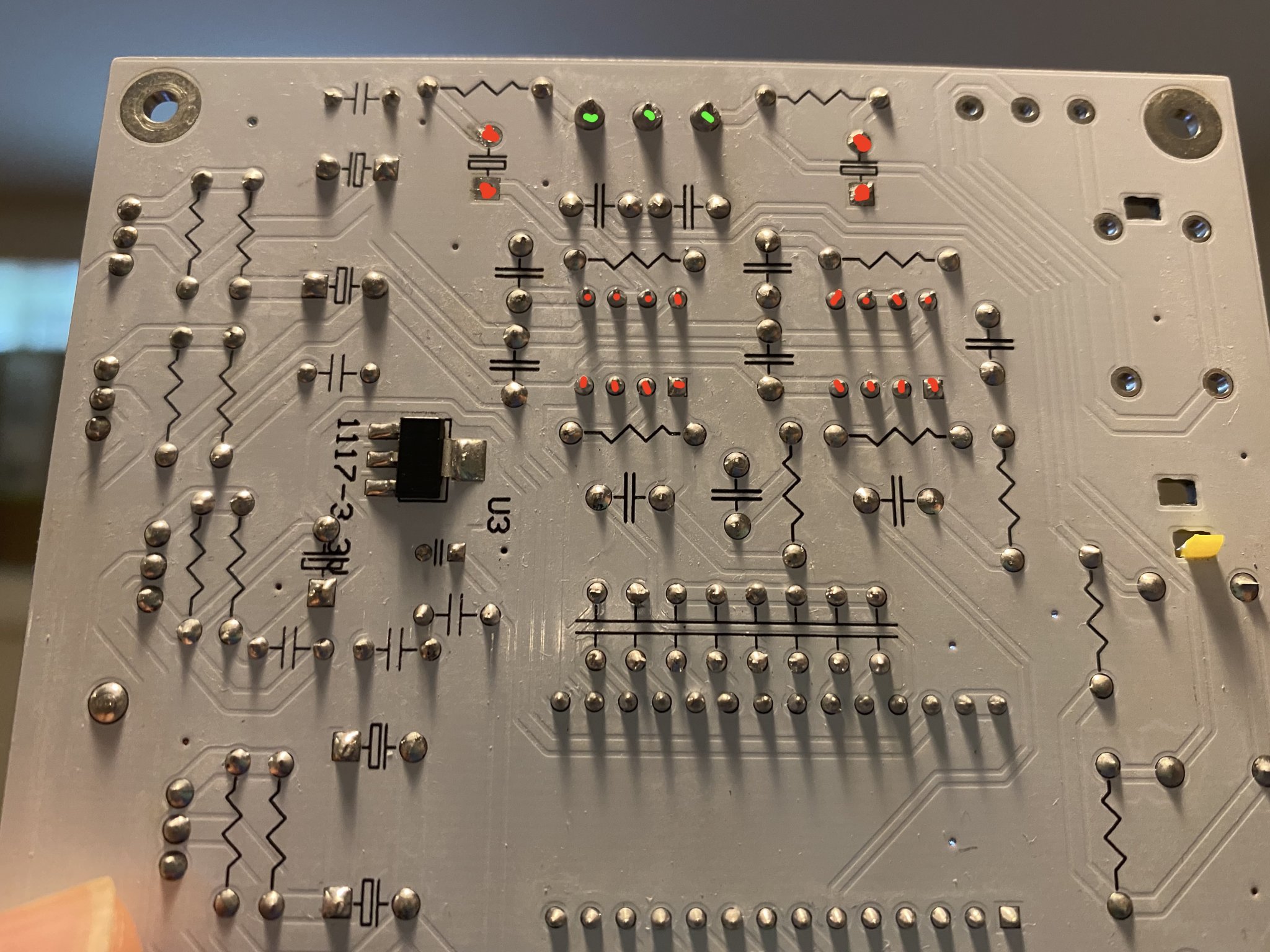

BTW if anyone is interested here is the flip side - the top two red pairs are for the capacitors and the bottom pair of 8 dots are for op-amps. The center green dots are for the terminal block which I want to remove (to make space) as it does not connect to anything - hope it is OK !
p.s. Contrary my original impression - it seems like the left capacitor is driving both op-amps and the right capacitor path is leading to the R/L RCA outputs? (3rd port is for COAX input)

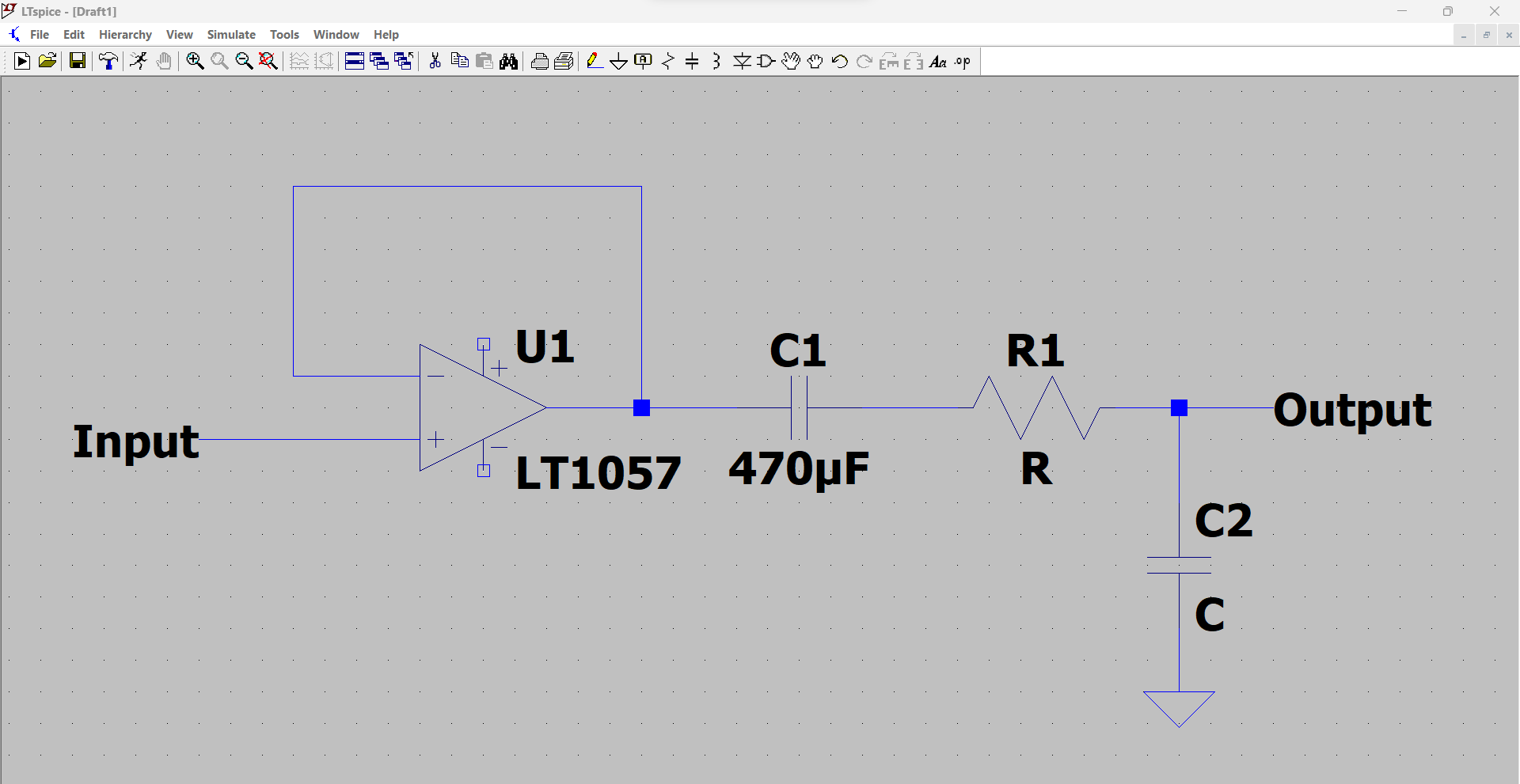

Not always easy just working from pictures but it looks pretty standard, the cap seems to go from pins 6 and 7 of the opamp (non inverting input and the output pin) via a series resistor and a cap to ground. The resistor and small ceramic type cap provide some measure of filtering high frequency noise.BTW if anyone is interested here is the flip side - the top two red pairs are for the capacitors and the bottom pair of 8 dots are for op-amps.
So it seems to look like this, a classic 'voltage follower or buffer with a voltage gain of '1'
pin 4 -15V pin 8 +15V presumably. There has to be some IC output dc of incorrect polarity charging C1 for this to fail not immediately but by erosion over time.

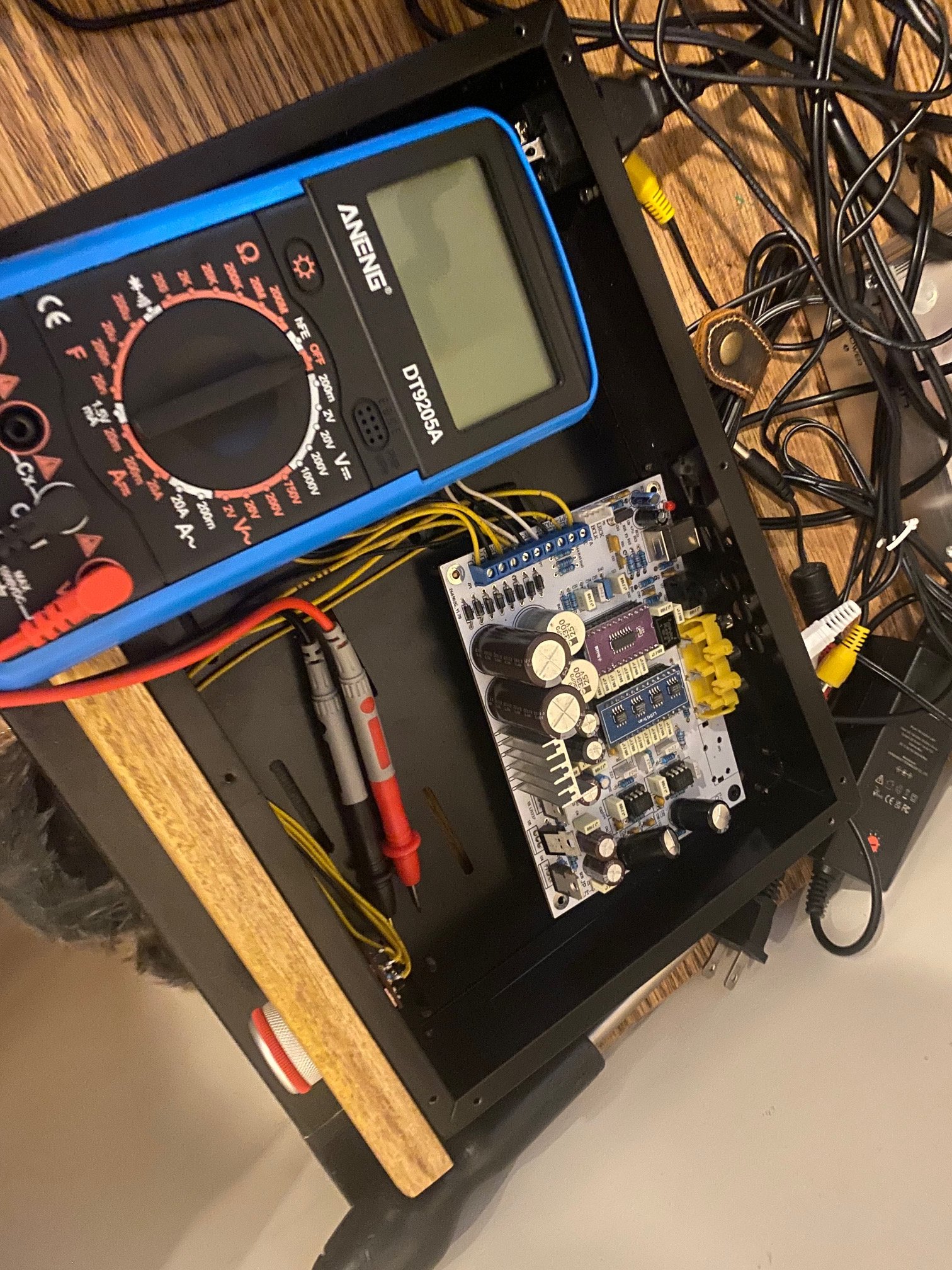

The multimeter arrived..!! And the reading on BOTH capacitors were about -3.1V with DAC powered on ! I did not measure while the music was playing though, and I could not ground the board to chassis while measuring. Note: I measured the 470uf/50V capacitors which I had soldered in, not the empty pads.
I made sure I got the red/black probes right, and even tested with the 1.5V battery to make sure - with the reading coming out at +1.2 or +1.3V.
So, the PCB must have the misprint..!? I am surprised that the music had been playing beautifully and the op-amps, DAC chip etc. seemed to be fully functional without burning out, etc.
I guess this means I don't really need to go out there and buy bipolar caps, and just go back to the original spec of 470uf/25V and I should be set, correct...? I just need to solder it "backwards"..... ?

Nothing will burn out in this instance. The capacitors are acting as coupling caps in this application. The DAC and I/V stage look to produce a DC offset of -3.1V and this requires a coupling capacitor on the output to block it. If installed with the wrong polarity the coupling cap will not be happy but for the cap to explode it needs to get hot and for that to happen current needs to flow.
First and foremost there's a hard current limit on how much can flow and this is dictated by the 5532s output and this will be short circuit limited to a few tens of mA. This places a hard limit on how much power could be fed into the capacitor and thus any internal heating caused. Also after the capacitor are series connected resistors that will also act to current limit. I am not familiar with how electrolytic capacitors fail, when connected with reverse polarity, but I'm assuming some sort of leakage current starts to flow through them and their DC resistance falls. My guess is the amplifier you're using is AC coupled, as most are, and this will protect the amplifier from any DC present on its inputs but will also prevent any DC current flowing through the input silicon and input impedance setting resistor. Therefore very little current can actually flow through the reverse biased cap and any failure would be inherently self limiting.
Looking at the PCB again it would appear that there are resistors installed already from the RCA signal pins to ground. This is going to be where a small amount of current can flow if the reverse bias coupling caps are leaky. I'm assuming that these resistors are there to keep the outputs of the DAC very close to ground potential, as they could otherwise float up given the DC biased outputs with nothing connected to the output of the DAC.

I think all has been said above. New caps and fit them to suit the actual measured voltage and you should be good to go.
