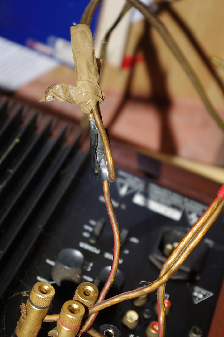

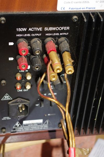

can one of you gents help a geriatric out please because something's not right
pictured are the rear connections from the Lumley handbook -
the rear of my Sonus Fabre speakers (connected)
the rear of the Lumney monoblocks (connected)
and the Lumney schematic diagram (dont know where I got this from so possibly not 100%)
these monoblocks are not sounding as they should on the speakers - new valves all round

You appear to have a 4ohm speaker attached to the 8ohm connections.
thank you very much for that
Definitely wrong output tap selected.
I am unsure of what you are referring to here - sorry
so I swap the red and orange pair from the third top row connector to the first one ?
and on the monoblock I would have thought the wires should not be paired but use 4 of the monoblocks connections - i.e. post 1 & 2 on top row and posts 1 & 2 on bottom row - please tell me why that is not right - thank you
Yes.dewi said:so I swap the red and orange pair from the third top row connector to the first one ?
I would have thought so too. However, paralleling the cables on the outside of the amp will not be much different from paralleling on the inside.and on the monoblock I would have thought the wires should not be paired but use 4 of the monoblocks connections - i.e. post 1 & 2 on top row and posts 1 & 2 on bottom row
Yes.

Four ohm speaker connected to eight ohm output tap on amplifier. Same thing DF96 pointed out.
