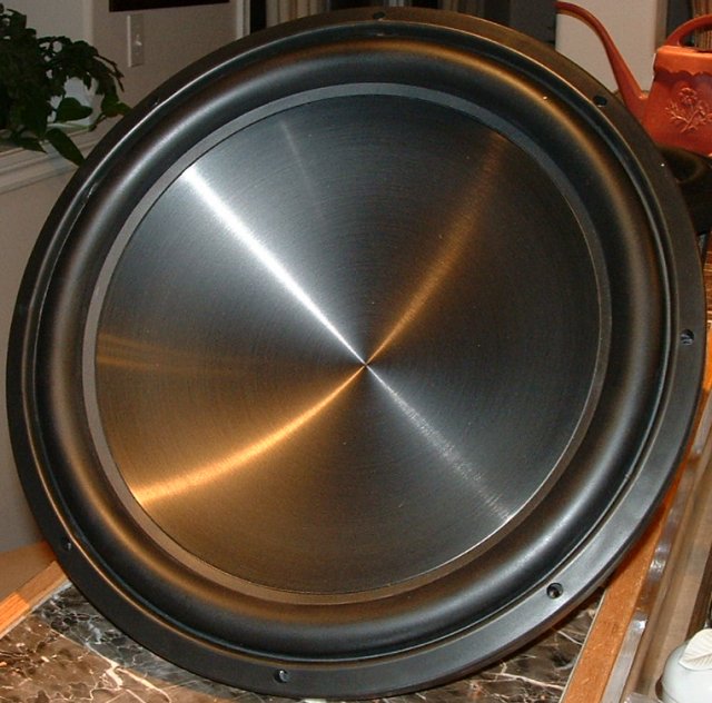

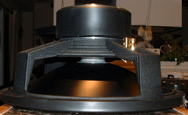

The TC2+ 15" drivers arrived...
just a couple of pics...

So i did manage to get one woofer installed tonight and i had a quick listen in my soon-to-be-functional home theater (with a vastly underpowered amp). WOW - i was very impressed! I can't wait to get the other one done and finally get the theater finished!
I'll post more pics shortly...
