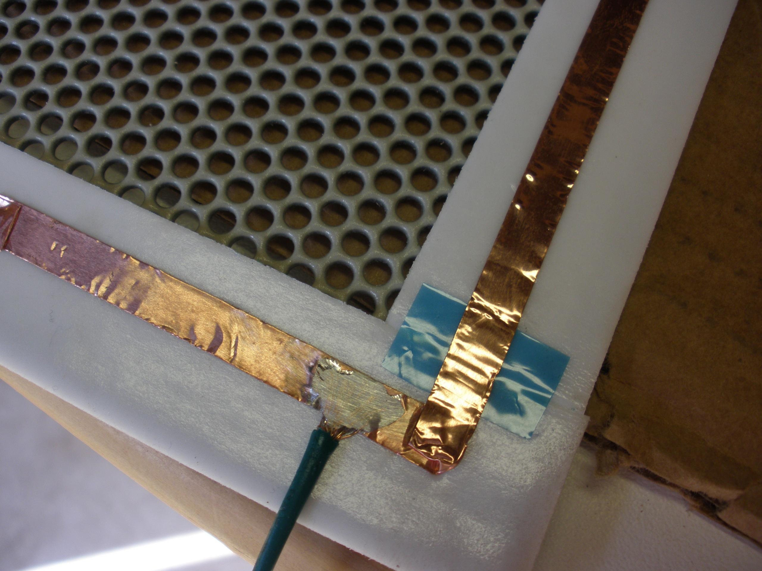

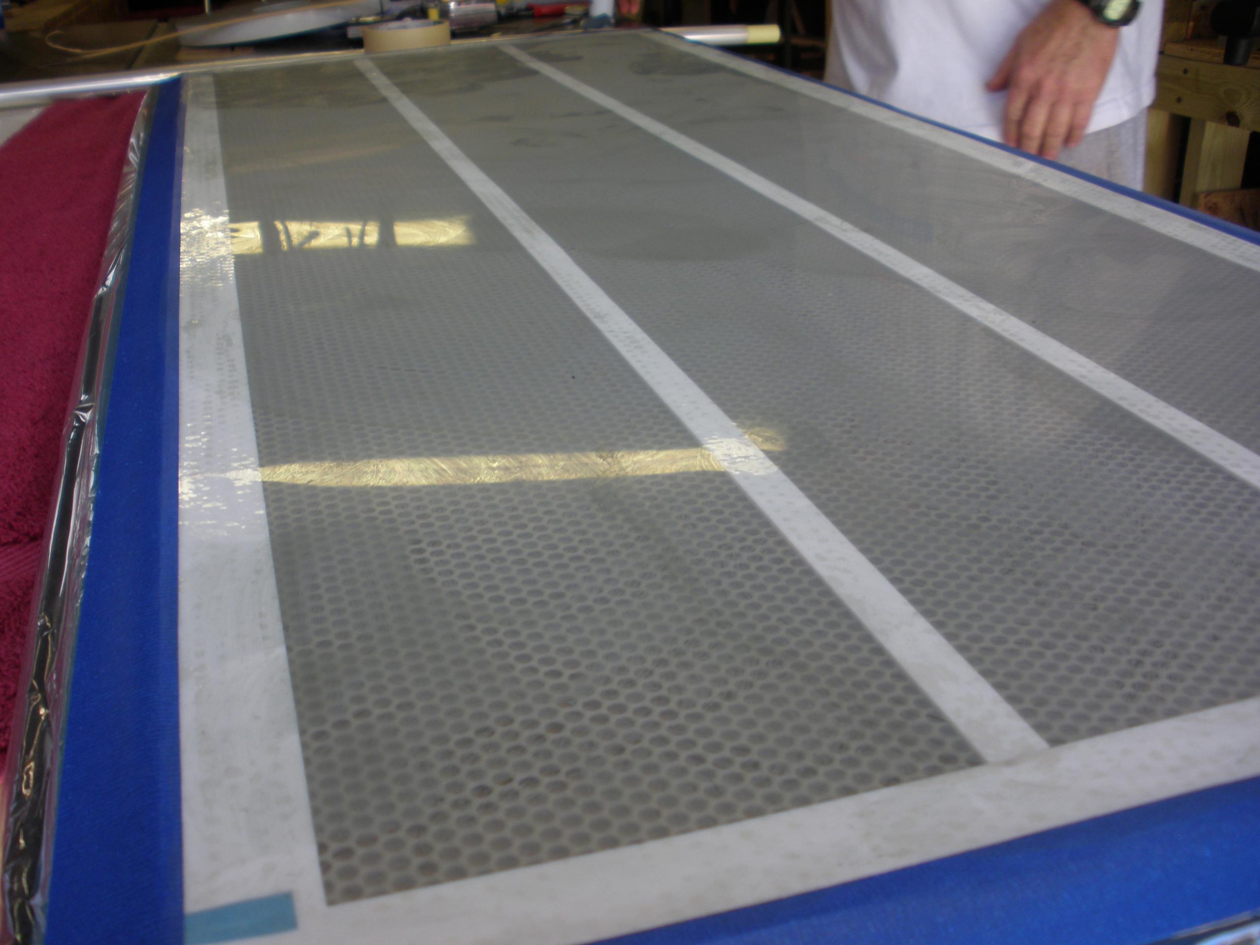

Hi CharlieM,
Thanks for sharing the photos. They explain a lot. 🙂

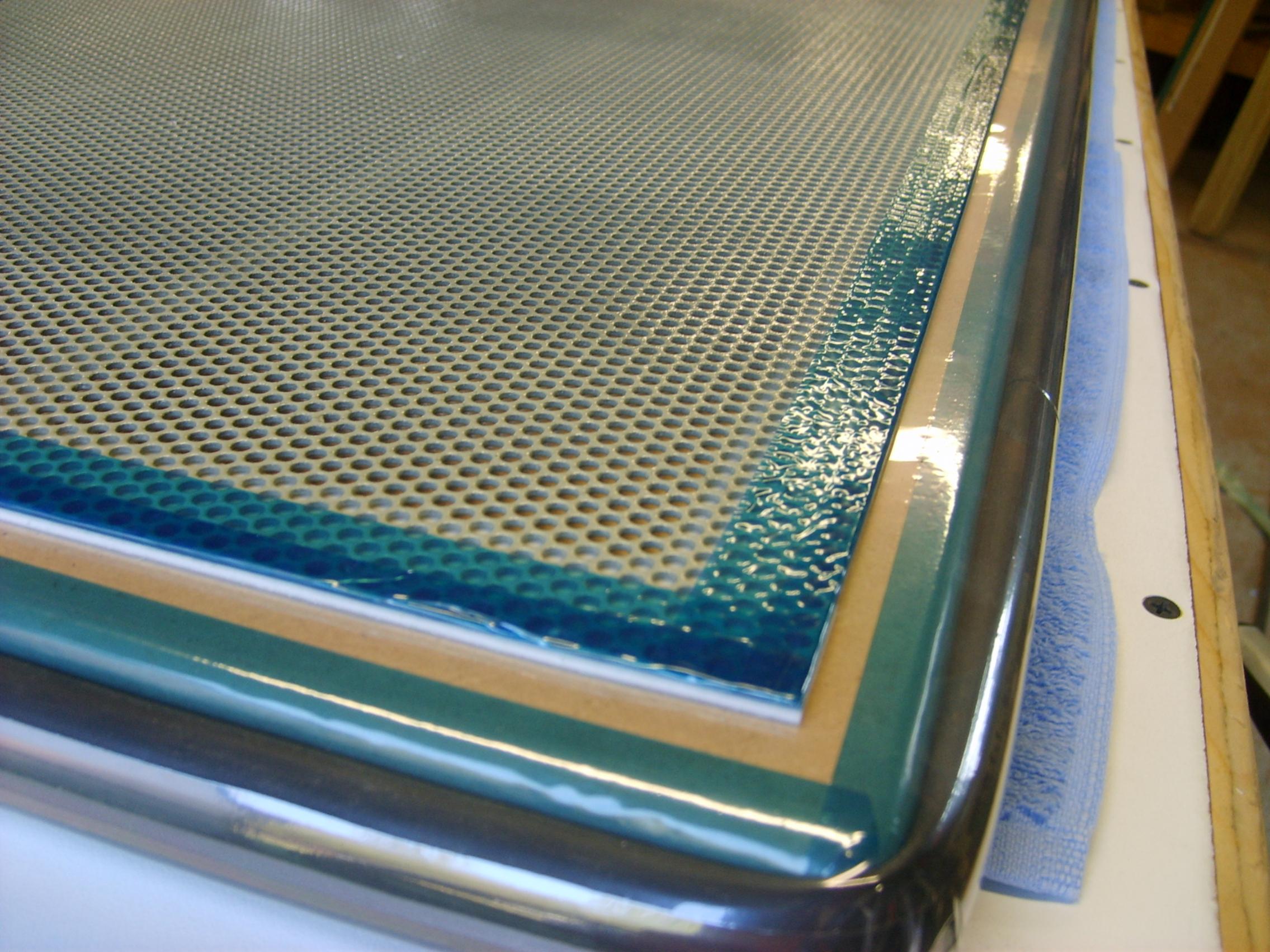

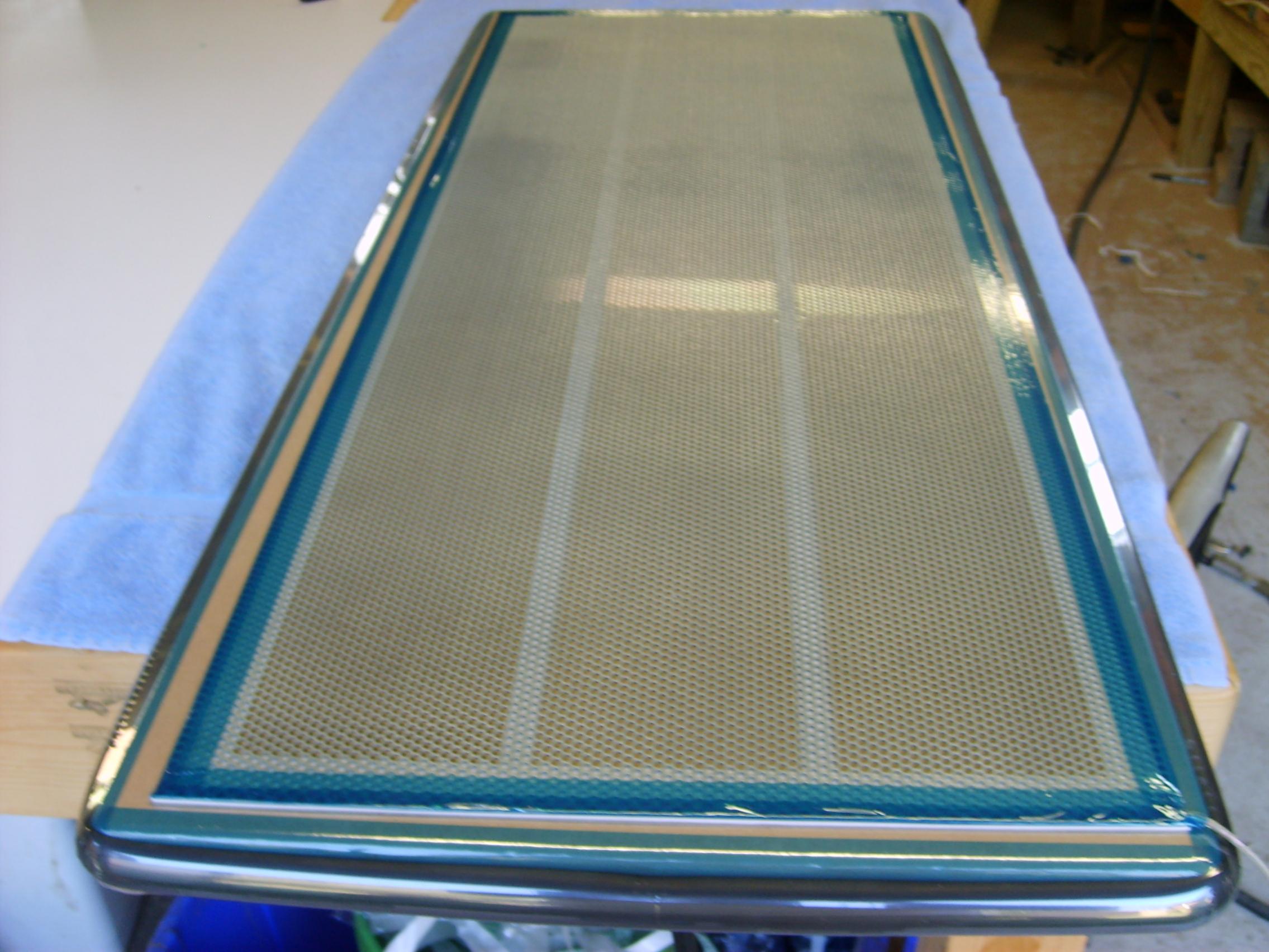

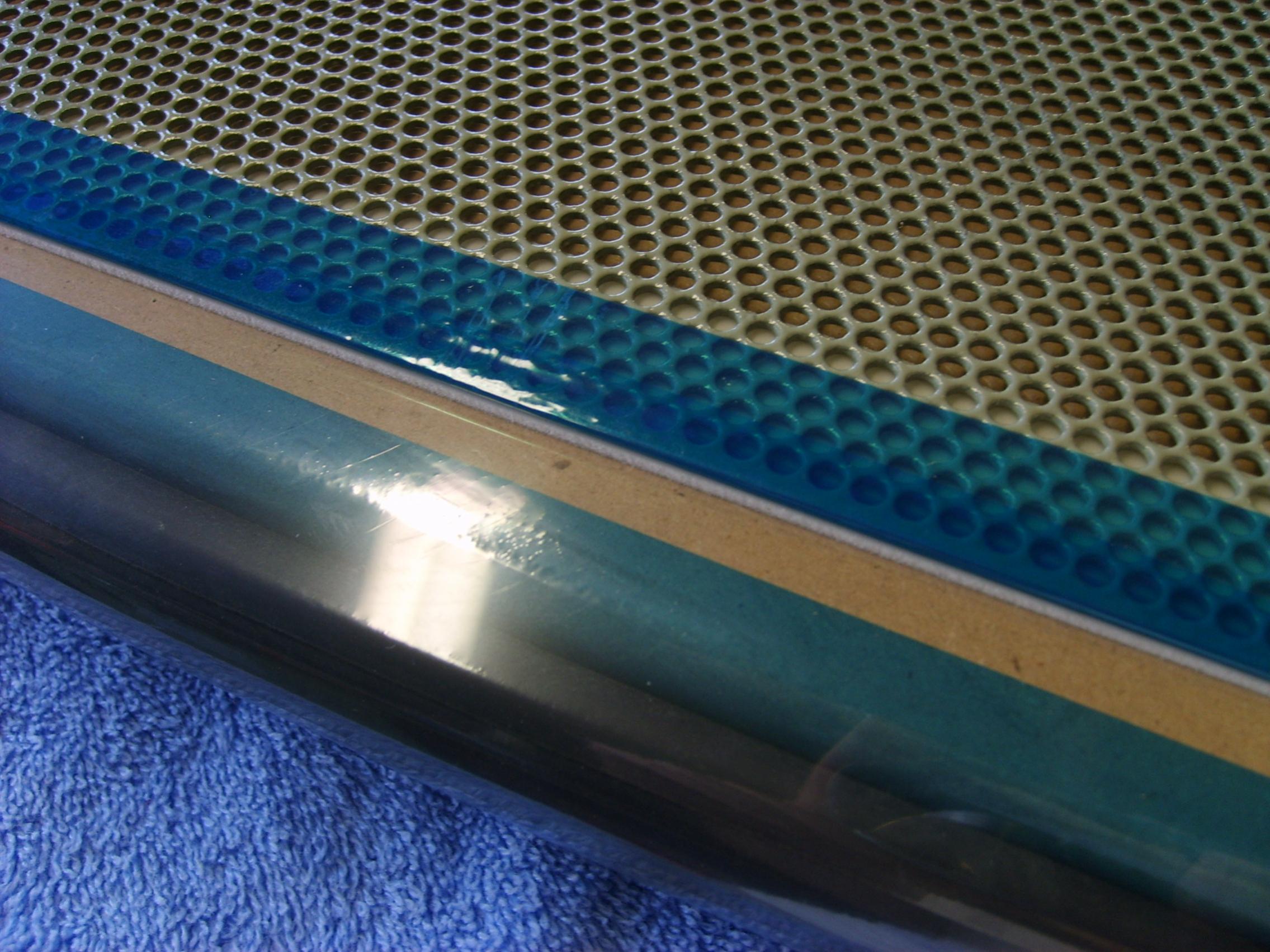

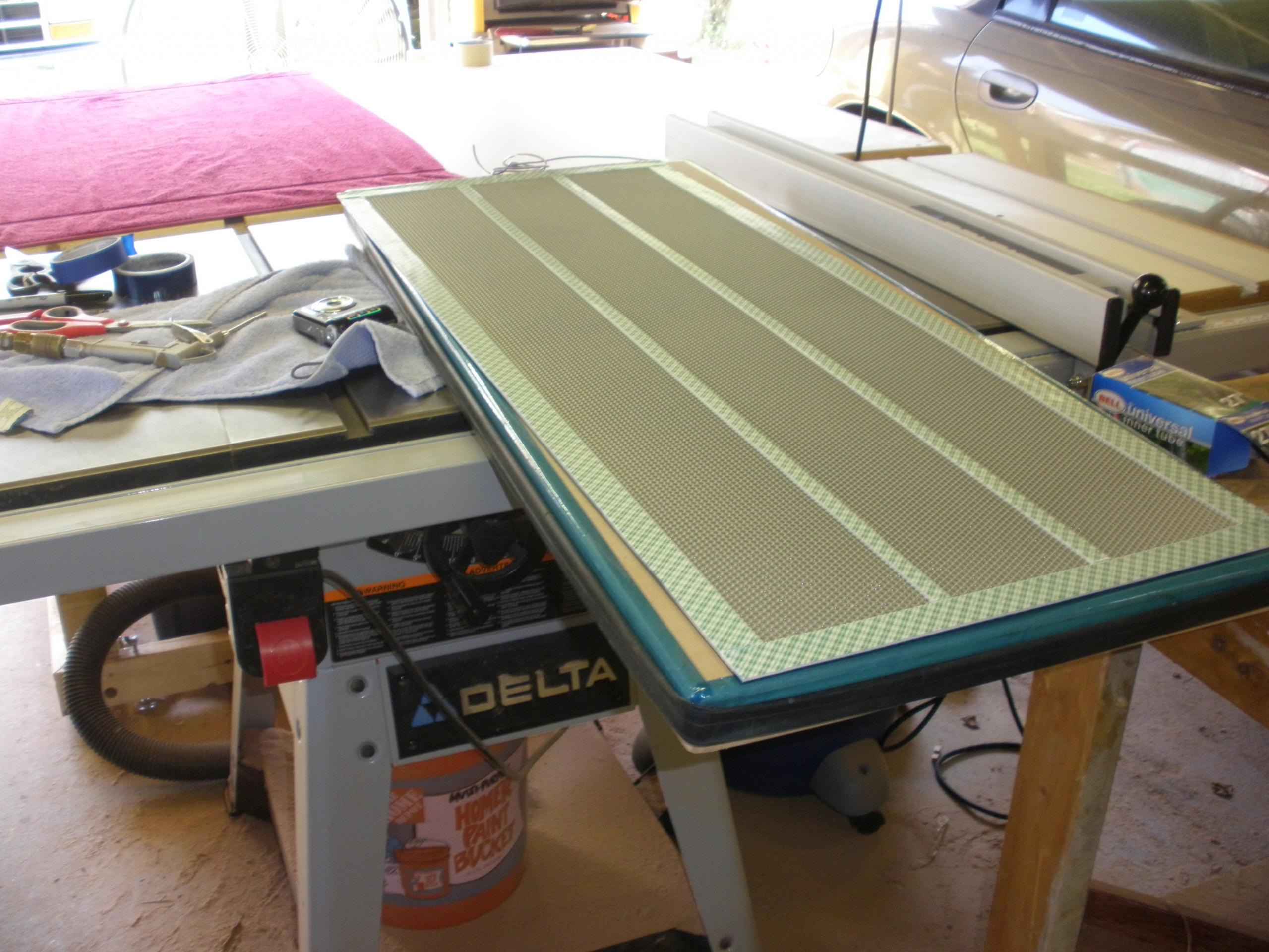

By the way, why do you put the blue tape all around the corner of the stator? Do you intend to prevent the possibility of arcing? Does it work? What type of tape is it?

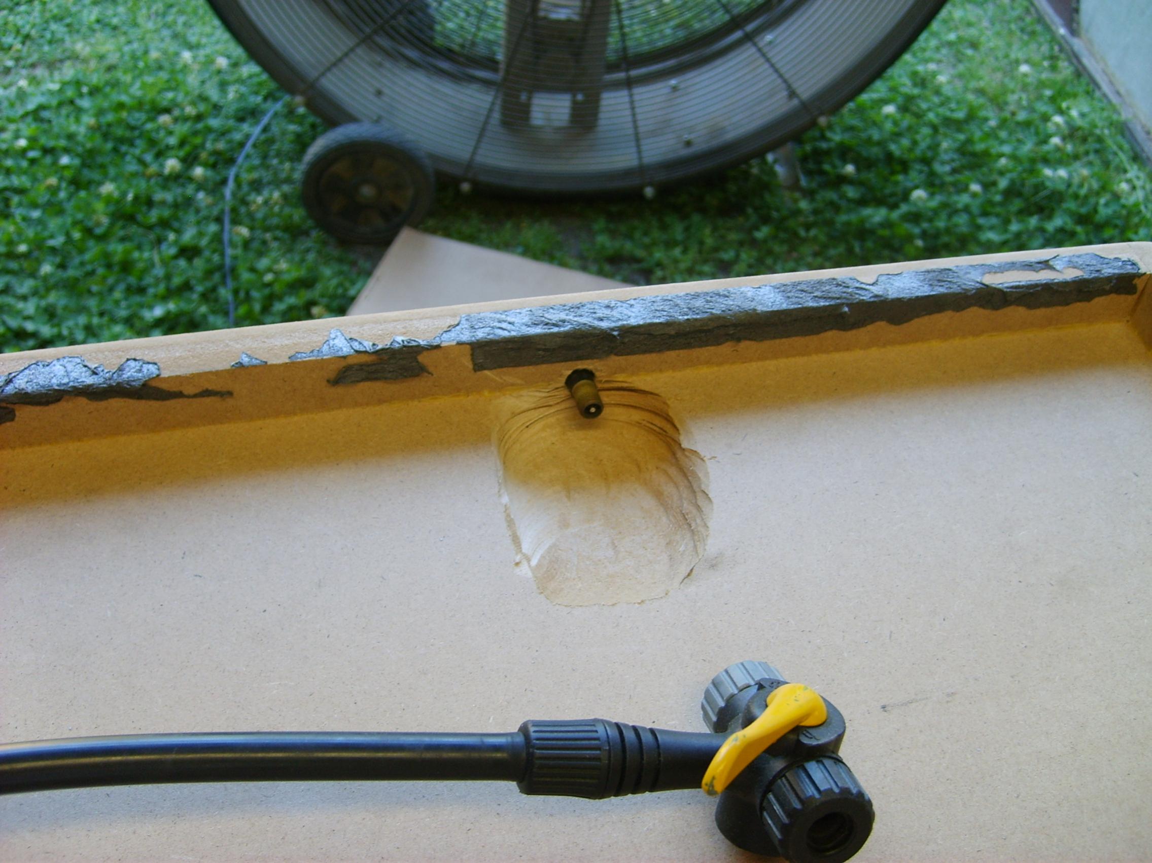

I believe it is to keep the area very smooth as you inflate the tube, makes your heart race a bit, but to insure there are no jagged, rough edges around the diagphram. he made it look so simple, i know there was trial and error, because this worked perfect.
build it, try it. you have the material in Thailand, somewhere. hope my interpretation makes sense.

The tape is 2 mil polyester packing tape and it's wrapped over the sharp edges of the stators to prevent arcing.
