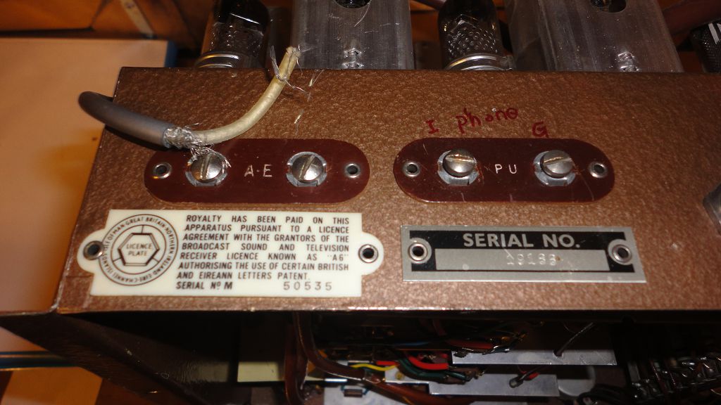

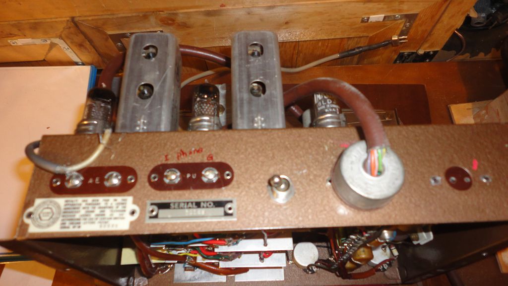

For further information I suggest you try the UK Vintage Radio forum. Some people on there are experts at identifying this sort of stuff.

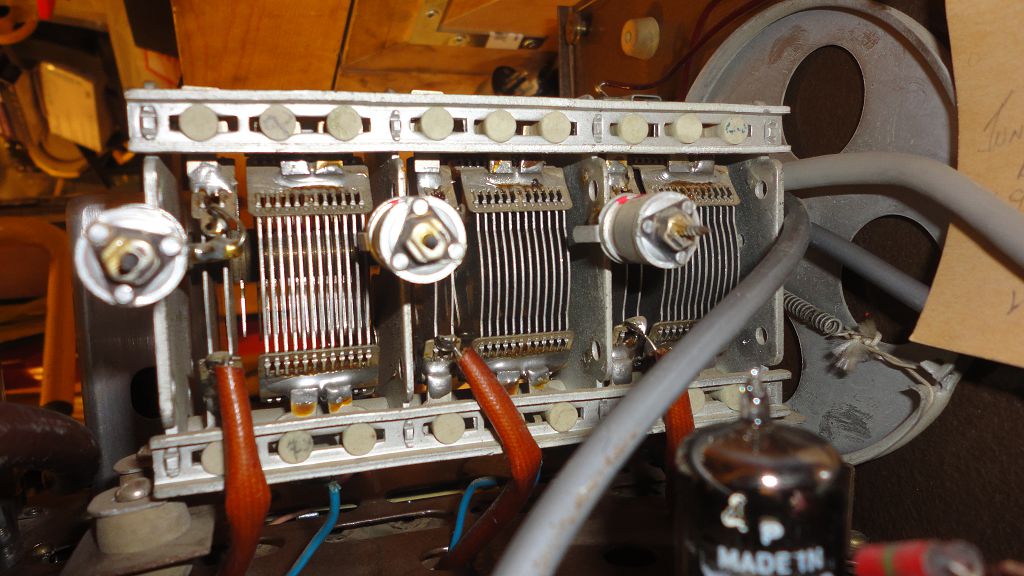

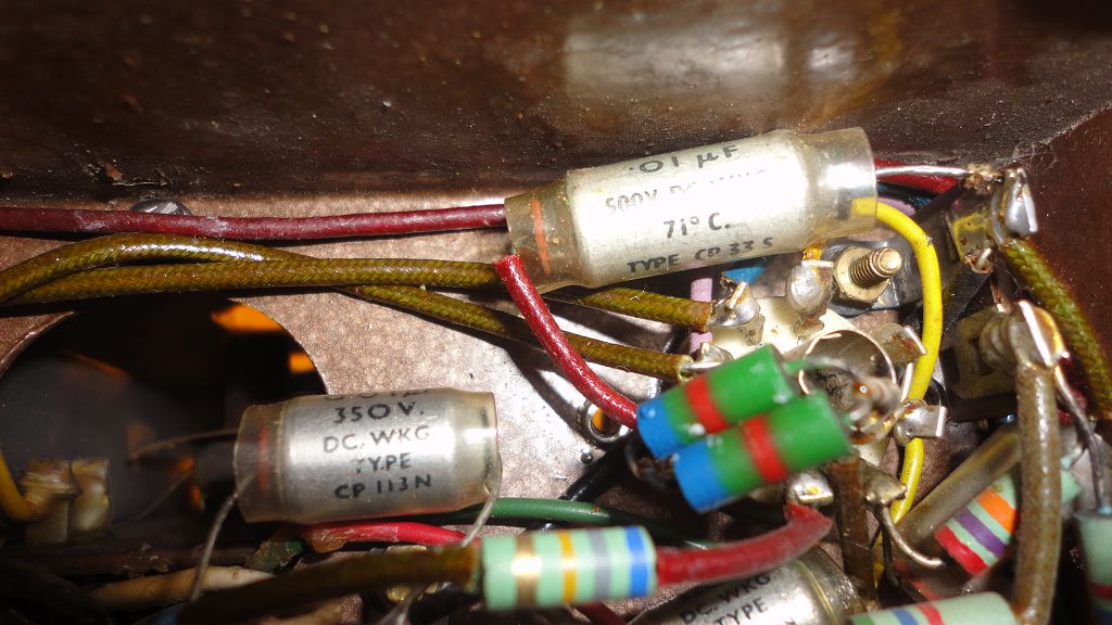

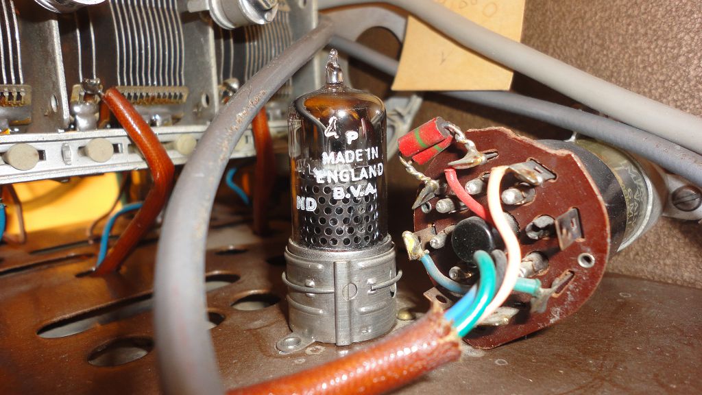

One curious feature I noticed is that it uses beehive trimmers; compression trimmers were far more popular in domestic equipment. Also, the tuner seems to use 'octal sized' IFTs with minature valves. This may help date it.

I already tried there
Need identification for Heathkit radio - UK Vintage Radio Repair and Restoration Discussion Forum
No further discussions after March 15. I might be in wrong section in the UK forum.

Suggesting it might be a Heathkit in the title over there could have restricted replies. You could ask the mods to change the thread title.

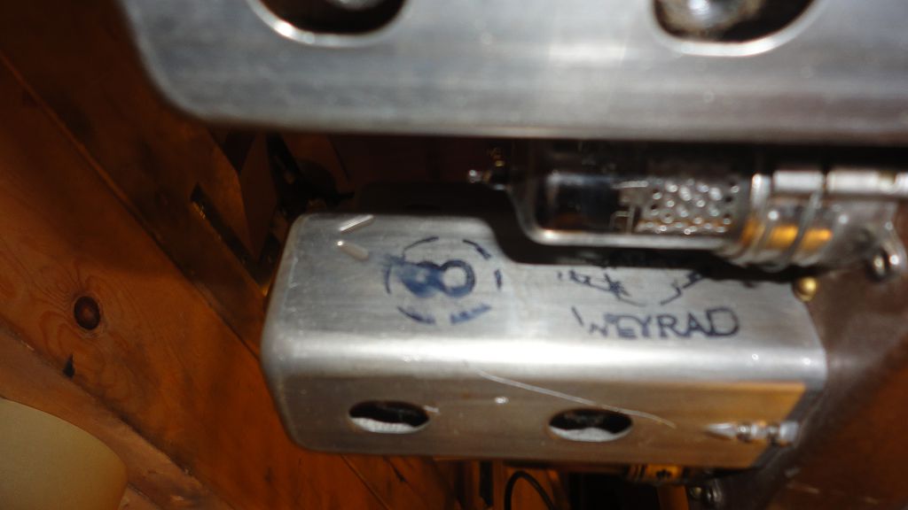

IFTs from Weyrad might narrow it down. It could be that the whole coilpack was from Weyrad - it certainly seems to be a separate component from the main chassis.
