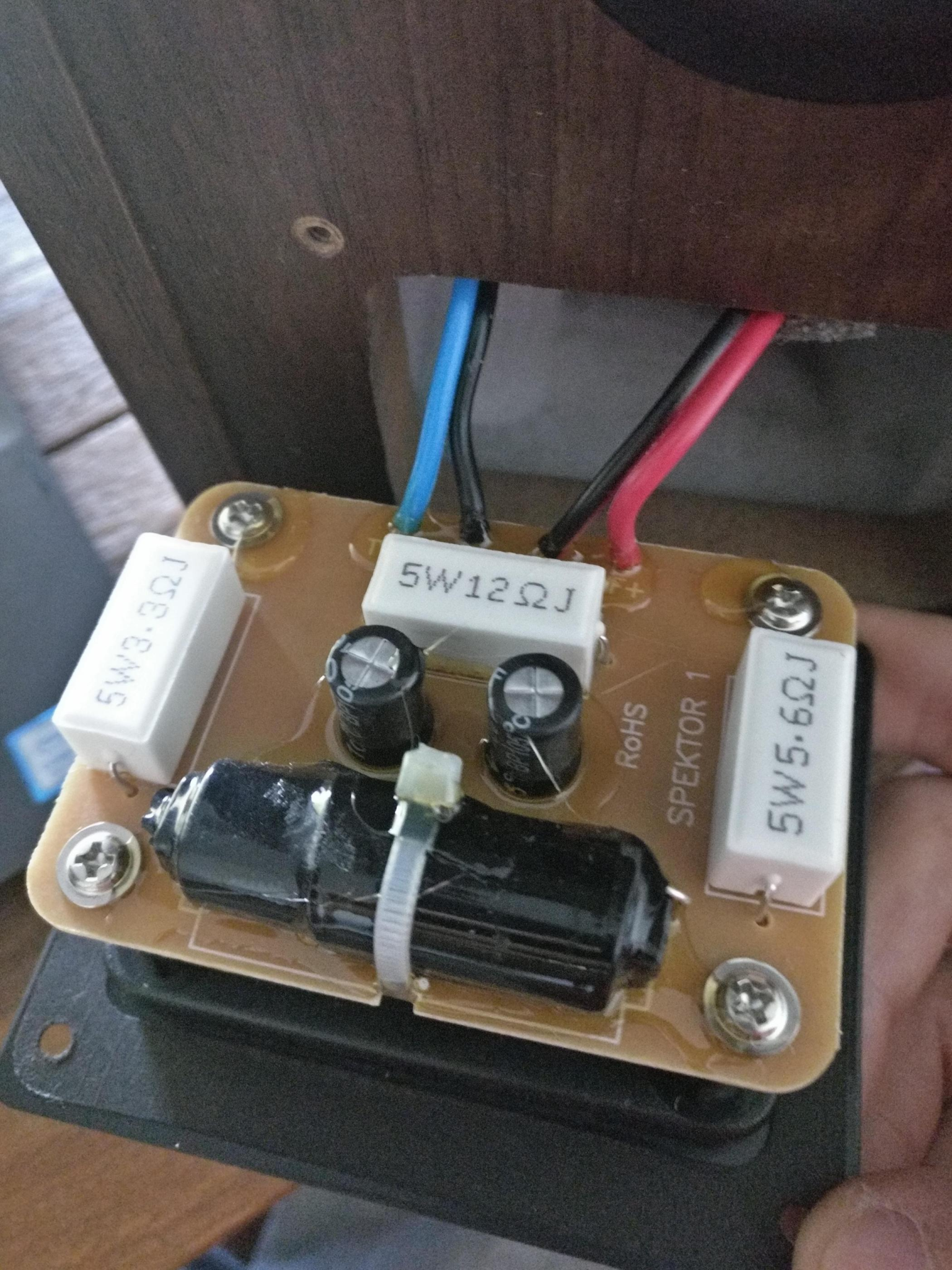

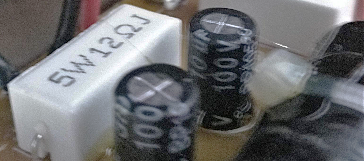

I need some help to identify the inductor value in my Dali spektor 1 crossover circuit.
Also I like to know order/type of the crossover would also be appreciated?I will attach some pics of the crossover.Any help is appreciated 👍

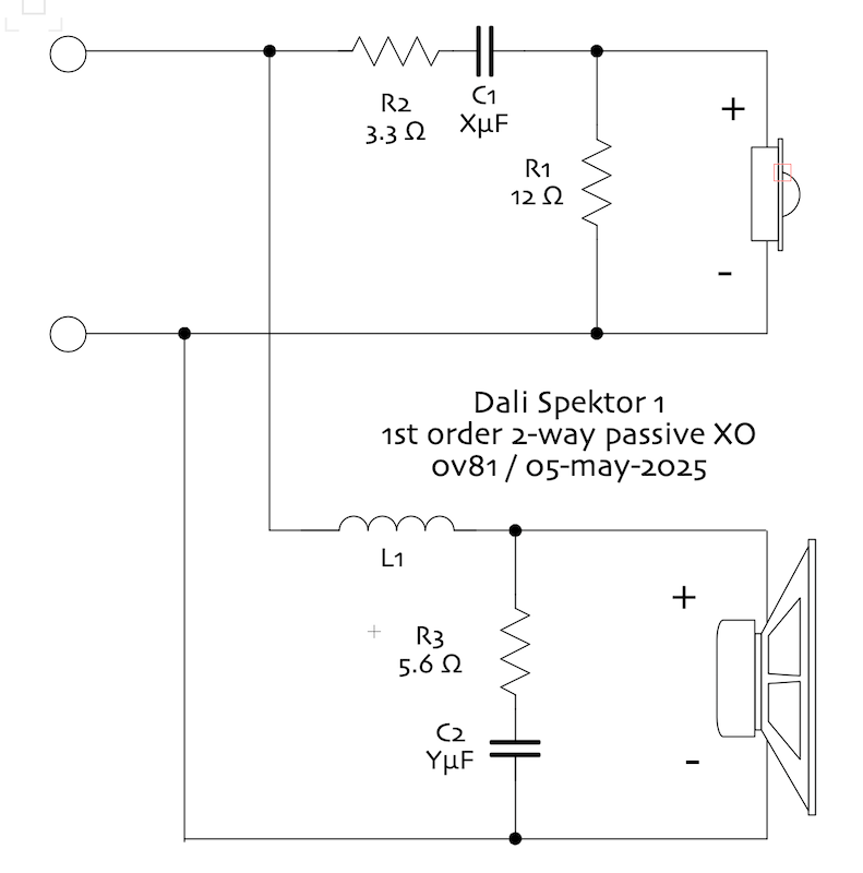

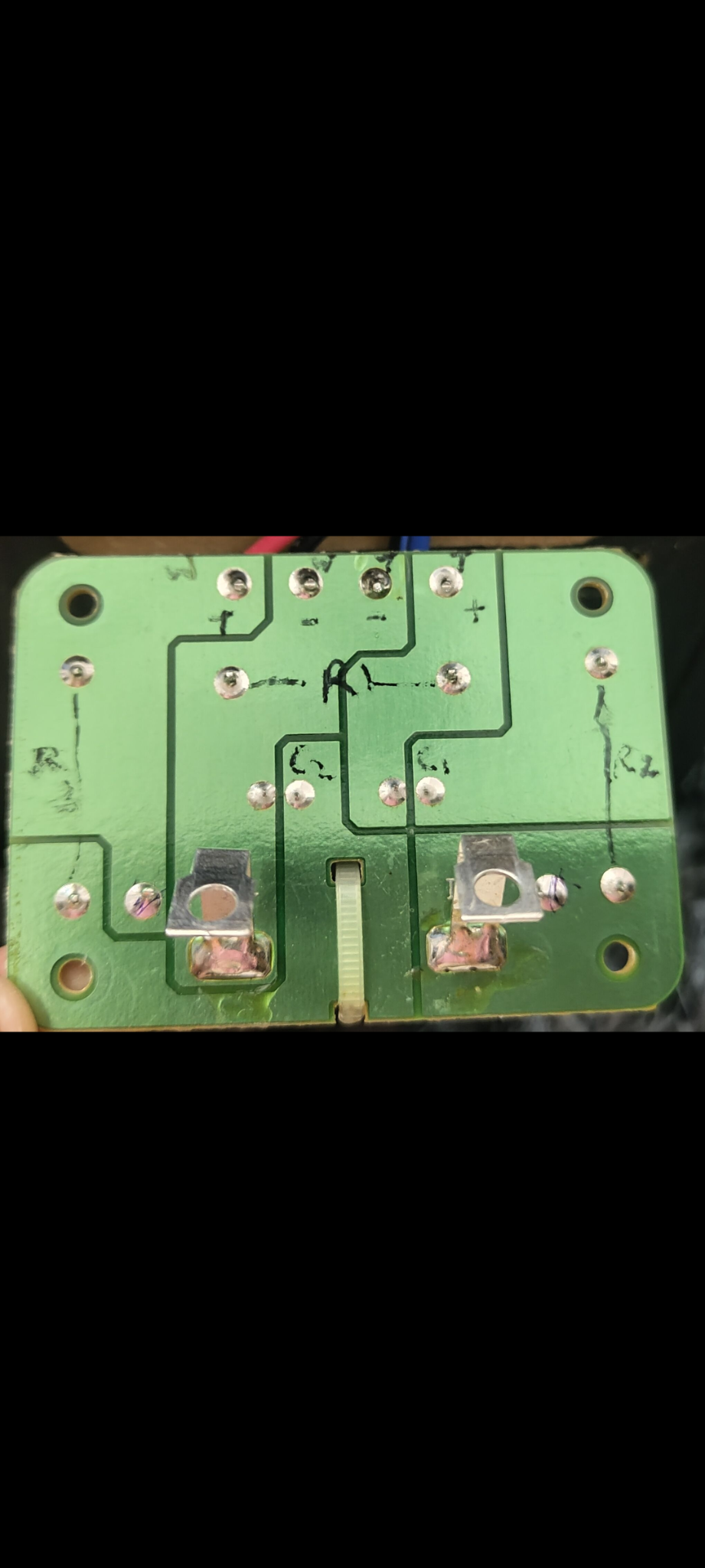

Is that the entire XO? 2 Cs, 3 Rs, 1 L. What does the trace side look like? Where do the wires go?
With only 4 wires evident, i would guess this is the tweeter XO. 3rd order with an L-Pad?

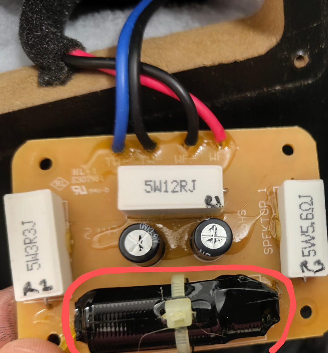

You would need to measure the inductor. You mght have to pull one end out to do that.
dave
So the input is direct to the PCB.

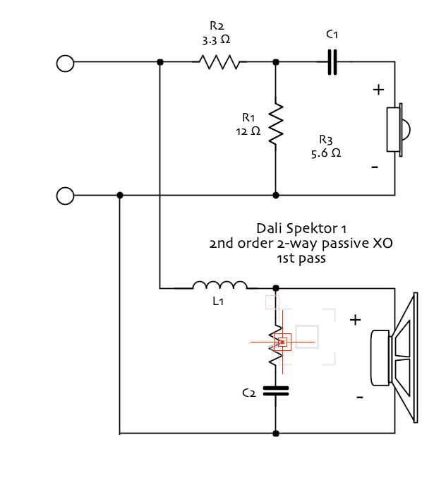

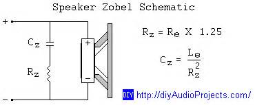

So if we need to use these bits to make a 2-way XO, i’d guess 1st order with an L-pad and a <filter> out of the spare C & R. But it could be a zobel on the woofer.
Looks like blue to the tweeter, red to the woofer?
dave
If the tweeter is 8 ohm, that would tally with a 10 uF series capacitor.
It is usual for the woofer in today's small bookshelf speakers to have a 4 ohm DCR, so I would guess that L is probably in the order of 0.30 mH.
Obviously the exact value would have to be confirmed by measurement. Digital LCR meters can cost less than ÂŁ30.
P.S. I have undertaken a thorough internet search, but could not come up with a published figure for the inductance.
P.P.S. New member judson1988 should be aware that changing crossover components for different types can actually make a speaker sound worse. When 'upgrading' a crossover, it's best to modify the crossover in just one speaker first so that comparison can be made with the unmodified speaker.
