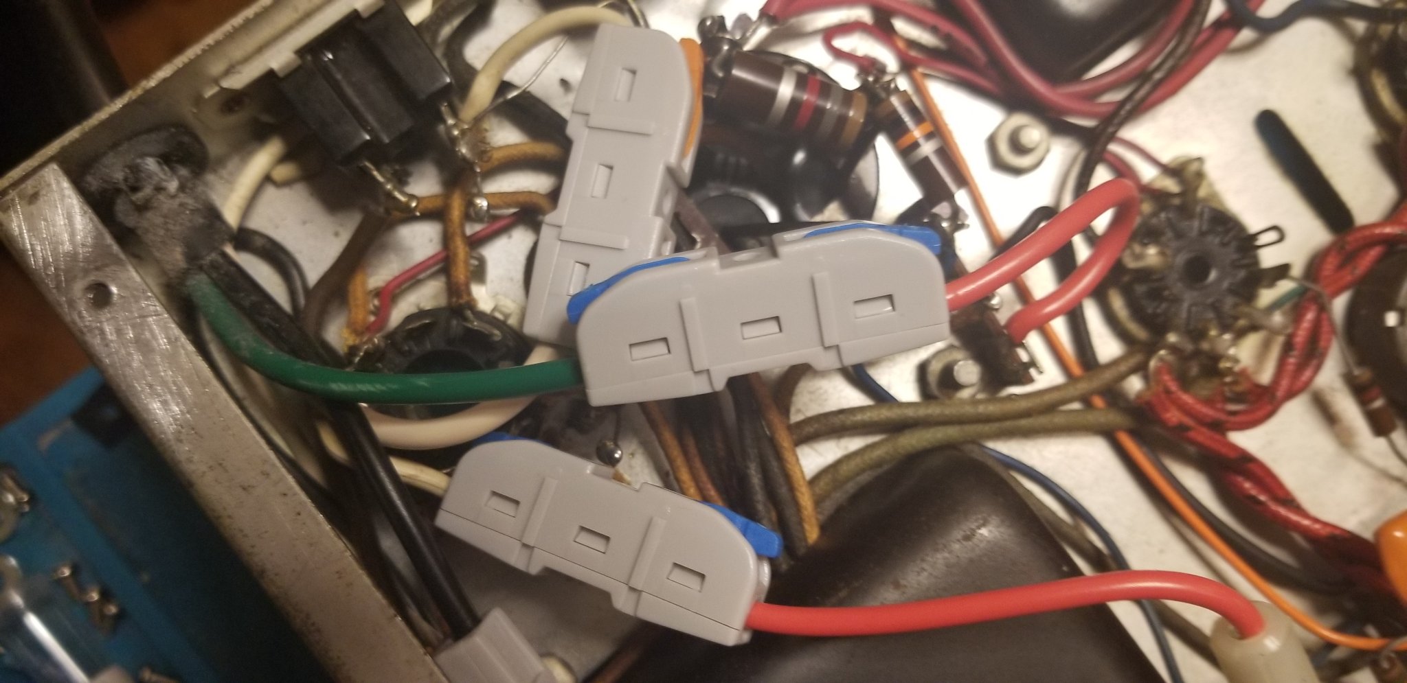

Thanks for the reply. While i wait for some new aux sockets for the back I'm going to do most of the work using these connectors so i can test the amp then I'll solder everything in permanently. I also removed the death cap though the image still shows it.There's a good reason that's called a "death cap". Ditch it.

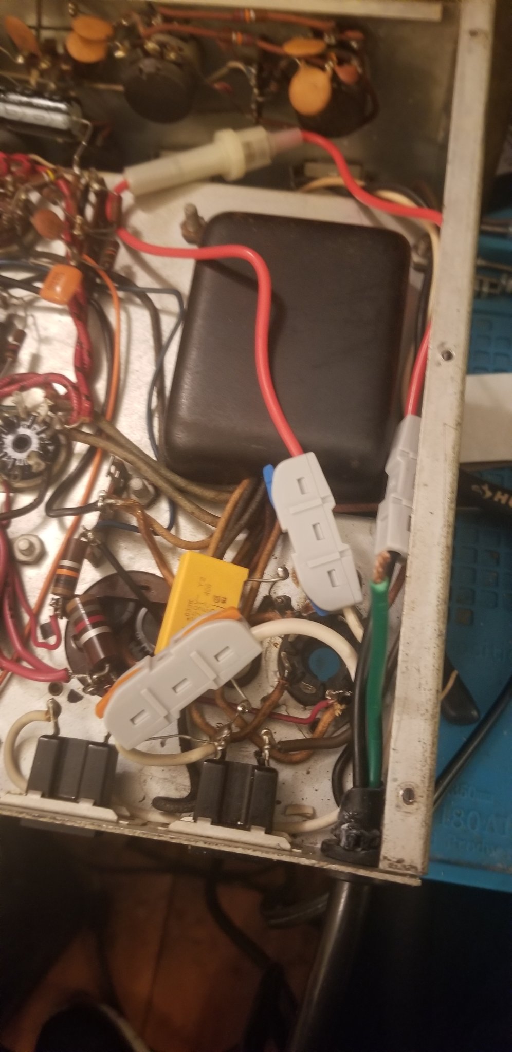

I did not use an IEC connector as my chassis is to thin to fit one even without a fuse integrated. So I wired a IEC compatible cord directly into the chassis with a rubber gromitt and stress relief. The ground is soldered to a terminal strip which is sucured to the chassis by a nut and bolt from the transformer mount. I placed an inline fuse from the hot wire in to another terminal which then goes to the switch, transformer etc. The neutral is attached to the aux sockets on the rear of the amp which is used as a terminal point then to the transformer. I will remove the temporary connectors when I get the new polarized chassis mount sockets. I figured I might as well replaced the old non polarized ones so they will be compliant if I ever sell the amp.The IEC safety ground should be a wired direct connection between the IEC connector ground pin and a solder lug

Already there, look at the first pic and follow the red wires up to that top of the pic and you'll see the inline fuse with a 3a slow blow fuse.However, an AC line fuse (properly sized for the equipment) is also necessary.

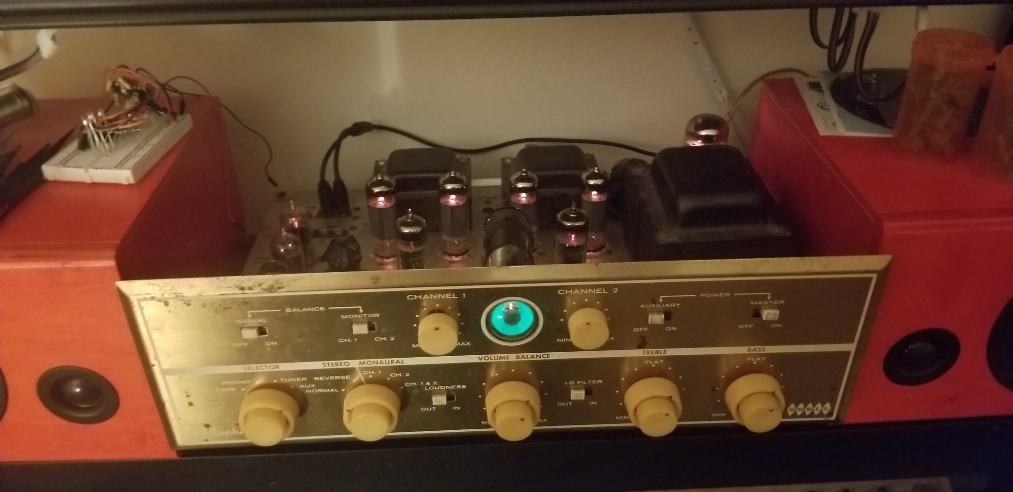

I gotta say this is a sweet little amp, ahead of its time i believe. 20 watts per channel with outputs for 4, 8, 16, & 32 ohms with a binuaral rca output you can use for a subwoofer.

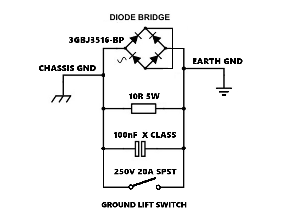

Looking at the schematic that fat ground bus looks like it is not attached to the chassis, but you'd have to verify that in the actual construction. So the above ground loop breaker might be good to add, ground that fat ground bus to the ground loop breaker not directly to the chassis. Then check that the input/output jacks are all floating from the chassis. If not then replacing all the jacks with new jacks isolated with nylon washers would be a good change too, really bring it all up to date! So the circuit ground and the safety ground are separated by the above loop breaker, anyplace they grounded the circuit to the chassis should be to the circuit ground. Only exposed chassis is safety grounded, bell housings, pot shafts, etc. Anything having to do with the actual circuit then grounds to the lifted circuit ground, (that might only be the input jacks if you're lucky). If it's a sweet amp all worth the work. But if it doesn't hum using the outlet it's plugged into now, at least you have a safety ground if you do nothing more.

For me, this is a must done for any amp with 3-prong plug.
There is no need to do obtrusive "ground lifting".
