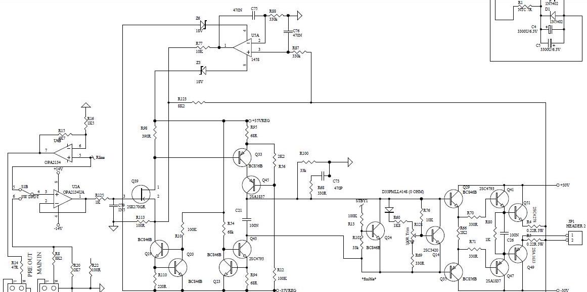

I`ll post the schematic for the right poweramp later. (on different pc)

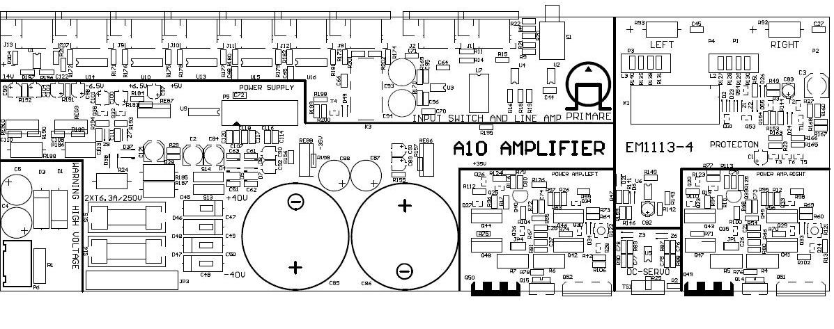

Here are the schematics for the right poweramp. And also an overview of the main pcb.
I noticed earlier that the output devices in schem. are 2SC4278 and 2SA1633, but in my amp they are 2SC5200 and 2SA1943. It doesn`t look they have been changed though. 😕 I guess the Toshibas are better though.. 🙂
There is another thing I find odd, Q14, 2SC3420 connected to the pcb via cables, is mounted on top of Q51, 2SC5200, effectively using it as an heatsink! Now that can`t be a good idea, can it?
Bjørn

From technical guy (paul),
Had a primare a10 in for repair with a report of "no audio".
closer investigation i found 'speaker protect relay not being switched ,due to one of the regulater i.c,s had failed. The minus 35volts was low at approx 15.5volts--(reg8),a type :ka337 3 terminal 1.5 amp ,adjustable regulator.
Not sure if the crackling/popping noises are directly related to one of the regulator devices failing,found that there are : plus 5 volts,plus 6.5 volts,minus 6.5 volts,and plus and minus 35volts---derived from lm317t/lm337t type regulators.
I also have known the metal can type smd electrolytics to physically leak electrolyte--BE VERY CAREFUL WHEN DESOLDERING SMD COMPONENTS,AS THE PCB AND NEARBY COMPONENTSCAN BE EASILY DAMAGED.
From close inspection of the pcb,there is around power amplifier/protection a few metal can smd type capacitors--47uf 50v and 3.3uf 50v by protect cct,and 1uf 50v and a 3.3uf 50v by d.c./servo i.c.'s next to driver transistors.
hope this may help.
Q14 is the bias current temperature compensation, so has to sense o/p devices.
replace R121 trimpot anyway, but measure voltage across R4/R5 first to check bias current.
also meter DC volts across the output when fault occurs: may help determine if DC or ACsignal faults
