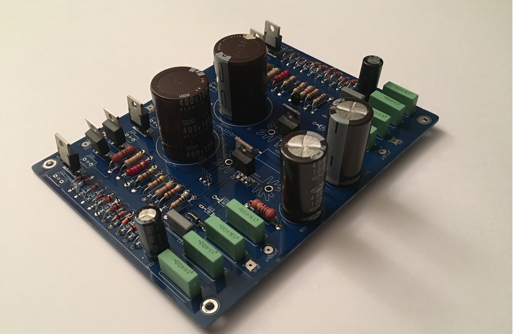

Help needed on Regulated power supply on Class A 6L6 amp
Just to add one more info
this is a pcb of the circuit I post earlier . two channel indipendent
If the currentwise the entire signal variability would be stuck on the power supply, than where does the current that drives the loudspeaker come from?
I think you overlook the role the output transformer is playing in this (storing and releasing energy with signal).
