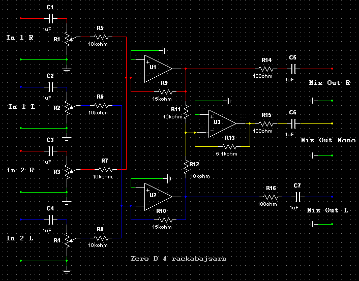

Okay guys, I breadboarded the mixer and I'm sad to say the difference between the .1uF and 1uF is pretty significant. It sounded much warmer and deeper with the 1uF, so I guess I'll have to resolder the caps... Though it might be a bit easier than I thought, so that's positive at least. I also changed the gain by replacing the feedback resistors, 68k instead of 39k, and 10k instead of 5.1k. The level sounds fine now. Thanks for all the help, it seems I can finally put this part of the project to rest

I tried out 2.2uF caps as well, could not really hear any difference there, so I'll go with the 1uF's. Especially since resoldering the resistors as well would be really boring.

Family's asleep now, so I couldn't test it out too loud. But the gain is much better now, hardly had to turn the knobs now, compared to before when I had to turn them almost all the way.
