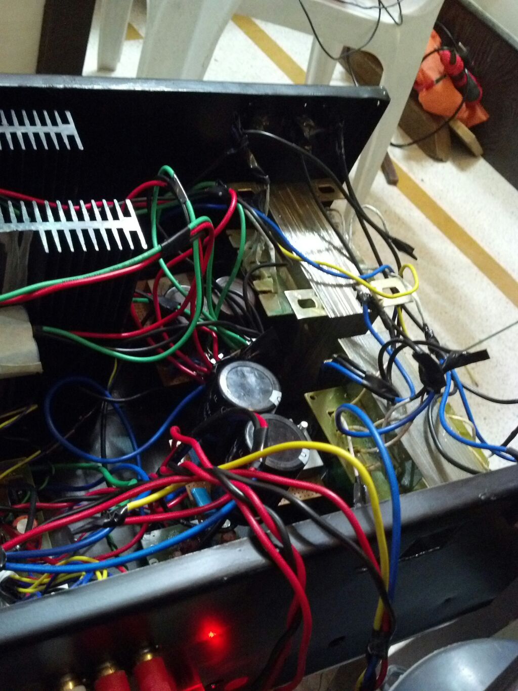

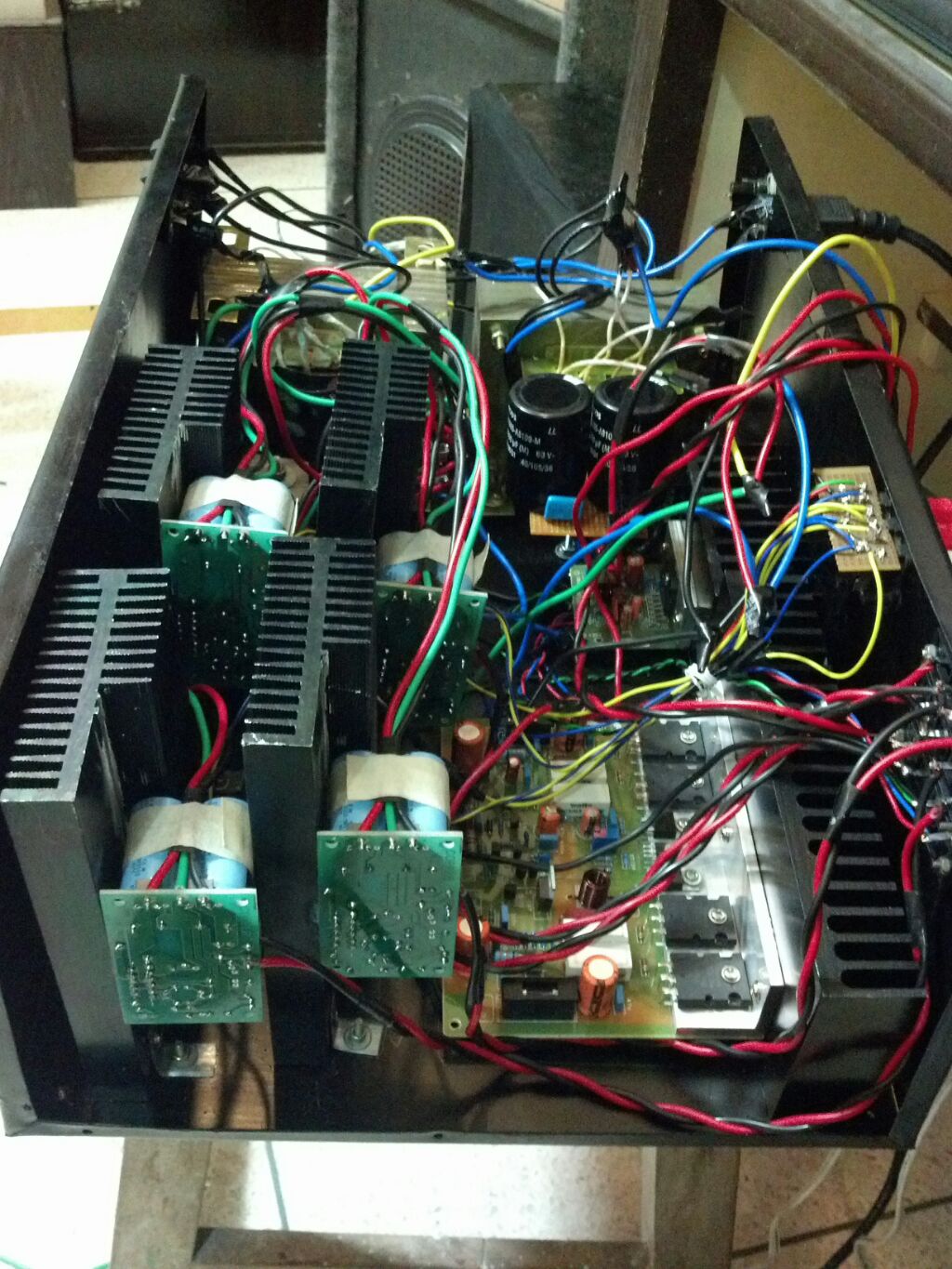

I have connected all the LM3886 with 24-0-24 transformer while I was assembling the project in the cabinet. Tested the current without input/output and everything seems fine. Built the same PSU on a PCB.
PSU contains - 2X10000uf, 35A bridge rectifier, 2 X 0.1uf. I have another set of same components which I will be using for the sub.
Now sub amp is left. Will also add speaker protection module with the sub amp. I will use separate 23-0-23 transformer with separate PSU with the sub amp. That transformer also has 18-0-18 provision for the sub crossover.

Done :
No ground loop, no humming, no kirr-kirr, just clean sound.
Thanks to all of you, without your help it wouldn't have happened. It was an really nice experience, learnt lot of things.
Special thanks to Rakesh Sharma ji who kept helping me over the phone during initial days when I had lot of confusions and I wasn't getting the things by reading.

Good to hear that you are happy with your build.
Few things like to add.
Dont use electrical insulation tap over wire joints, Insulation tap will come off after some time and may result in short circuit ..
Instead use Heat-shrink Tubing.
60 pcs Heatshrink Tubing Thermal Shrinkable Shrink Tube Sleeve of 1mm 2.5mm 5mm | eBay
also after finishing try to do some wire management.
Thanks for the tip. I was also concerned about using insulation tape. Now if I plan to add these tubes then I will have to cut all the joints, isn't that? I have soldered all the joints so it will be a pain to cut and install back all the connections. 🙁Dont use electrical insulation tap over wire joints, Insulation tap will come off after some time and may result in short circuit ..
