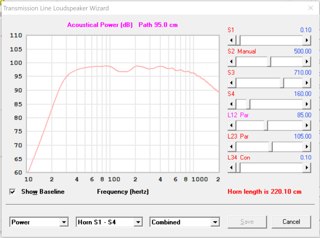

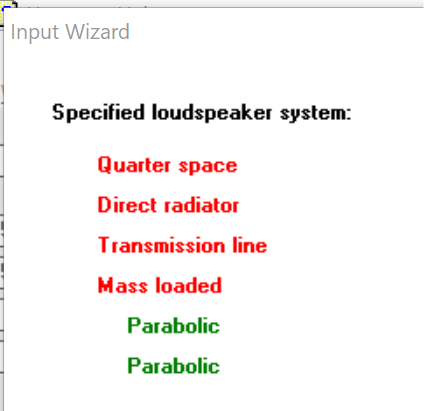

It would appear a mass loaded Voigt pipe is the generally accepted ideal DIY Voigt pipe design. I believe the DDVP-20 qualifies as a ML-VP and I am going to try modelling that in Hornresp with a SB20FRPC30-8.
Given I intend to place the pipes quite close to the front wall, are the below inputs correct?

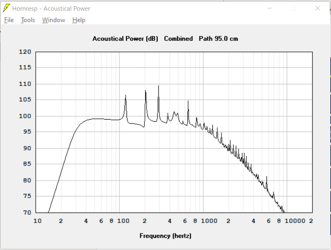

I noticed that the frequency response given by the loudspeaker wizard and the calculated acoustical power differ slightly. In the acoustical power one, there are spikes at around 102, 200 and 300 Hz which are not present in the wizard.
Which graph is closer to reality?
Thank you in advance for any guidance anyone may have for me.
Wizard graph includes filling, calculation does not.Which graph is closer to reality?
In this (and most) case the wizard graph is closer to reality.
