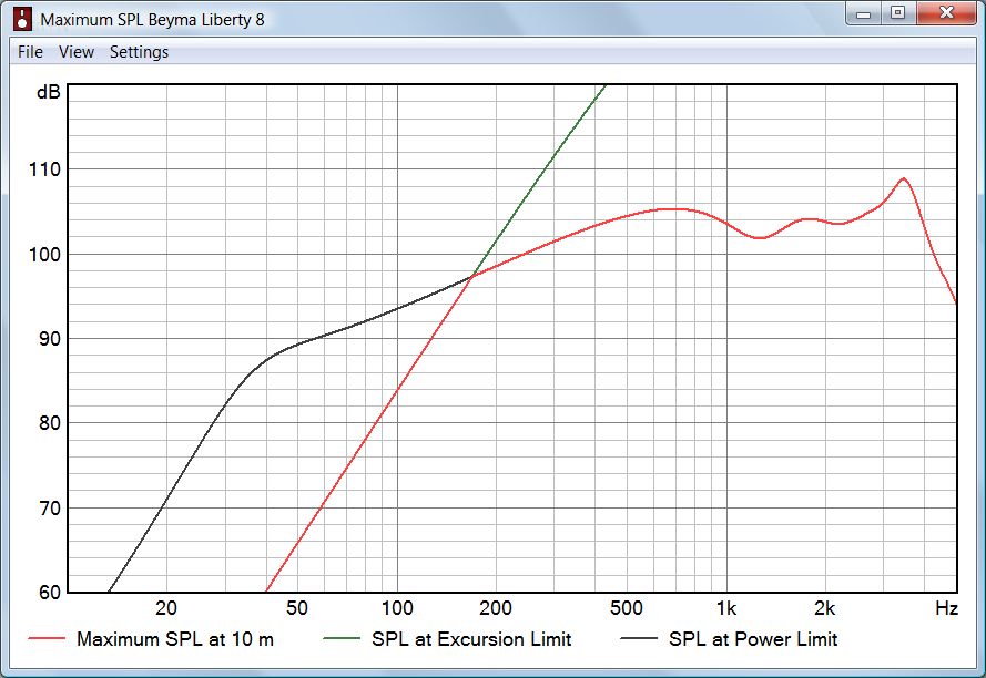

I'm want to use my current 4-way dipole setup to play at some small outdoor parties next summer, maybe only 50 people in a 'chillout' area so don't need to play super loud, but was wanting to have an idea of spl.
After I've build some Lab12 tapped horns the limiting factor is likely to be my mid/bass Beyma Liberty-8 with its small xmax of 2.5mm in OB.

Its in a 44cm wide open baffle. The highest I can highpass it is 180hz due to the cavity resonance of the Peerless XXLS ripoles that'll be playing +/- 100-180hz (with the tapped horns bellow). The ripole and TPL-150H upper mid should play loud enough I'm hoping….maybe 95-100db at 10m from speakers…or is that wishful thinking?
Luckily I can XO 8th order digital and I'll have more than enough power to give it.
Would someone be kind enough to walk me through calculating excursion at 180hz @300W with dipole Eq taken into account? Hoping I don't have to build boxes for these drivers.

Thanks very much! That does kind of rule out OB. I think dipole loss will be 6db/octave from 770hz, so nearly 12db down. I think I'll have to build sealed boxes, and or get some of the more robust 12p80nds….
No. I have to clarify, the simulation already includes the full OB baffle step, you don't have to subtract an additional dipole loss! It's WYSIWYG (what you see is what you get). 🙂
Obviously Xmax limits the maximum SPL below 160 Hz, but the Beyma is capable to produce 97 dB at 160 Hz/10 m in the simulated baffle. If the actual baffle is higher than 44 cm, you will even gain 1-2 dB.
Attached: Simulation at 1 m
