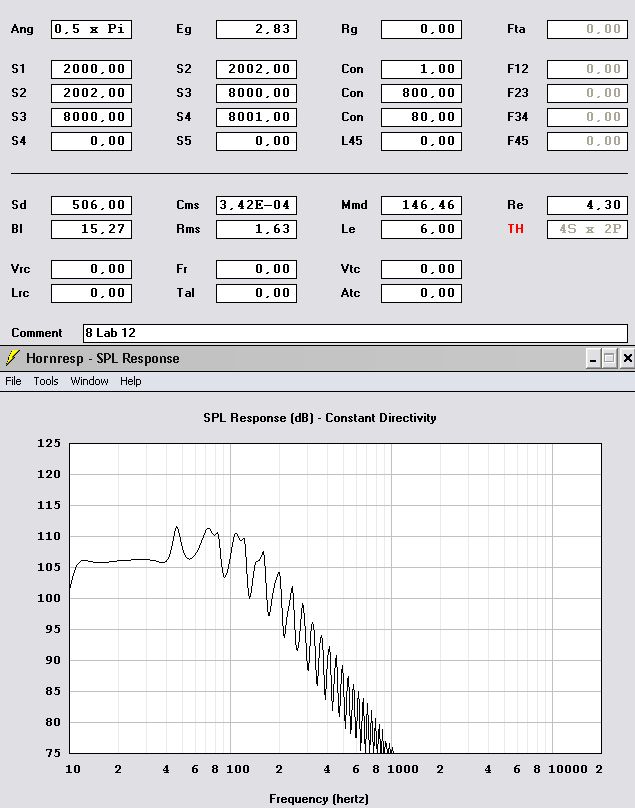

This might not accurately reflect your situation but it gives a starting point for an example, since the point of this is not to provide a blueprint but to show how to start making one. First off, I think it's useful to understand how our hearing works. Below is a picture of the fletcher-munson curves. No need to study it too hard, just understand that it takes a lot more spl for very low frequencies to be audible at all, while we are extremely sensitive to midrange frequencies.
The reason I show this is to explain the first of my many reasons for choosing 10 - 30 hz as a desirable working frequency. The above chart clearly shows that any number of higher frequency issues can be painfully audible. Harmonics can be a huge problem, but even if those are eliminated the mechanical noise generated by the operation of the driver and the box can be clearly audible when blasting a 10 hz tone, since the tone will be largely inaudible but mechanical distortions and noise will not. This is why a bandpass is a good idea. Driver mechanical noises are stuck in the box. If the box itself is extensively braced internally, it won't make much noise either. For best effect, these types of distortion must be eliminated or else the box(es) will be very audible and distracting when it's not supposed to be.
Any higher frequency issues are going to be made worse by the room itself. A room with hard reflective surfaces and no absorbtive properties will make a big mess of the frequency response above the room's lowest mode. This mode will likely fall between 20 and 30 hz in a large room, as indicated by the red lines in the graph below. Above this point, response could deviate by +/- 20 db or more, (concrete will produce a stronger modal response than drywall walls and a carpet over wood floor). Below the lowest mode it's debatable what will happen. If your walls are concrete and the room is airtight you might get close to the theoretical max of 12 db boost per octave, but in a large soft walled room with open windows and doors you can't count on any room gain at all.
For the most part, the effects of the room have been largely eliminated since no output over 30 hz is required. The lowest modal peak will be somewhere between 20 - 30 hz, but other than that room modes won't be much concern. Using a higher frequency range could result in a big problem with multiple high amplitude modes as demonstrated by the yellow line in the chart below (just to give an idea of what could happen), and response will be dramatically different in different areas of the room. In an untreated room there's not much you can do about uneven response due to boundary conditions (louder in the corners than the middle of the room) but adding modal contributions would almost guarantee that every person in the room got a significantly different performance based on their location.
Referring to the graph above again, this is not the type of response you will find in any musical/home theatre subwoofer. Usually you will see a rising response (it gets a bit louder as it goes higher). The response in this graph is opposite, it gets louder as it goes lower. The reason for this is because I am not expecting any more than 3 db max room gain below 20 hz, and at the same time I am expecting a fairly large modal peak somewhere directly above 20 hz. In the real world I think this might turn out to be an acceptable compromise, especially since this is a sound effects generator, not a musical sub. If anything, I'd rather design it to be a bit too heavy at 10 hz, since it can be easily tuned by changing the weights in the PR.

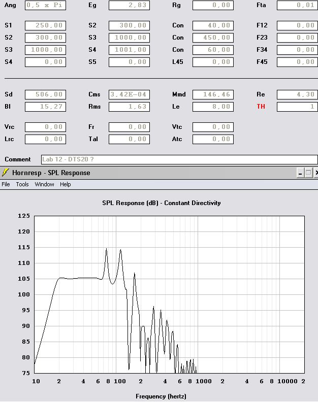

When considering drivers to use at 10 hz, displacement is key. When using boxes to make 10 hz, low qts and low vas = small box, making these parameters a close second (assuming you can use PRs). As Mark mentioned the MaelstromX is a good choice, but the TempestX is also a good choice. Either of these is a logical choice since the PR's I linked to come from the same company, but neither is an available product yet AFAIK (except the tempestx). On the other hand, if you can wait, I think I remember seeing somewhere that both diycable and mach5audio are getting Australian dealers so either one might be a good bet. Mach5audio has no PR's but they do have the IXL 18 which is another good driver for this application.
The graph above is done with winisd, which is about as good as you are going to get for free. The graph shows the response of the IXL18 in a 4th order bandpass. At 15 cubic feet, it shows what I think is a resonable compromise of size vs spl vs frequency response vs power handling. Not too hard for 2 people to carry. 104 db/1m max spl from 10 - 30 hz (although it takes gobs of power to get there - your amp could drive one of these ok but you would need more amps if you make more than 1). Make 4 of these to hit 122 db/1m. This comes close spl goal set forth at the beginning (although output will vary with distance and will be erratic throughout the room) and fits the size requirement as well. This may seem to be a bit of overkill but it's not really, considering the size of the room and the fact that it's not good to run the subs at full power/excursion due to the effects of power/driver compression, port compression, distortion, noise, etc. (I did this 4th order bandpass simply because it's quicker and easier than 6th, and I'd recommend that you start with modelling 4th order first to get a feel for how these work and how winisd works before getting too complex - 6th order boxes are larger but can be significantly louder than 4th order - generally)
The problem with the graph above is that it uses a really large port. Cross sectional area is 64 square inches (it needs to be big due to the massive amounts of air being shifted) and length is over 6 meters (20 feet). Below is a picture that shows very generally (perhaps too simplistically? - and certainly not to scale) how resonant enclosures use ports for tuning purposes and why a PR is a good idea. All 3 of the boxes have the same tuning and the same general size. The first big box has a large internal area, so it does not need a large port to achieve the required tuning. The short port will provide a very smooth response with very very small amplitude peaks very very far apart, far outside the vent's passband - not noticable at all. The second box has a smaller internal volume and therefore needs a much longer port (same cross sectional area) to hit the same tuning. The harmonic peaks will be more severe in amplitude and closer together - but hopefully still well outside the vent's passband. In the third box, there is no actual box, you just attach the driver to one end of a really really long port. This is a transmission line and it needs stuffing to attenuate the many severe peaks in close proximity. In the case of the second box, the port could be replaced with a PR which could effectively reduce the size of the overall box by 50 percent (depending on the inital volume/port size ratio). There's a lot more to quarter wave theory than that, but that's a start.
