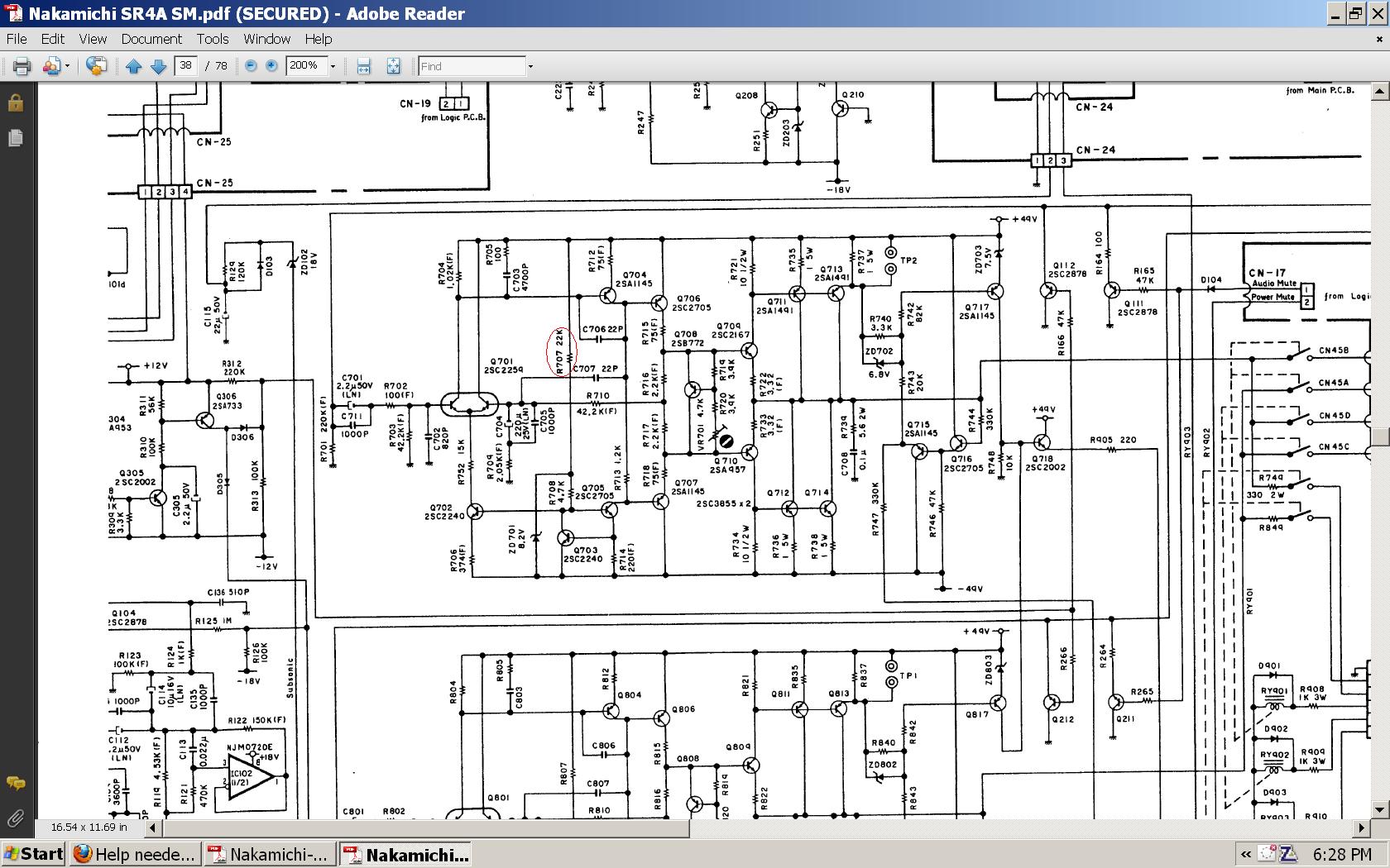

Few days back I've picked up this receiver in non-working state. The receiver will not come out of protection mode. After some investigation I found that output of left channel stuck at -ve Vcc which is -54.3V. I've checked all the transistors in that channel, but did't found anything bad. I've tried to compare the voltages with working channel, but this is next to impossible as the PCB routing for one channel is completely different from another channel. Also the PCB routing is complex and it is not easy to trace back the schematic from the PCB. Can somebody help me in fixing this receiver? I will greatly appreciate if somebody can provide me the service manual or schematic of the power amplifier.
Thanks in advance,

Hi Nageswara,
There is a power resistor that overheats commonly in these. It supplies the reference for the current sources (off the negative rail). Replace both with a higher wattage.
Now that is the common fault (wish I had the manual still to pin point it). There may be other faults as well.
-Chris

Hi Chris,
Thanks for responding. It looks to me that there are couple of current sources in this amp, if you can hint me about which one, I can look at that one. Also the components are crammed and accessing them is very time consuming. If you remember the value of the resistor, please tell me this also helps alot.

Hi Nageswara,
Yeah, it's no fun working under the tuner PCB. I no longer have access to my service manuals or I'd give you all that information.
I think it was a 22K 1/2 W. Use a 1 watt metal oxide resistor to replace it with. There is one ccs per channel supplying the diff pair. That's the feed resistor.

Hi Chris,
Thanks a bunch!!! Hats off to your memory. The 22k resistor is indeed the problem. Once I replaced with 22K, 1W the amp worked like a charm. I've replaced the resistor in the other channel with 1Watt one. The receiver sounds great, it has punch and very good highs too. It has lot of detail some time it gives an impression that the highs were artificially boosted, and its sound is almost as sweet as my Luxman R-1120 receiver.

I documented my repair (1/2 watt 22K Resistors R309L and R309R replaced with 2 watt equivalents) with a lot of photos. If anyone's interested, I'll be glad to post. I bought the service manual PDF online, so anybody, feel free to ask questions.
The TA-3A comes apart easily enough ... no tricky hidden screws or clips ... it was easy to pull the top boards to get at the main PCB ... easy to remove the bottom too.
