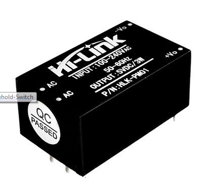

I am also in the need of a similar charger for my project that runs on +-7,4V from two small 2S 300mAh batteries. This system is a very low noise pre amplifier and the batteries will be installed together with the electronics inside a triple shielded mu-metal/copper enclosure The charger must also be permanently installed in the device (in the outermost enclosure) so that the user just have to plug in a power source to recharge the batteries when needed. The charging must be totally automatic.
I want to charge the batteries with a current of 300mA. It would be nice if I could just buy the charger, but I cannot find any ready made product that does this. The only product I have found requires the user to input charging current through push-buttons / menues etc.
The plan so far is to build a charger around the TP4056 chip. I just bought 20 pcs. on ebay. The plan is to make a circuit with these to charge all four cells simultaneous with one chip per cell. The obvious problem is that the "ground" potential changes for cell 2, 3 and 4 and current will flow somewhat odd through the system. I haven't offered this much thought yet bur it must be possible somehow. Is there a solution for this out there?

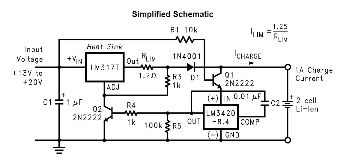

there are a few li-ion charger chips out there. the main danger is charging cells that are too far discharged. if you charge them at high rata they may explode.
li-ion cells need a protection circuit to avoid the deep discharge. charging in series needs a balancing circuit. or you need to charge each cell individually..

An lm317 can be used for a CCS, another lm317 can be used for voltage regulator...............
ConstantCurrentConstantVoltage charger can be made by cascading a current limiter and a voltage regulator (preferably LowDropOut type). ...............
These two lm317 in cascade (CCS first) make a very simple constant current/constant voltage charger. And Very cheap to experiment with.
This works very well for lead acid and NiCad. It seems to work well for Nimh.
I cannot recommend this style of charger for Lithium batteries.

I found a simple way to do this for my project
TP4056 5V Micro USB 1A Lithium Battery Charging Board
HLK-PM01 AC-DC 220V to 5V Step-Down Power Supply Module
With four of each I can charge the two batteries automatically by connecting to the mains. Total price about 14 USD.
I just have to change one resistor on the small boards to 4k to achieve 300mA charging current.
The TP4056 draws only 2.5uA from the batteries so it can always be connected.
Why?
For NiMH the recommended charging method is quite complicated, much different from CC-CV:
https://na.industrial.panasonic.com...nloads/files/panasonic_nimh_chargemethods.pdf
But anywhere you look, CC-CV is the recommended charging method for Li-Ion:
https://www.google.hu/search?q=li-i...4u5zLAhWjApoKHbmOA7cQ_AUIBigB&dpr=0.9#imgrc=_

Wrong. It is not a charger, it is a protection circuit.
It doesn't provide constant charging current, it only switches off if current is dangerously high.
It doesn't provide constant charging voltage, it only switches off if voltage is dangerously high. (4.35 V)
It is for 4s configuration only.
It is for a specific capacity/type.
Completely incapable for the intended usage in this topic.
Agreed, it is not a complete charger the user still has to provide a current limiter and voltage regulation.
However, with the circuit described by bwolf in post 36 before this board it will provide a big improvement for a system that needs the batteries permanently connected. (I don't know if this is the case for bwolf)
