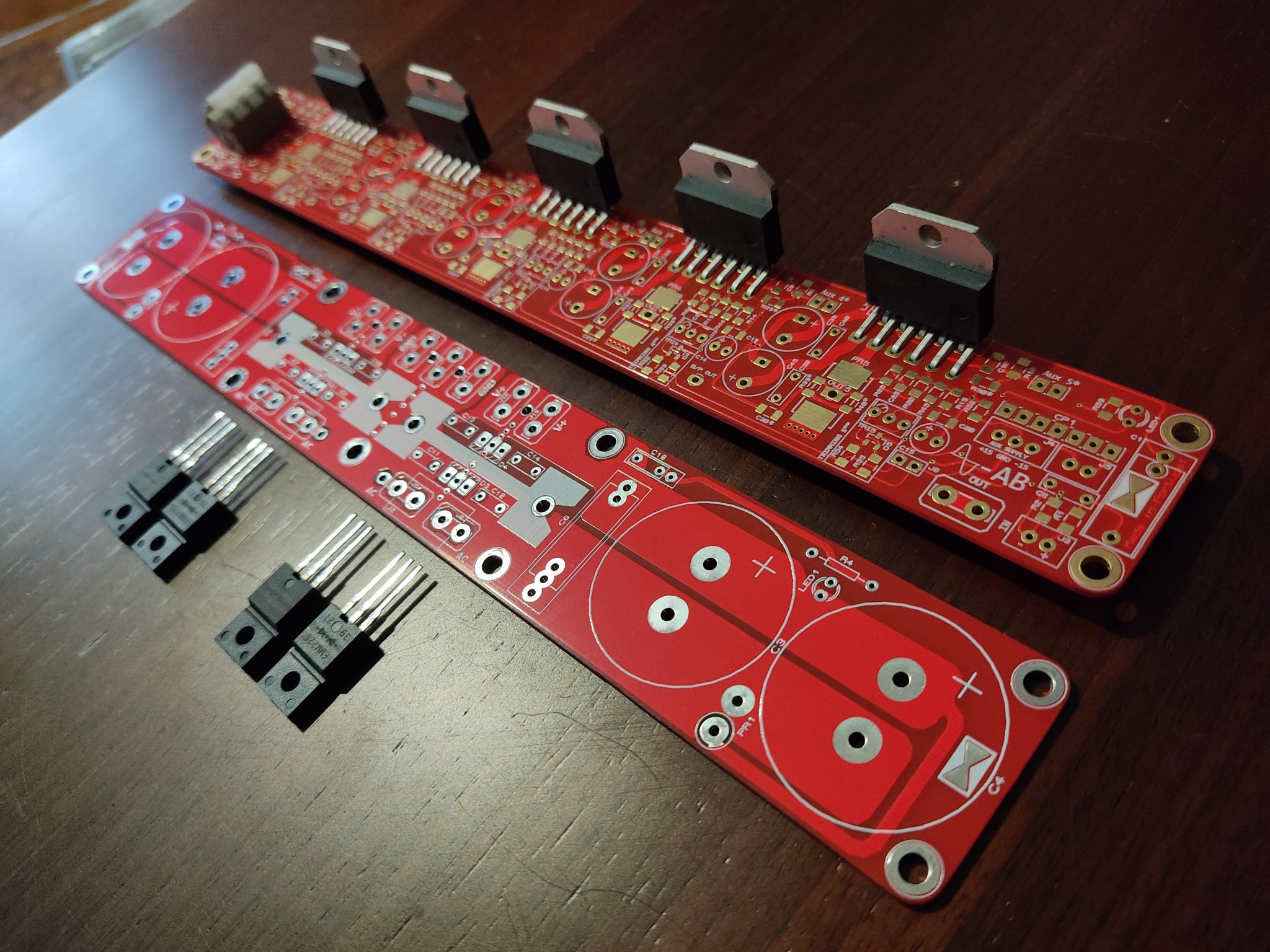

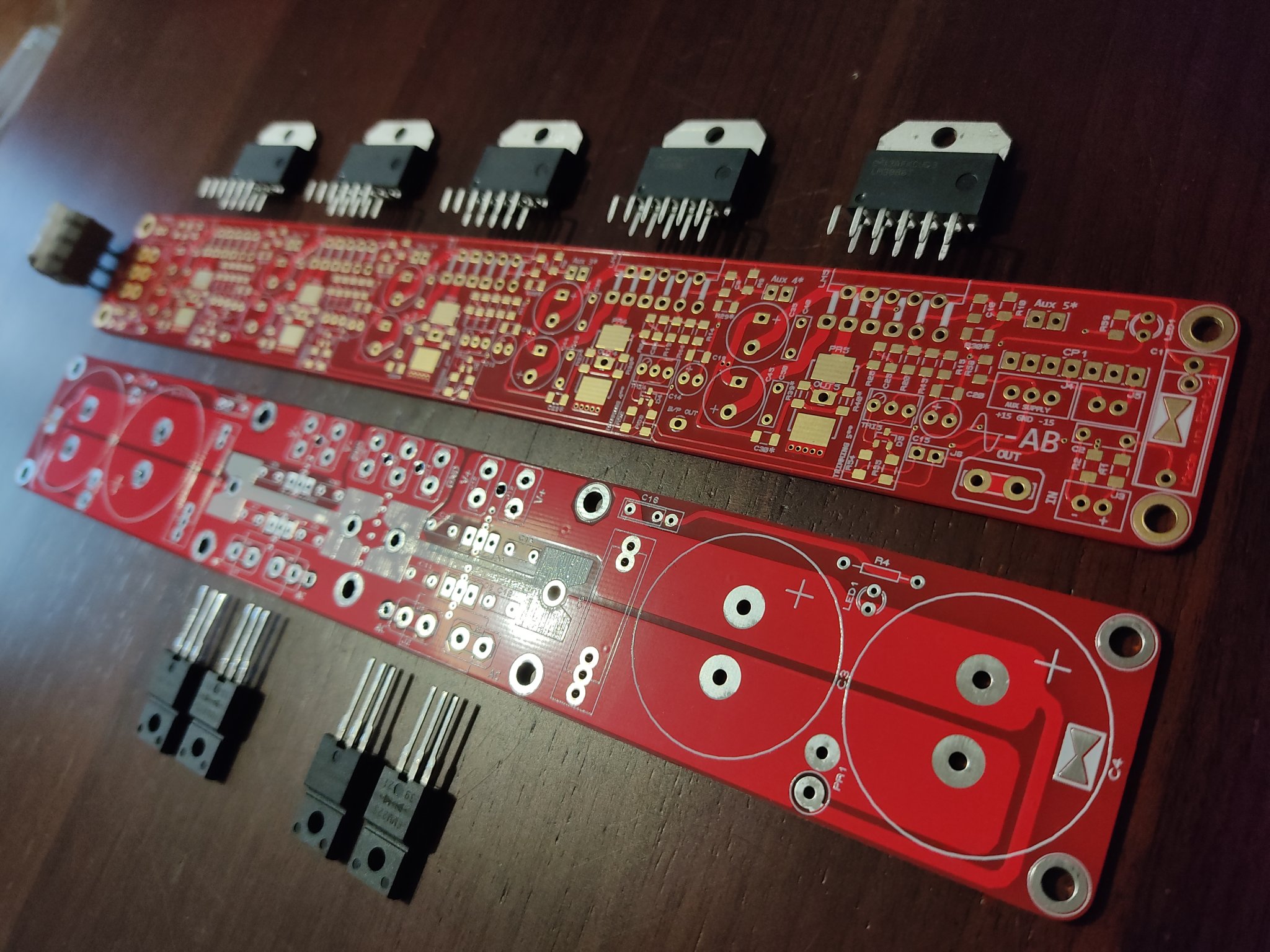

I have develop very recently this PCB which use 5 LM3886 they can be installed in the PCB all in gainclone/parallel,fully independent channel's or mixed
configuration, and I want to develop a simetric regulator which can power this, so in terms of amps my target is 20A.
About the circuit for the regulator I am thinking of using power op amps as current source biasing some zeners which will set
the voltage on the output, after the zeners I will use a driver and then two devices in parallel for the output section, I am thinking
of using TIP35/36 but would like to ear some suggestions.
Regarding output overcurrent I am thinking of standart VI limiter but I would like to add also a protection, for creating a safe operation area, this by trip the
circuit if the differential voltage between in/out be greater than 7 volts this for temperature don't rise to fast, but this might bring some problems, for
now I would like to if operating an LM3886 and then remove one side of the supply does it burn/short or no problem of removing one side of the supply?

Five LM3886 would be able to draw 55 A total, assuming you get the 'typical' data sheet performance. 35 A if you get the worst case performance. Good luck designing a regulator that can deliver that.
You then want to add a current limiter? I hope for you that it'll be of the fold-back type or at least have some clever circuitry in there to limit the power dissipation in the regulator during the over-current condition, because if not you're looking at dissipating around 2 kW in the regulator. Those transistors will go POOF in a hurry.

Considering that if for example we have some big speakers with low impedance of 2 Ohm and the voltage after the regulator being 40V I conclude that the peak current would be 20A AC leadind to DC current of 14,18 amps on the regulator,in meantime I would like to mention that this would represent 397 watt RMS so power levels that probably no one would listen in Home.
By having an input voltage of 45V on the input of the regulator I conclude a total wasted energy per rail of 70watts, TIP35/36 do have a collector power dissipation of 125 watt on max that is the reason I thought on 2 devices, "what do you think Mark?" with this data.
I do pretend to install a circuit that activate a protection if the differential voltage between IN/OUT be greater than 7 volts does someone can advise something to implement this? Does anyone know if one of voltage rails being removed from an LM3886 in operation, burn or get damaged or in other kind of class AB amplifier?
