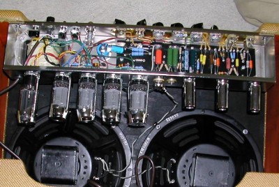

I built a nuber of Fender Twin clones and I did not want to make a harsh sounding amp. I got the power tranny from AES so I ended up at 354V+. Then the output stage was quiet and sweet.
See pic. This is one of the Twins. Four 5881's in Class-A =50 watts. I could also run 6V6s and get a "Double Deluxe" amp.
4K primary and tons of bass..
I use Metal-oxide 5W resistors as they are non-inductive. I use a 30 ohm from each Kathode to the main resistor.
So two 30 ohm M-Os and one 440 ohm = 470 ohm.
At this resistance it should be a 12. watt amp at 8K to 10K primary?
