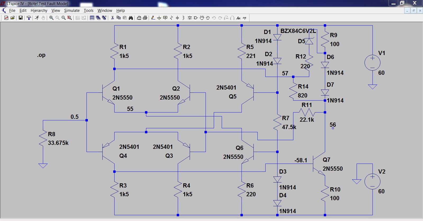

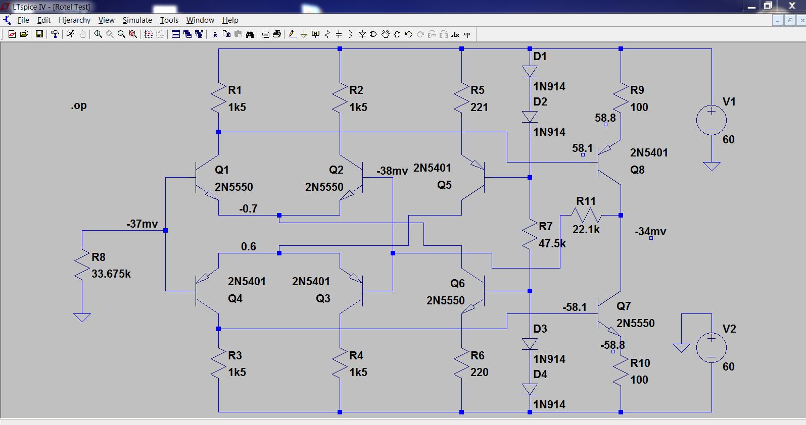

Have a look at this Ltspice simulation. I wanted to prove to myself that this all worked (which it does) doing what I have been outlining. I have marked the voltages on the circuit.
Here are the DC voltages with Q617 shorted. You'll see the voltage at this point settles to near zero as expected. I also open circuited Q613 base and the voltage at Q617 was still near zero. So we are still looking at Q613 :)
Here's the file if you want to try it :)

Is it possible to simulate leakage of Q8 by placing a highish resistor between C and E?
For ordinary leakage I would say yes. I'm just thinking if say the real transistor broke down at high volts or started "zenering" or some combination of inter junction leakage etc then the simulation might not compare to the actual real world faulty device.
Try it... the file should be good to go and modify :)

This is where Ltspice falls down. Look at the B-E volts on Q1. That could not happen in the real world and so it throws the whole simulation to pieces. I tried to imagine what a failed Q613 might resemble.
